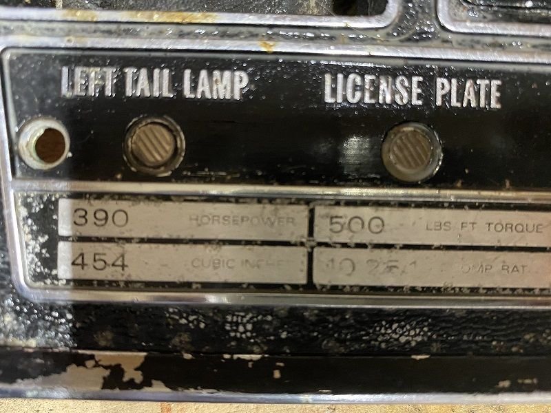

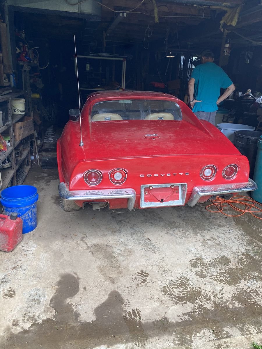

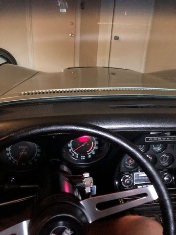

I recently acquired a very clean 1970 Corvette that had set in a garage since 1988. I am going to do a build thread soon and show pics of us pulling it from the garage, but had a couple questions in the mean time. The car is supposed to be a 454, 4spd car but the original engine apparently blew up back in the early 80s and was replaced with a 66 427. I'm looking for a way to verify its an LS5 car though. The hood was replaced at some point with a long 73 hood most likely due to the wiper door not working. I dropped the tank today and the build sheet is there, but its basically unreadable. The only thing I can go by is the plate by the shifter appears original and is a 454, 390hp, 500tq car. Is there any other way to verifiy the car without the build sheet at this point? Any help is greatly appreciated. Here's a pic when we pulled it from the garage and the console plate.

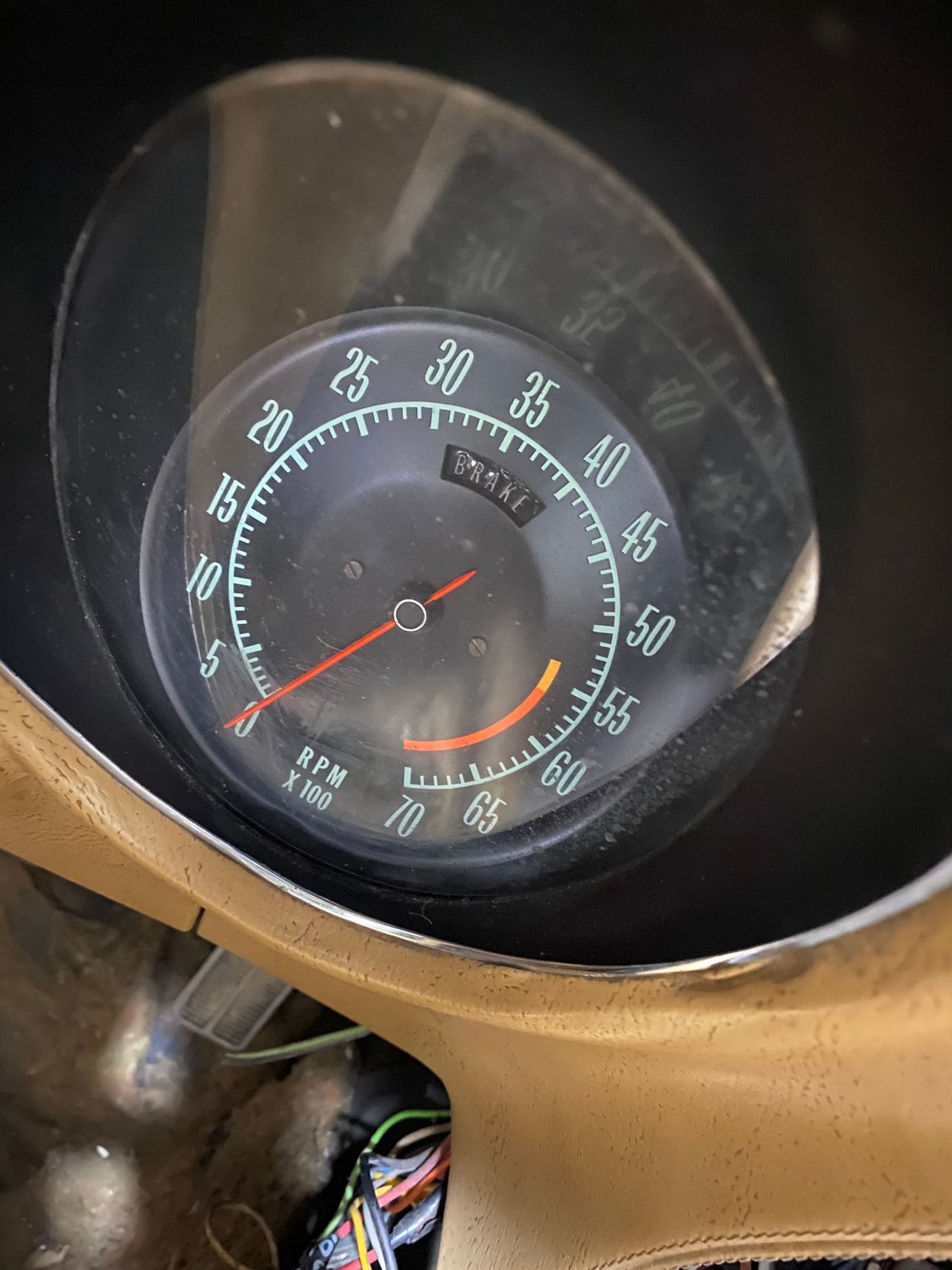

One way to continue to determine is that the tachometer would match this one as far as redline goes.

Thats a great idea. What does your tach go to sir? I cant see it very well in the picture and i can verify that way also.

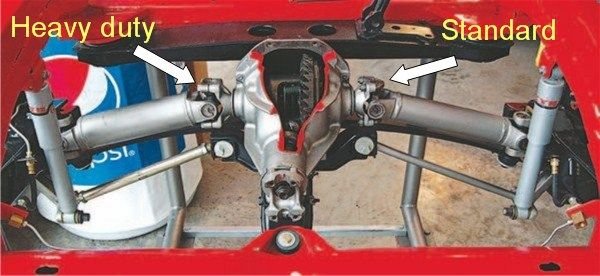

It should have a rear sway bar if originally a 454. The caps for the half shafts are different from small block to BBC. Also the rear end codes are specific for a 454:
CAT 3.08 Heavy Duty Positraction (454)
CAU 3.36 Heavy Duty Positraction (454)
CAV 3.08 Standard (454)
CAW 3.08 Standard (454)
CAX 3.36 Heavy Duty Positraction (454)
CAY 2.73 Positraction (454 Turbo-Hydra-Matic)
CAZ 3.55 Heavy Duty Positraction (454)
CFA 3.70 Positraction (454)
CFB 4.11 Heavy Duty Positraction (454)
CFC 4.56 Heavy Duty Positraction (454)
CLR 3.36 Standard (454)

Big block car would have the heavy duty differential yolk caps.
and a larger front swaybar (15/16" I believe). F41 optional suspension also used the same sway bar (I believe) so not definitive but a clue nonetheless.

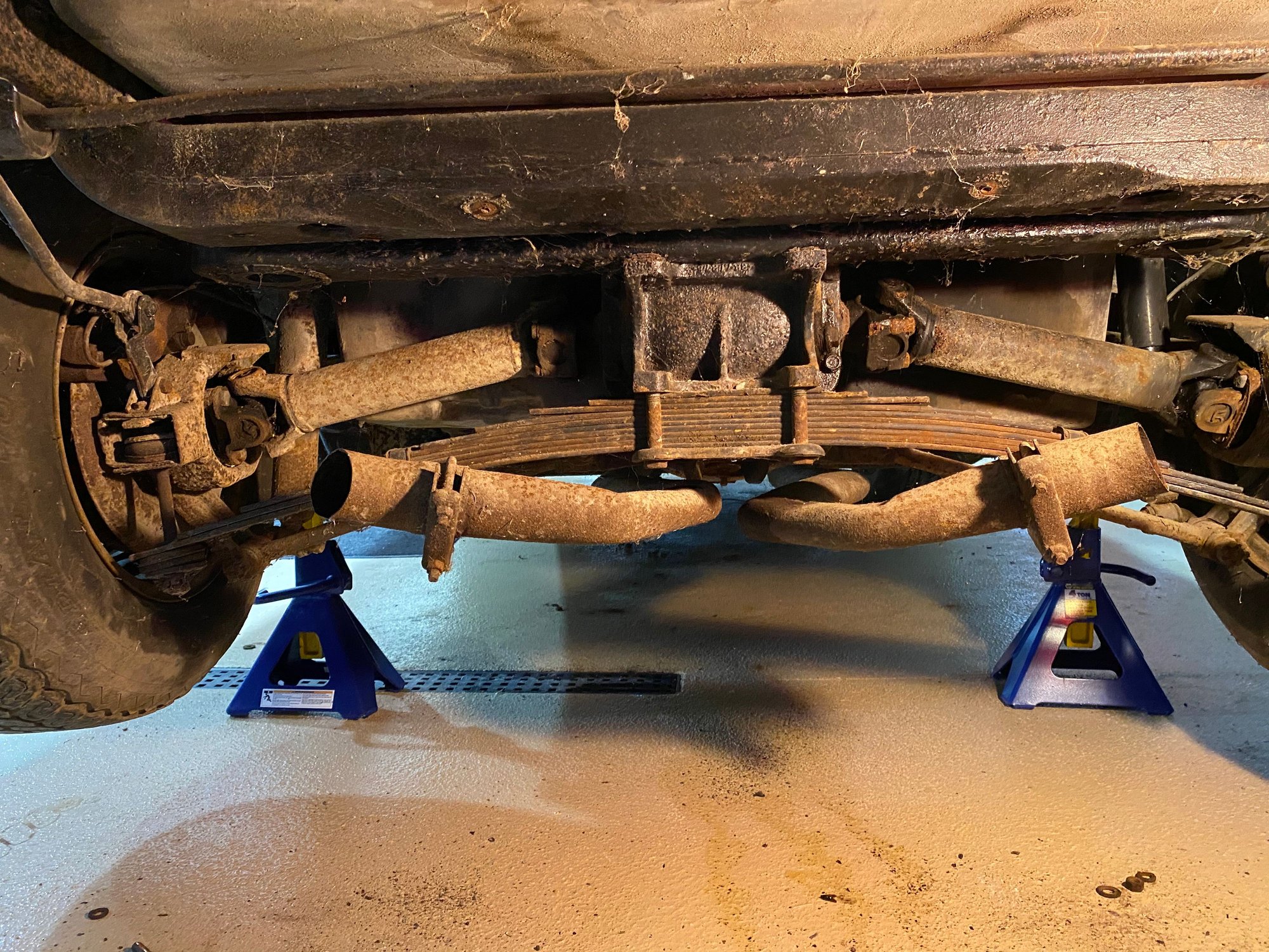

Perfect responses so thank you guys! Tach, half shaft caps and rear sway bar all match up. I’ll post up in the LS5 section for more details. I’m excited for to keep digging and hoping to find another build sheet somewhere. I had to cut the welded exhaust off to get the tank out also.

Is Red the original color?

Yep was resprayed once but to the original color. This was after a quick bath. Like I said it’s a shame it has a 73 hood.

454 engine plate on the console,
