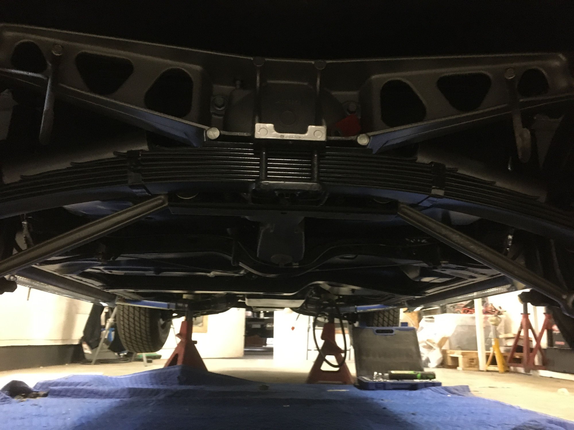

looking at the one piece rear spring which one do i chose for my 82 . also looking for shock which ones are good . going to lower the the vette around 1. 1/2 " . thanks kev

thanks for the reply . bought the car 7 months ago in parts it as a steel multi leaf at the moment shocks have been painted so dont know

the leaf spring i have is 9 leaf so going for a single leaf going with the 360 rate spring and the b8 sports shocks . which make of single leaf spring should i go for . i have seen ridetech $550 are they better than others i also want front lowering springs and can only find ridetech ones . cheers kev

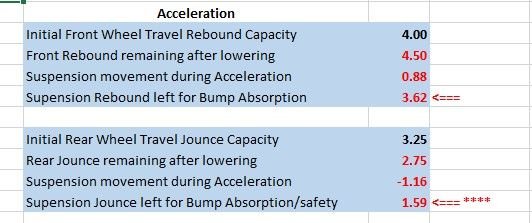

Ummmm. The C3 rear suspension does not take kindly to being lowered very much. Not with springs anyway. You want the half-shafts to stay almost level. In a completely stock car you only have about 3.25" of bump travel before the T/A arm hits the bumps stops. Then very quickly the u-joints bottom out. Stock BBC with stock soft springs could do it with just the throttle.
Play with this spreadsheet I wrote. Change your ride height and watch watch happens to your bump or jounce travel under the "acceleration" tab. You can lower it some with 16" wheels and some by raising the diff mounting. Then you only have to lower lower it by spring a little bit. And you will still need a stiffer rear spring to keep it off the bumps stops!
This example is with the car lowered 1/2" and with a 360lb rear spring, and a BBC. It leaves a little extra for road bumps, but not much.The stock 198lb spring leaves almost nothing if lowered, or 2 people on board.
