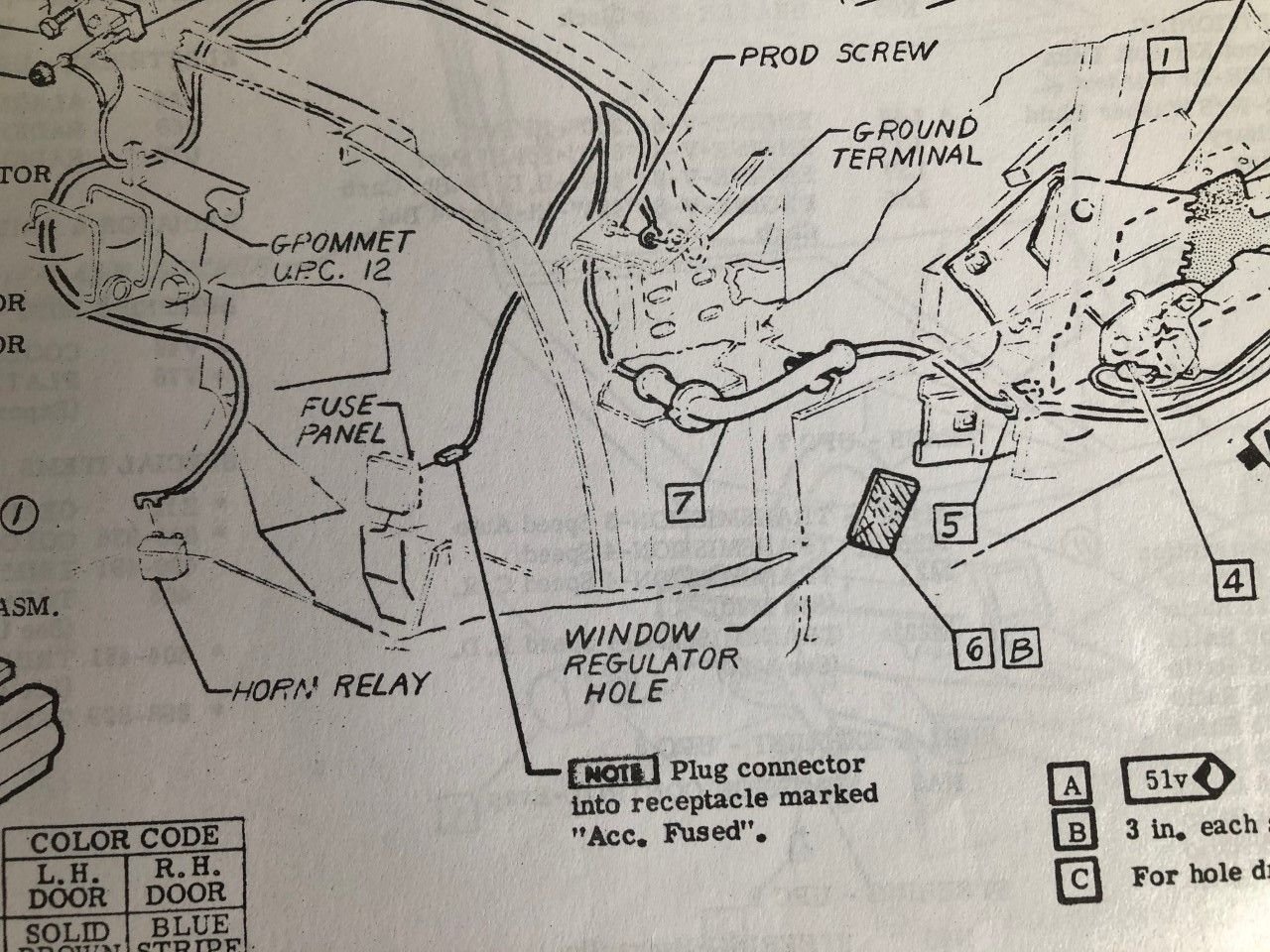

Thanks for the response 7T2vette... I'll let guys decide where it should be connected at the fuse box... I know a couple have said IGN, but I have connected it to the ACC location... I'm basing this off of the 1970 assembly manual (see the Note at the bottom of the page). It says to connect it to "Acc. Fused"... so as it stands, I have it connected to the ACC location, and all is working ok.

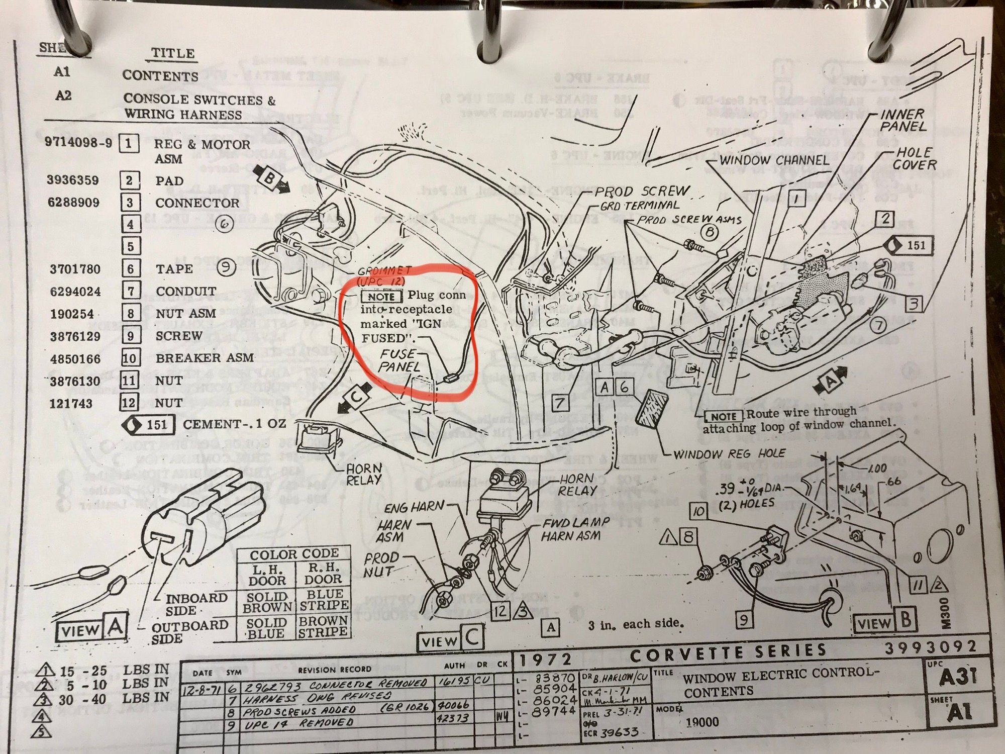

Interesting. My car is a 72 and in my copy of the AIM and also on the schematic I have hanging on the wall my garage, both show the relay connection going to the IGN terminal on the fuse panel. I guess they must’ve change things along the way!
