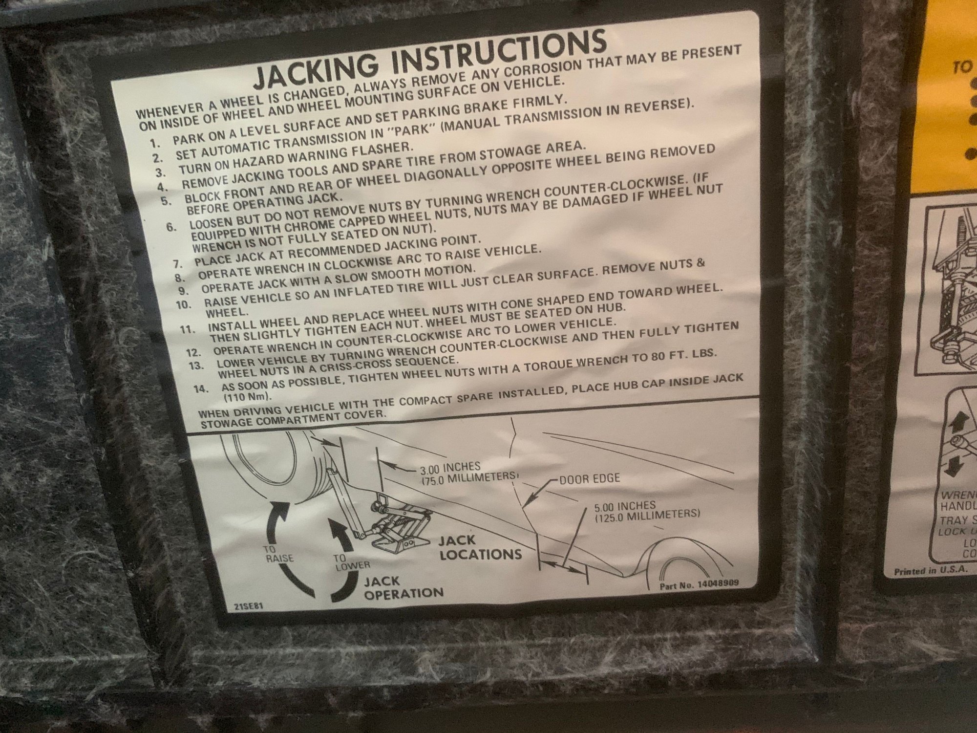

I took a picture of the “Jacking Instructions” sticker on the inside of the door of the storage compartment of my 82 and attached it to this message for your reading enjoyment. I am not sure if different years have different techniques.
I agree with Lachymac1 and not twisting the frame by jacking from one point only. I use two jacks on the same side simultaneously in the GM specified locations.
No mention of loosening the t-tops on this label, however.
Those jacking instructions are used for changing a tire, typically when out and about and or getting flat. During those situations it is common to jack up the car where you need to change the tire. For jacking up the car to put on jack stands, which you also have to be very careful about where they are placed and what quality are the jack stands, I do the two jacks on the side method. There is a plate now for the front cross member that allows you to jack up the car front end from a single spot and it works great, I developed it for just that purpose. The front cross member is far too thin to jack up the car with the engine and transmission in place but the addition of support up front makes it a breeze. Just be safe with your jack placement and slide a tire under the car in case the jacks fail or the car shifts. Be safe.
