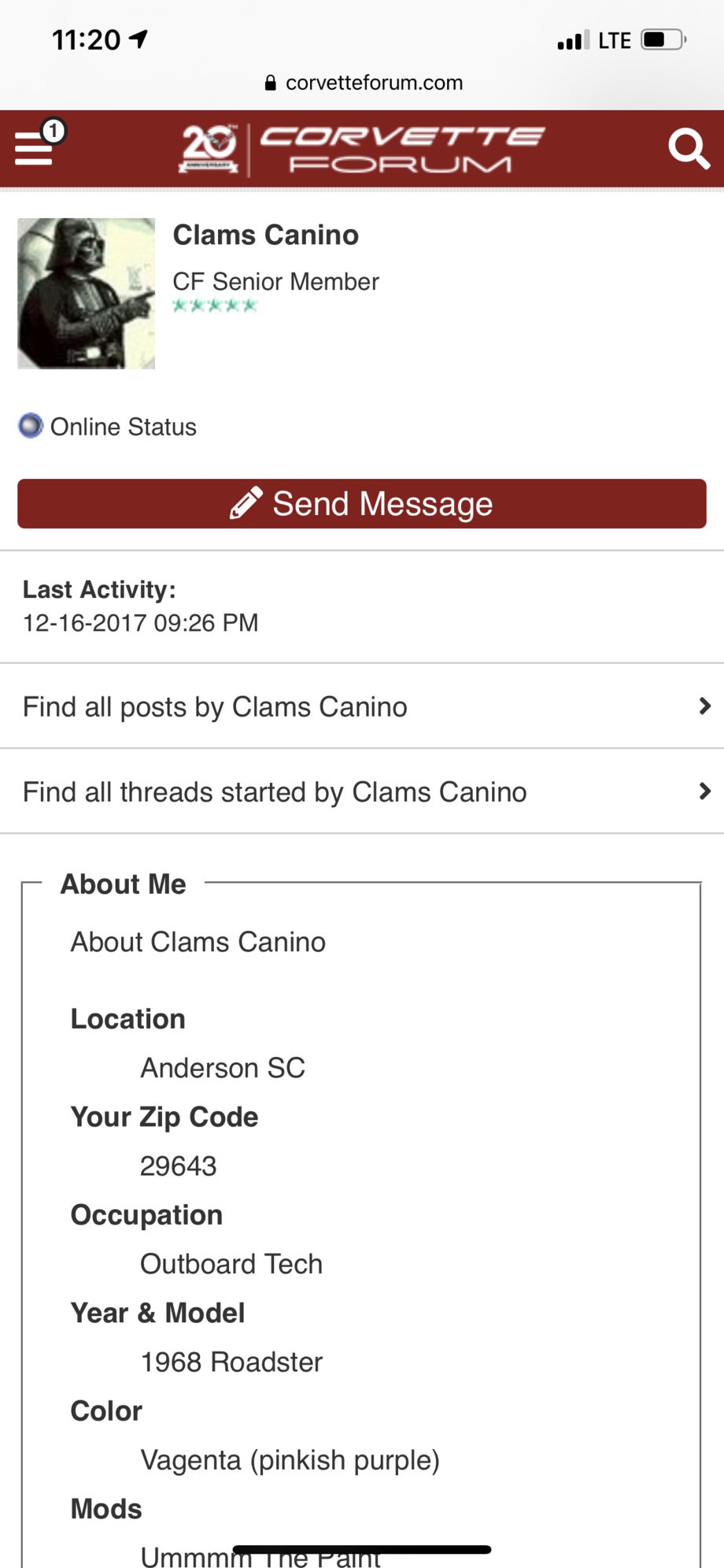

My dad 😢 and some of the car history

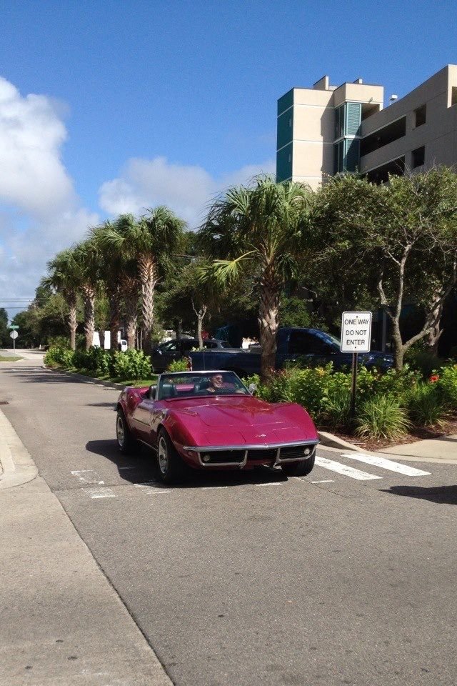

My favorite picture of him and the car. 😍
