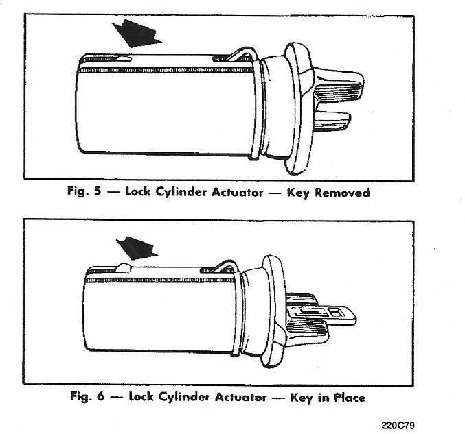

That constant buzzer was hard to figure out. The culprit is made of plastic with thin copper reeds. With the key in, it makes the reeds to touch and the buzzer to sound. The plastic breaks with age and the contacts touch with or without the key buzzing constant.

read this: p.9 top paragraph. Make your own tool to remove the buzzer.

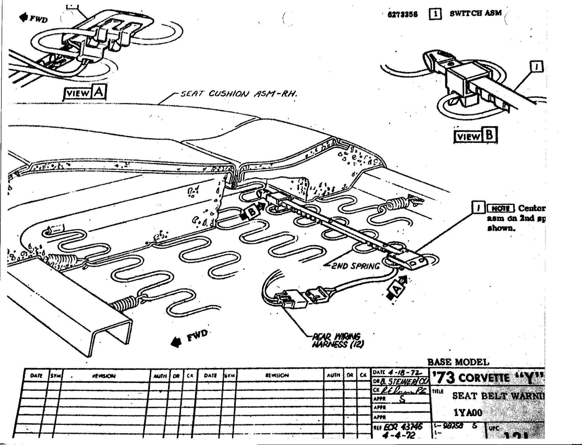

If i can fix that, the only other issue i have is the seat belt system. It looks like all the connections are there, but seat belt warning light does not go on and i am not sure if the buckles con nections are working.
Thanks
Vinnie

Default Something else to check
The seat buckle switch is normally closed (passes 12 volts) when not buckled.
The seat bottom switch is normally open (12 volts pass only when someone is in the seat).
