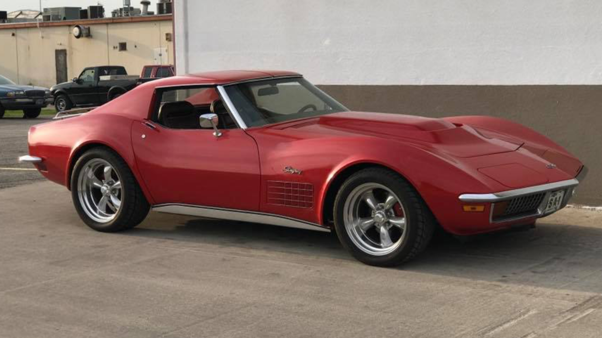

I like the Rocket Racing Wheels Attack Hyper Shot.

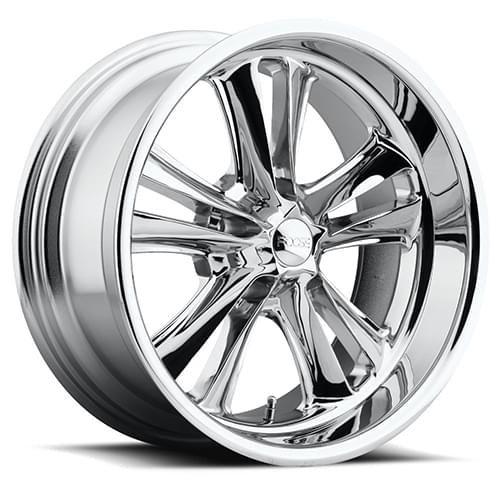

I like these. 17 x 7, $286 Summit Racing
https://www.google.com/aclk?sa=l&ai=...gQIHhBY&adurl=
Foose Knuckle F097

Very nice looking wheels. Problem would most likely be finding them in the proper size, along with the proper backspacing and caliper clearance, for a C-3....

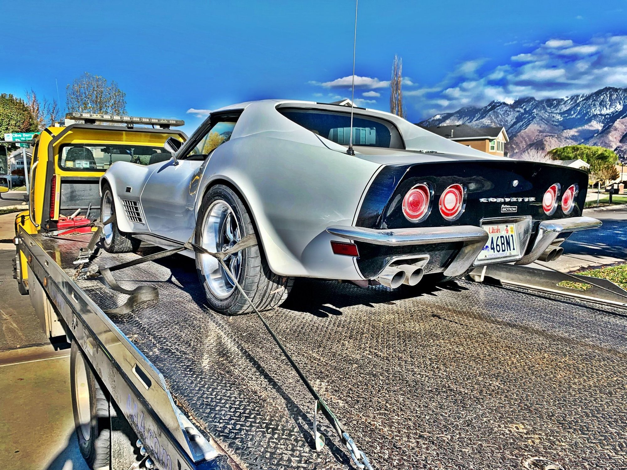

Hey Jim, are you squared up on those wheels? The front seem to have a smaller lip. Might be a optical illusion. I’m trying to find a set of wheels to square up. This is what I’ve currently got.
Everyone thinks I’m crazy for wanting a different set of wheels, but man I just really want that squared up look.
also did you have to do any modifications to get them to fit other than offset trailing arms?
Hey Mike
They are square with 285/35s. It must be the angle. I had to remove the factory rear sway bar. They clear the factory trailing arm with the parking brake cable relocated also.
And I don't think you're crazy for going with squared Wheels.
