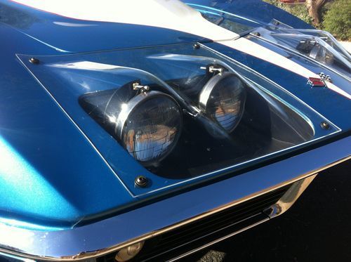

FAI headlights or glass in popups a must for weight reduction!

Originally Posted by Dynra Rockets
What is your goal weight?
My 69 is in the neighborhood of 2950# with full, and working, interior. If I gutted the interior, lost the soft top, and used racing seats I'm sure I could get another 100+ pounds off, but not willing to do that.
I'm not going to lay my cards out just yet. I also should really wait until i see what i have to work with. Remember, i haven't bought the car yet. Lets just say my cunning plan... is ambitious...
I have yet to see a non-vacuum/aftermarket/racing headlight treatment that i'm crazy about, but thats research i haven't done yet. WAY too soon. Whatever i do will look stock though, even if it isn't. I'd go all-out Mad Max with a Corvette if i could... but i have a girl who is going to have to like driving in it... a LOT... and i plan many long road trips. It cant be a clapped-out mess. Just... simple. It'll have a heater, and a lightweight stereo (for parking... it'll have 3" X-piped Spintechs for driving music...), thats it for options.
