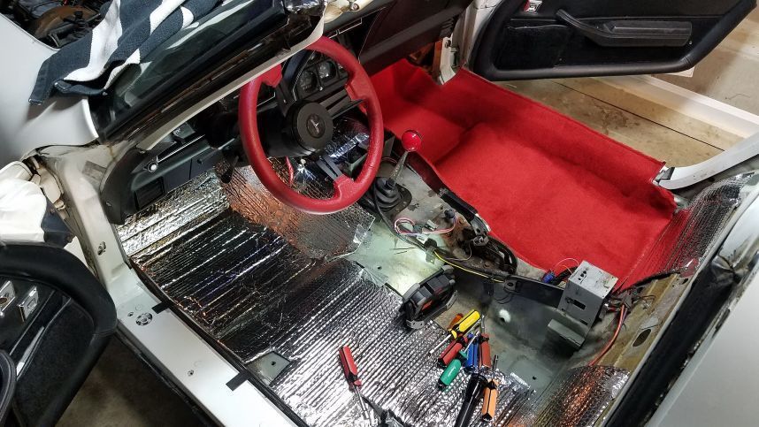

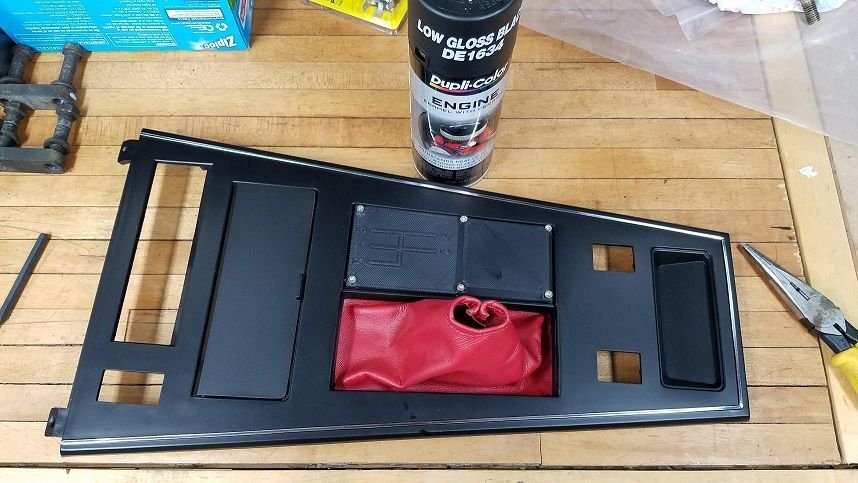

Old Oct 18, 2020 | 10:26 AM
Bikespace's Avatar
Bikespace
Joined: Mar 2017
Posts: 11,906
Likes: 4,479
Here are photos of when I did this.
Side view with the carpeted trim removed. Bottom view showing the metal ring that secured the black leather shift boot. And the new red shift boot (with a 3D printed magnetic cell phone holder/shift plate). You can't really see the 4 screws, but they are installed.

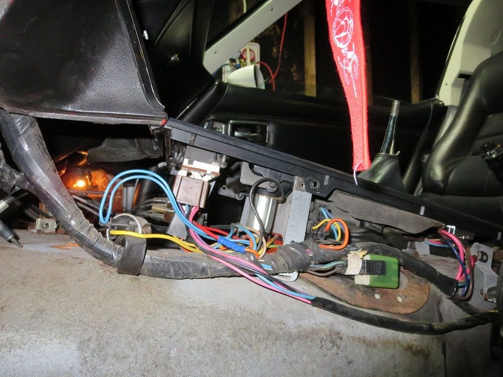

pigfarmer's Avatar
pigfarmer
Joined: Sep 2016
Posts: 933
Likes: 427
From: Dutchess county New York
Originally Posted by TRT SR
Actually, trying to find the bolts under the car, seems like the converter shield is in the way? My seats dont have bolts inside, and they don't spin when loosing them under the car
Was just cruising through the forum, saw this and glanced across the room at the shift plate and boot I just did that is hanging as wall art right now.
Dunno about an 81 but it sounds an awful lot like my 69. My boot has what feels like a metal strip in it. It sits on the plate like a cup and those 4 screws go through that metal strip and secure it to the plate. You might be able to just lift the console plate enough to do it. Maybe this helps
