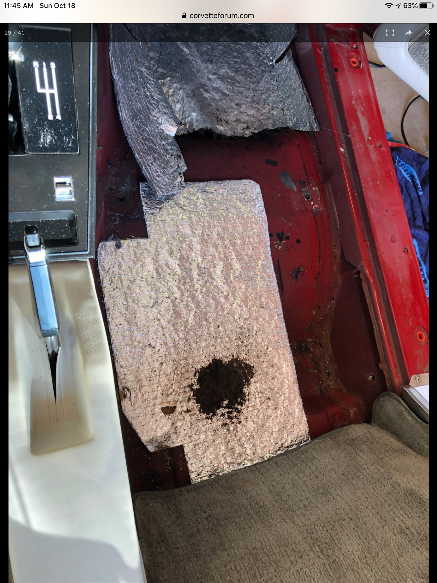

I reused mine..especially over cat area
why not..
i used pieces to kill vibration and sound and specific heat areas..
After with repaired aluminum foil
Before, that cat gets hot..only 29000 miles 42 years..maybe a lot of idling

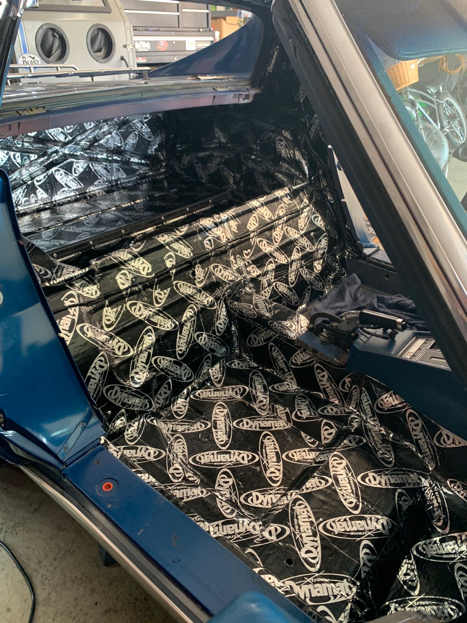

Spent the better part of two weeks installing Dynamat and insulation on the entire front and rear floor boards. Used Dynamat extreme to start with and then overlaid it with Reflectix purchased from Lowe's. Not hard work, but very time consuming to say the least. Trimming the carpet for the rear wheel humps was a complete PIA but as you move forward, it becomes easier and easier. Below are some inspiration photos for you to help you see the end result! Good luck with getting yours completed!
