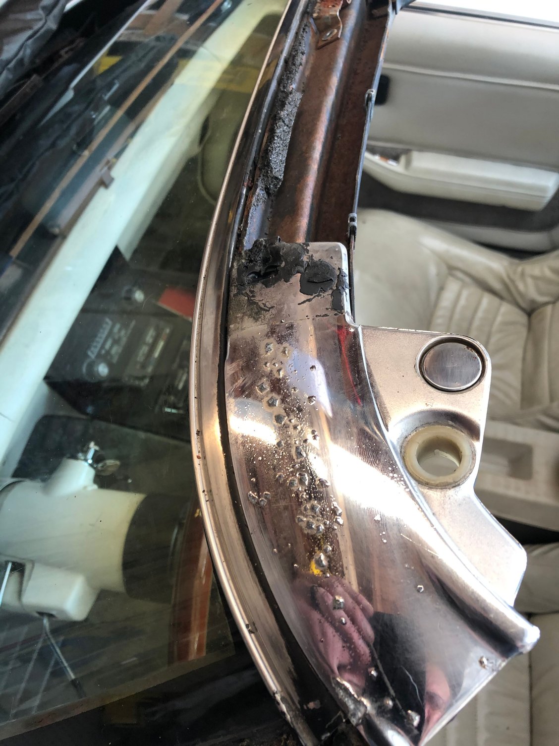

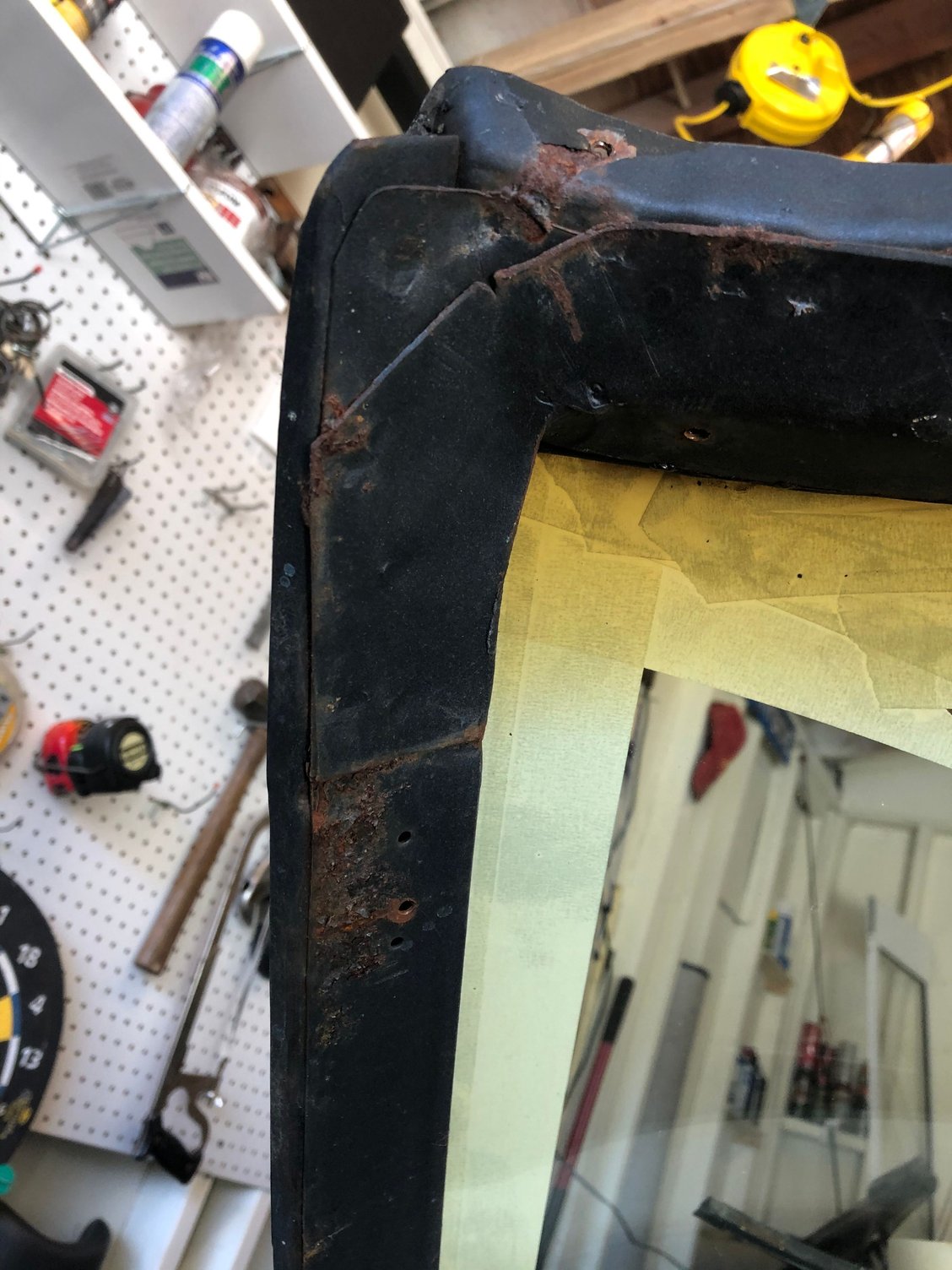

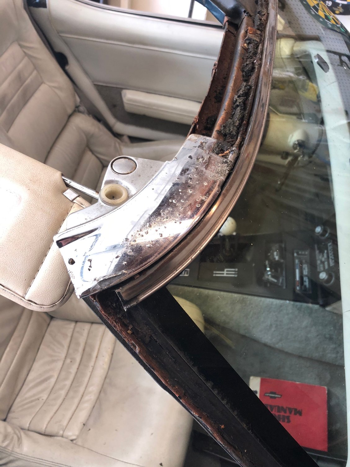

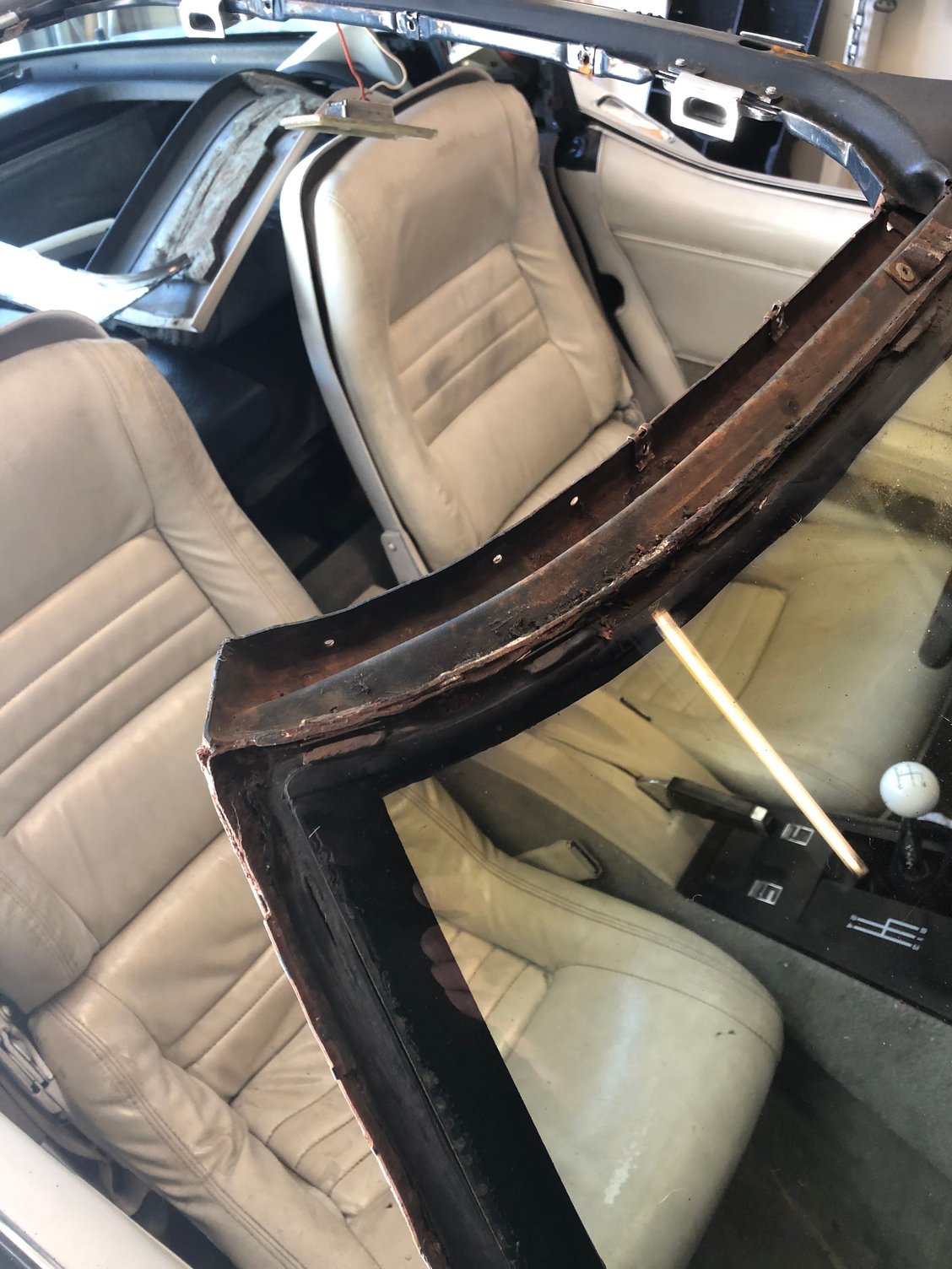

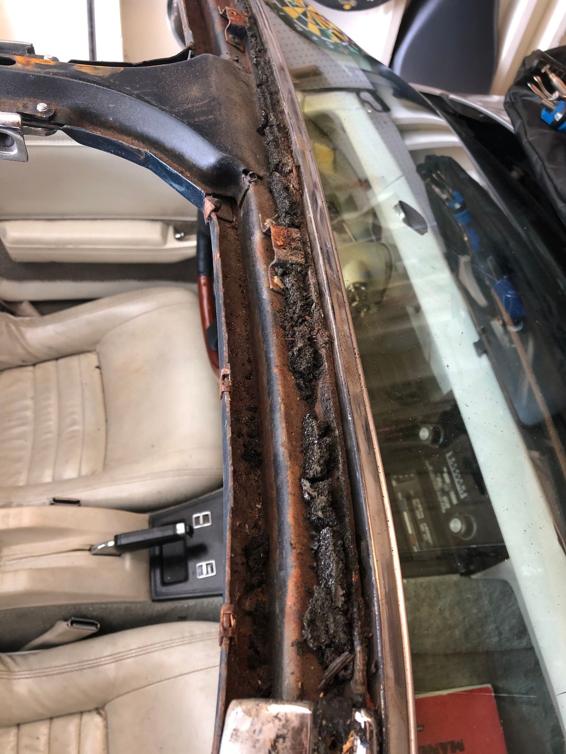

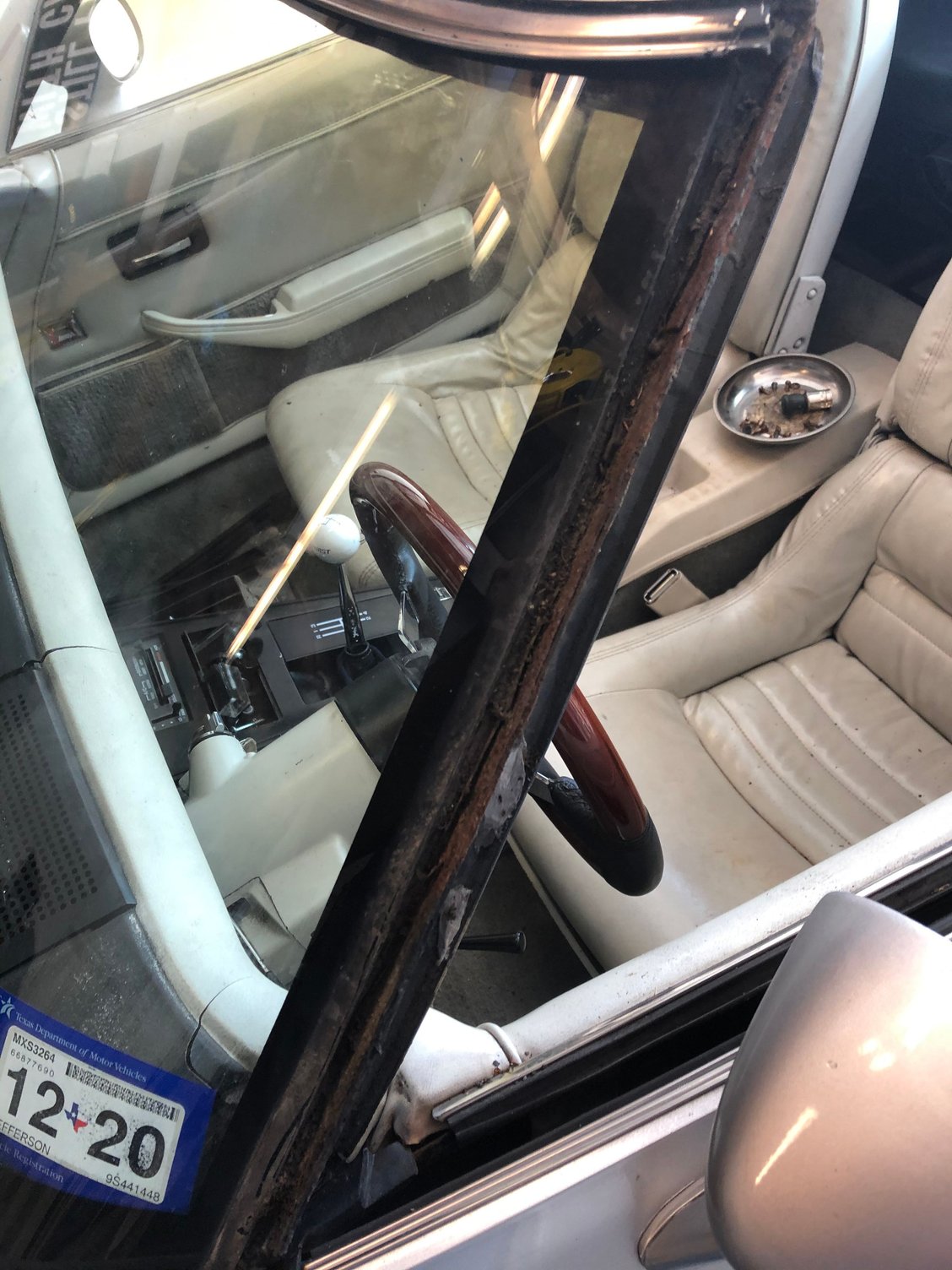

So in a quest to get her sold, working on bird cage (proof of condition and reconditioning) re sealing. Looking at it when disassembled (partly) looks like age destroyed the weather stripping, and some light rust.
planning on cleaning up, and resealing.
questions: how do I get the corners off? The last windshield trim piece? Don’t want to break the glass...
what to prep, prime, and paint with?
what to seal with?
windshield removal hopefully avoided....
will dig into the search more, but also want to get pics out there for condition opinions...

The windshield glass has to come out to remove or install the upper corners. A couple of screws in front behind the glass edge and it's easy to break....

Originally Posted by SwampeastMike
If your windshield isn't already broken and you remove the end castings that hold the sun visors proceed with
extreme caution! There are two small screws into each from the front near the windshield edge. It is extremely easy to nick the windshield edge when removing the screws! Edge nicks cannot be repaired and will run before long.
If you wonder about what to use to replace the hard black stuff used to seal some of the pieces used fibered roofing cement. You can find it in caulk gun tubes at any hardware store. The original GM product is no longer available but from the description I found it was essentially fibered roofing cement.
Looking like window removal next....

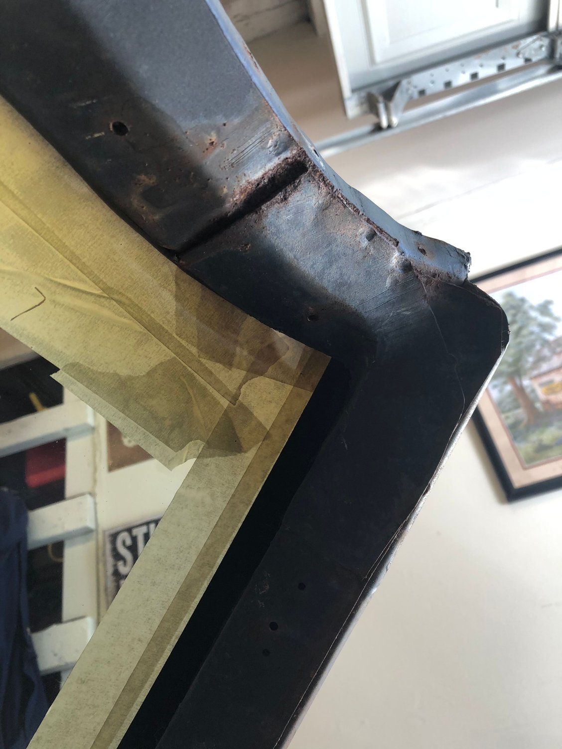

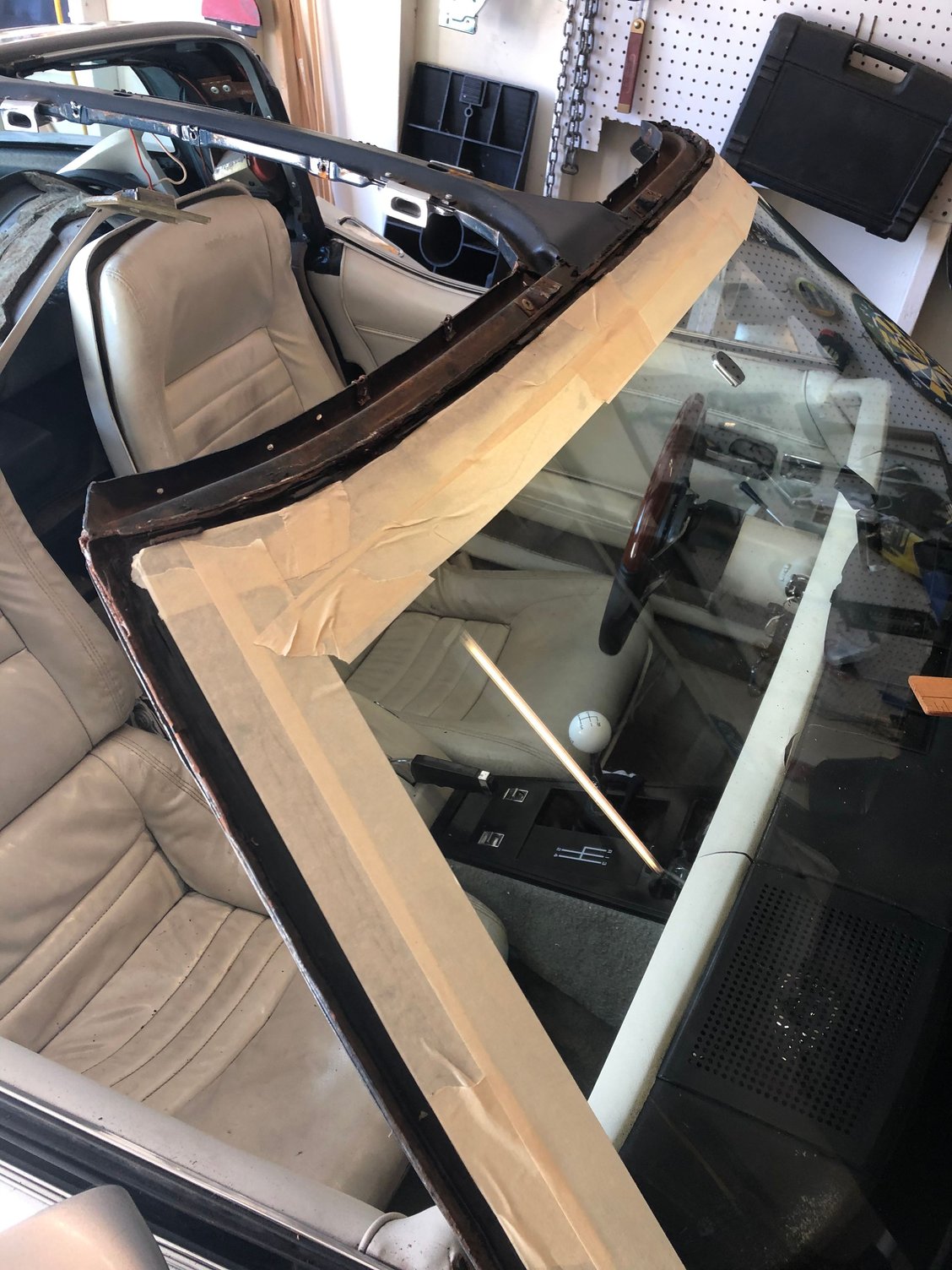

Went back with the pic, dug around looking for the corner screws — and found holes and more sealant
Guess they aren’t 100% needed. Some cheap insurance tape, and lots of tedious glue cleaning.
Inside passenger.
Inside driver
will update......
