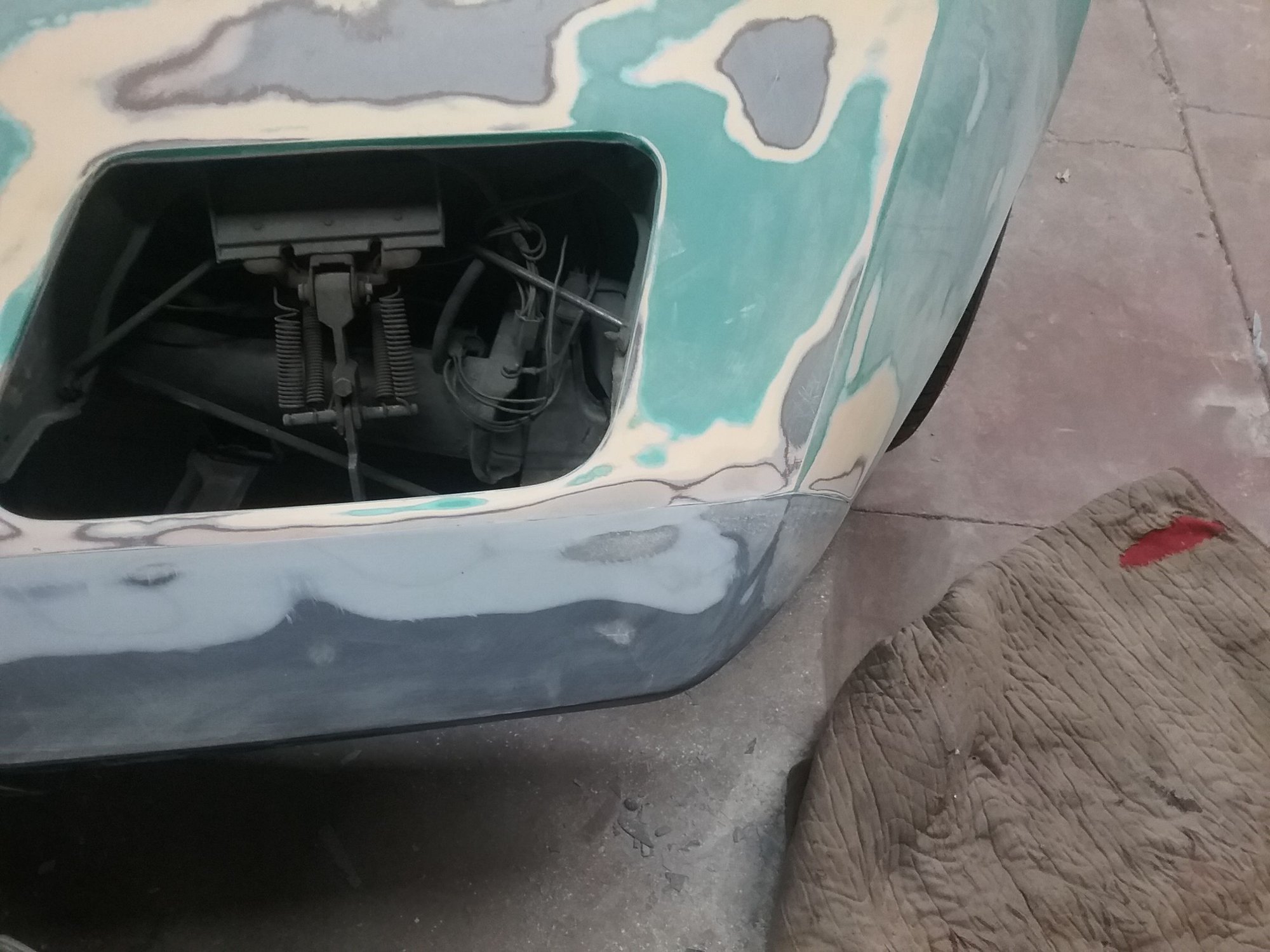

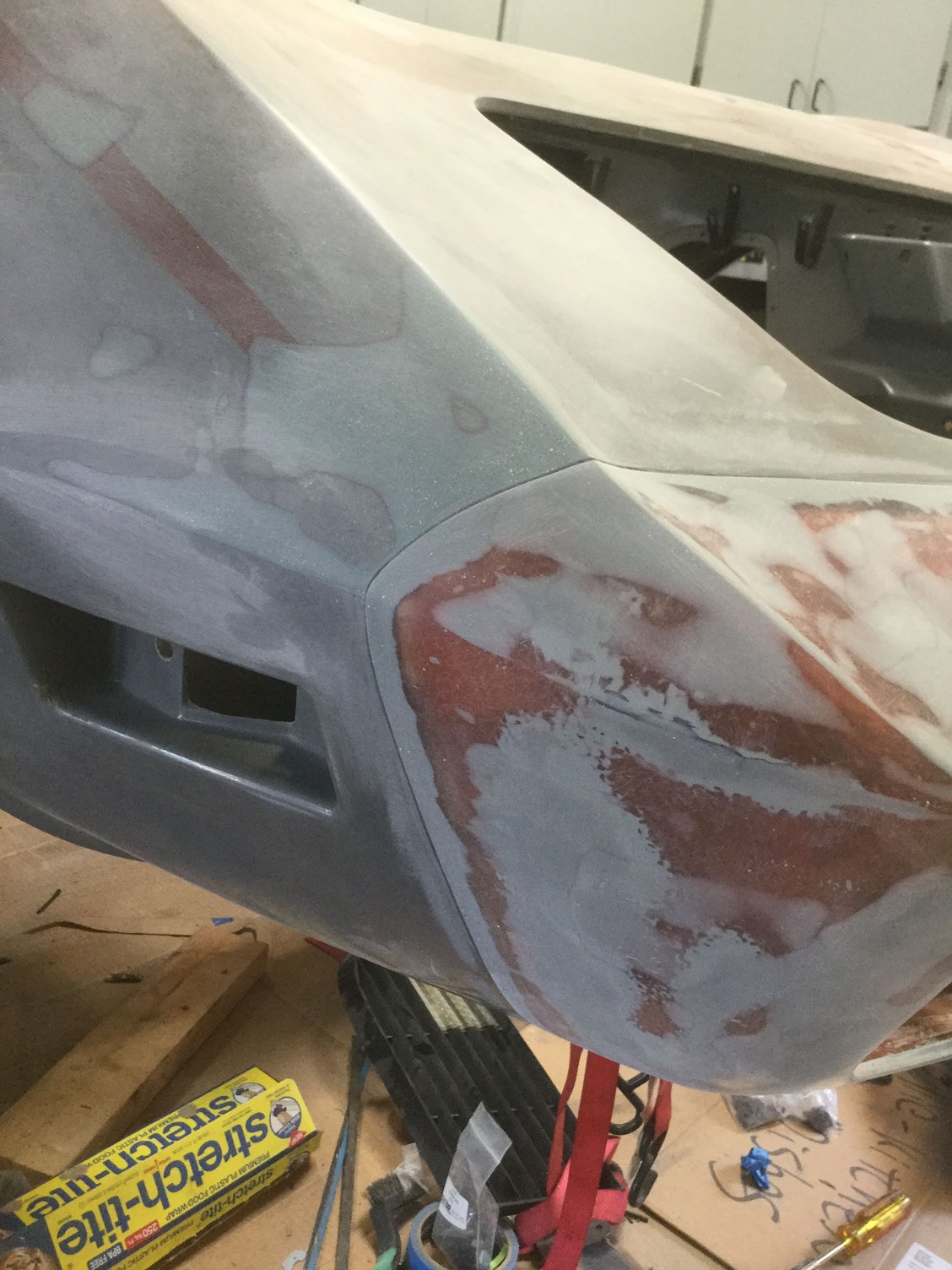

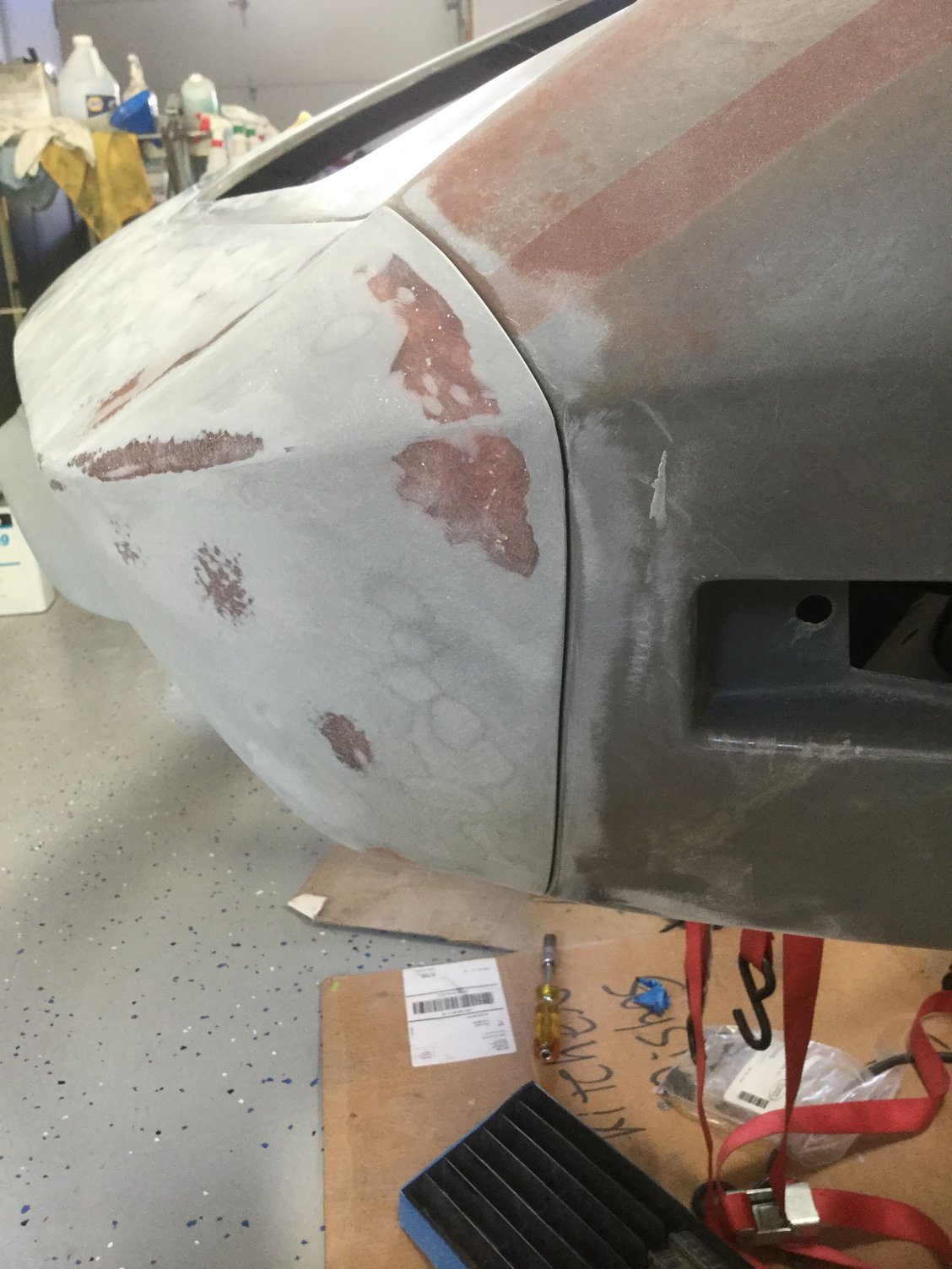

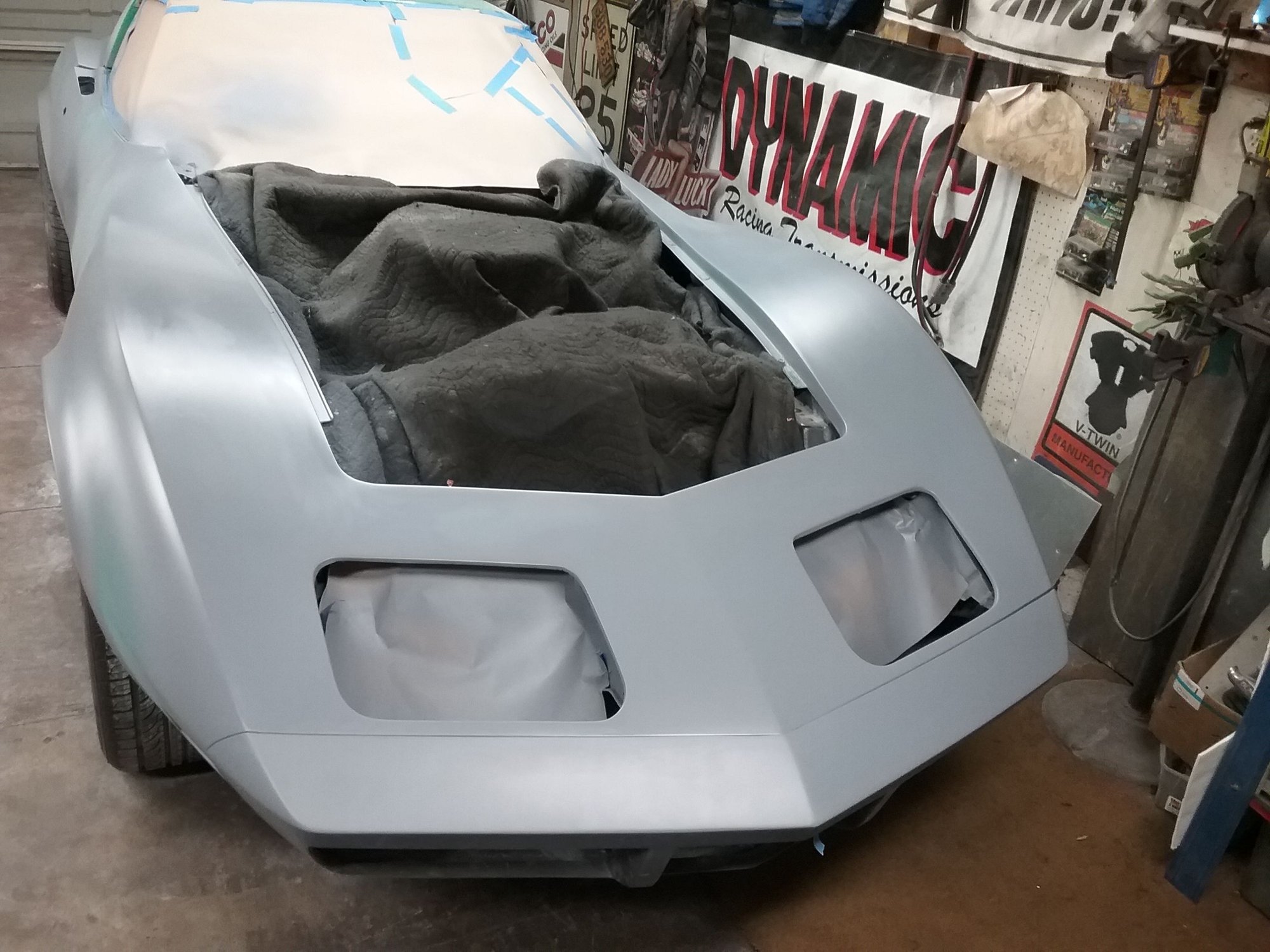

If totally agree with Lyndwood regarding the bumper cover installation by DUB. Very informative and helped me get through the painstaking process of getting a new fiberglass bumper cover to fit properly. I wish I had it on and off to fit just 30 times, more like double that. It is like anything else, the more time you put into it the better it will fit. I actually found my replacement fiberglass bumper cover from Ecklers was too wide and I had to cut it just to get it to fit close enough that I could start using the method described by DUB. I did have to trim the rubber bumperettes to give enough movement for a proper fit. I wish you good luck since I found this to be a real test of my patience.
Before
Before
Repaired new bumper
Yes, cut new bumper
Final fit
Other side final fit.
