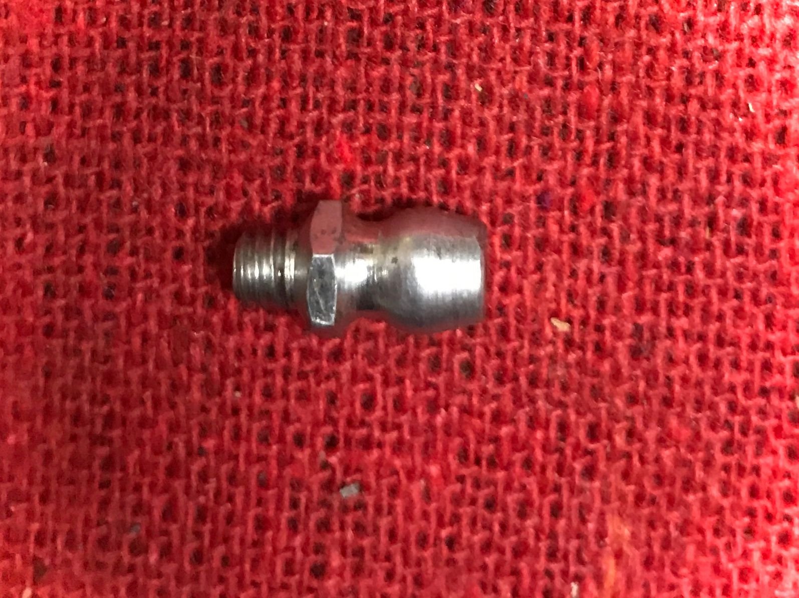

Looking high and low, can’t find where to get this zerk fitting. Appears to be an 8-32 thread. Any ideas?

Don't know that I've seen a zerk with that small of a thread on it (without being the miniature ones) What size is the hex?

The hex is 1/4

Alemite 3016 use a 10-32 thread but normally don't have check ***** in them

None of my suppliers list any 8-32 grease fittings at all, the only thing I see is the #10-32 (without the check ball) and then #6-40 (3018) again without the check ball.
Metric m5 x 0.8 is a possibility, they'd have a 7mm hex but that's not a lot bigger than 1/4 (which is 6.35mm so about .025") and a .8mm pitch which is pretty much 32 tpi, self tapping ones have a tapered thread

Thanks for the info.
I’ll check out the M5 zerk.
