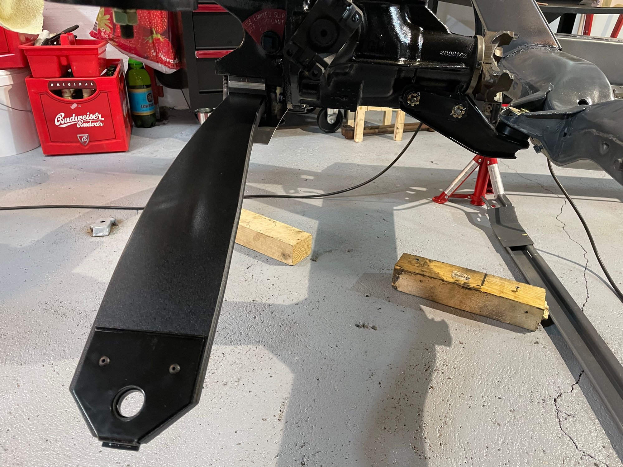

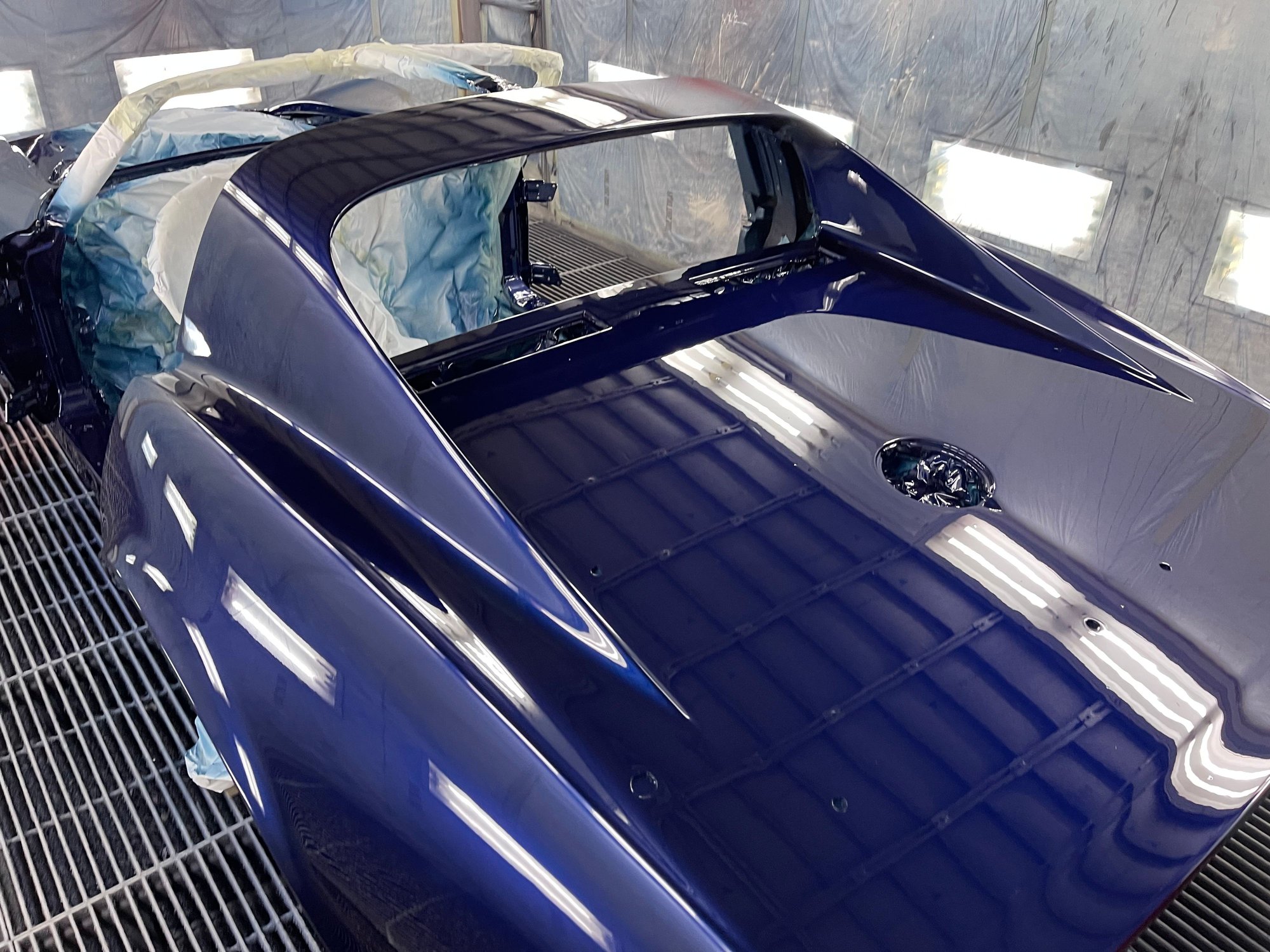

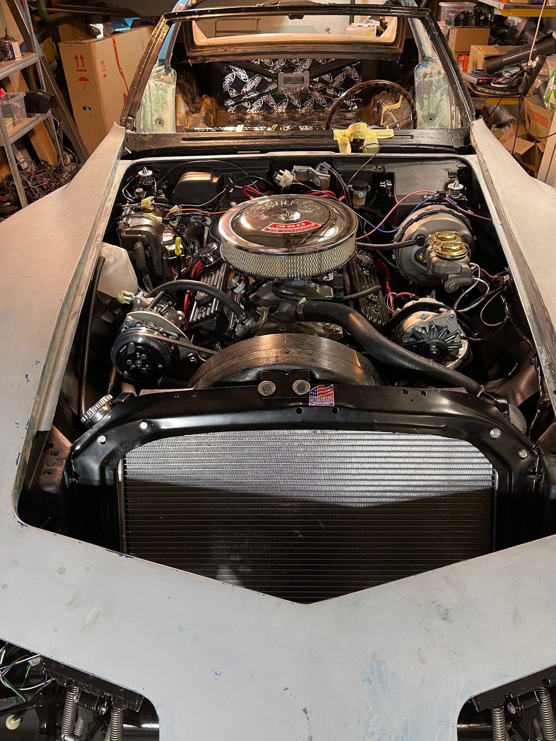

Hi everyone,
Few update photos from this side, hope everyone is good and making some V8 noise
She runs and drives...Mad Max style but I couldn't resist 😁

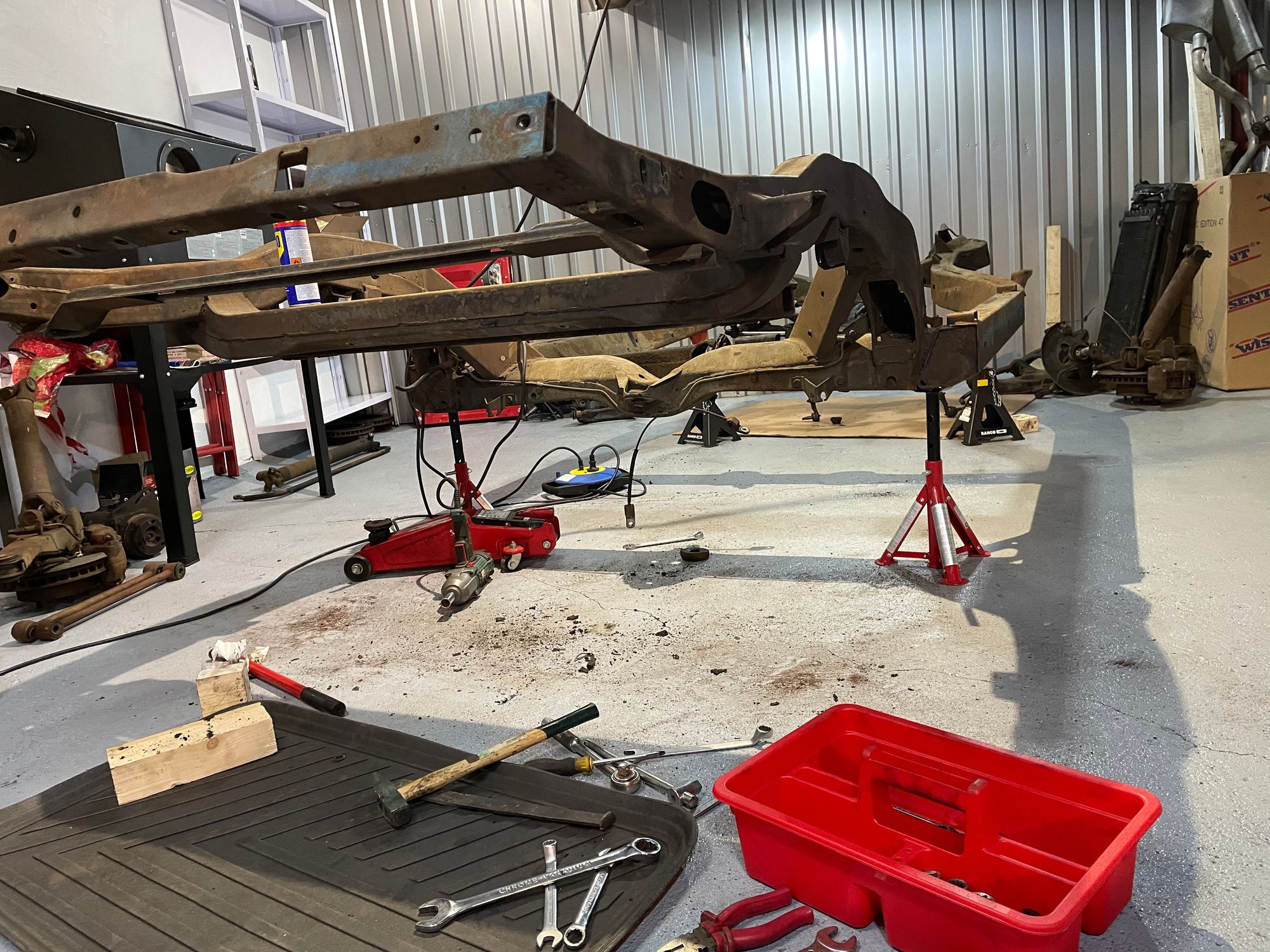

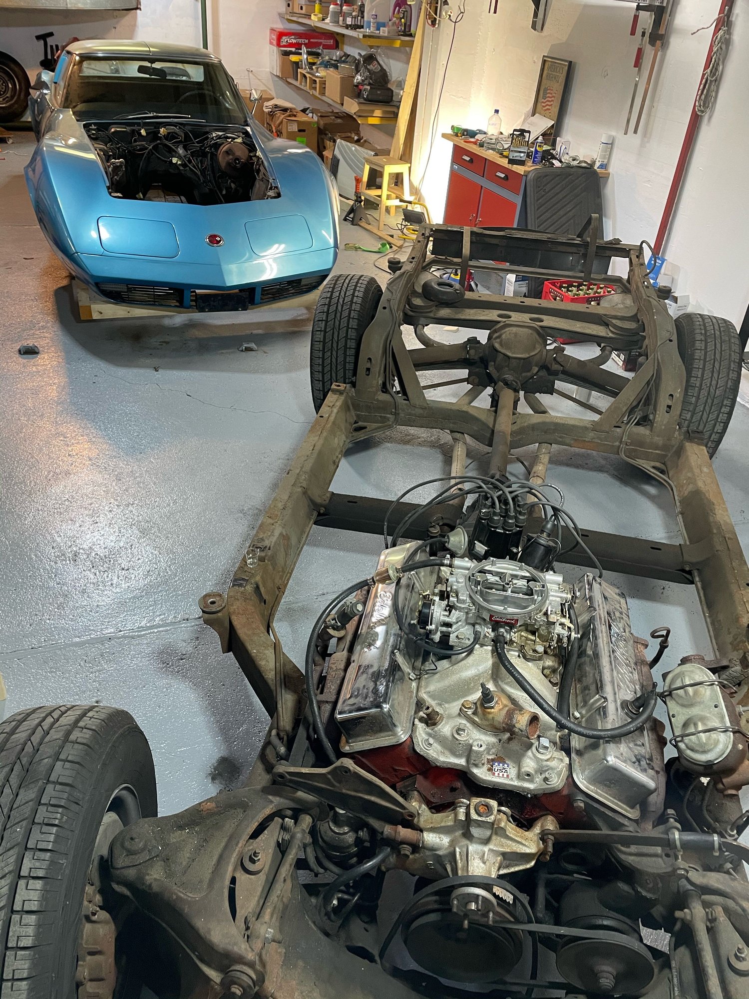

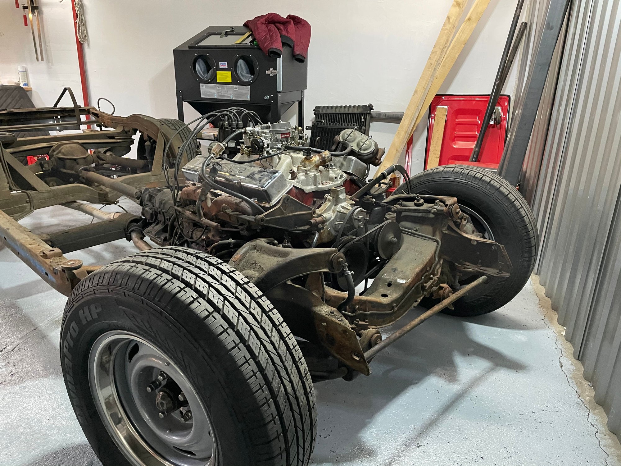

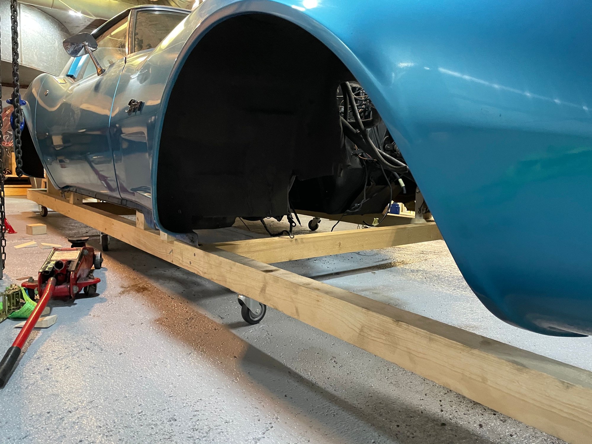

Little bit of update...
So body is finally separated from chassis, but it was quite a ride to get to this point.
I never imagined it would take me so much time to disassemble and prepare for the lift itself. There is just endless amount of - it’s just one more bolt to get loose and we are there. Radiator and radiator shroud alone took a day of my life.
All in all I missed only the cable from automatic shifter handle to tranny - I guess not bad for a rookie. However this forum and the amount of tips I got from you guys that did this work before is just priceless! You saved me!
As for the lift itself, I went the hard way...Please don’t laugh!
I thought initially to try it will 4 hydraulic jacks and slowly lifting and putting in supports along the way. Don’t do it.
In the end I did it with a chain hoist on each side of a car and using a 2x4 across the bottom while keeping the car in balance. This worked like a dream!
No damage in the end and one big happy face
Body is now lying on a low dolly, easy to maneuver around garage. As for chassis it really looks to be in good shape, no dents and no damage, occasional surface rust, but no rot. I can see someone played with fuel lines as return line is cut and plugged, as well the line to carbon canister. Fuel tank was changed or taken off at some time so no build sheet
I did find however inside the car a 1 cent coin from 1977. It was stuck in seat rails. Lucky coin, will epoxy it somewhere to body and let it continue the journey.
Time for a small victory beer, cheers everyone
Matko

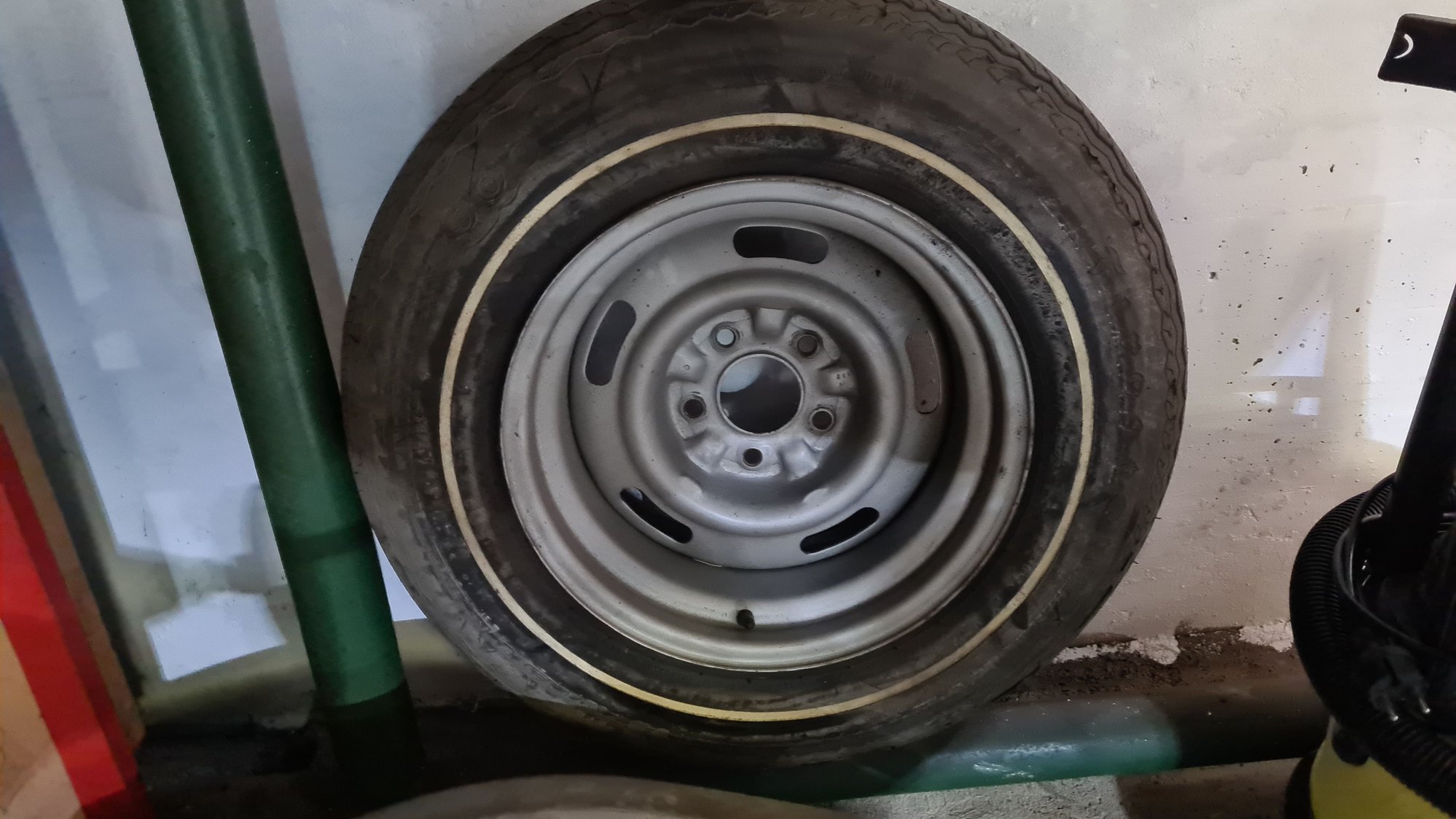

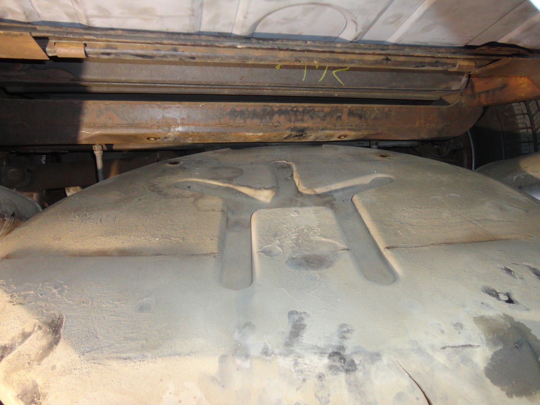

Oh, and almost forgot...had a strange looking tire in spare tire well. Didn’t pay too much attention to it, but it turns out its a Firestone 500. DOT points to 25th week of 1972. How cool is that ))
Old Nov 13, 2020 | 08:20 PM
OldCarBum's Avatar
OldCarBum
Posts: 14,428
Likes: 8,232
From: Napa Valley California
Cool, finding the penny.
I also like your body dolly.
Simple design.
How well does it roll?

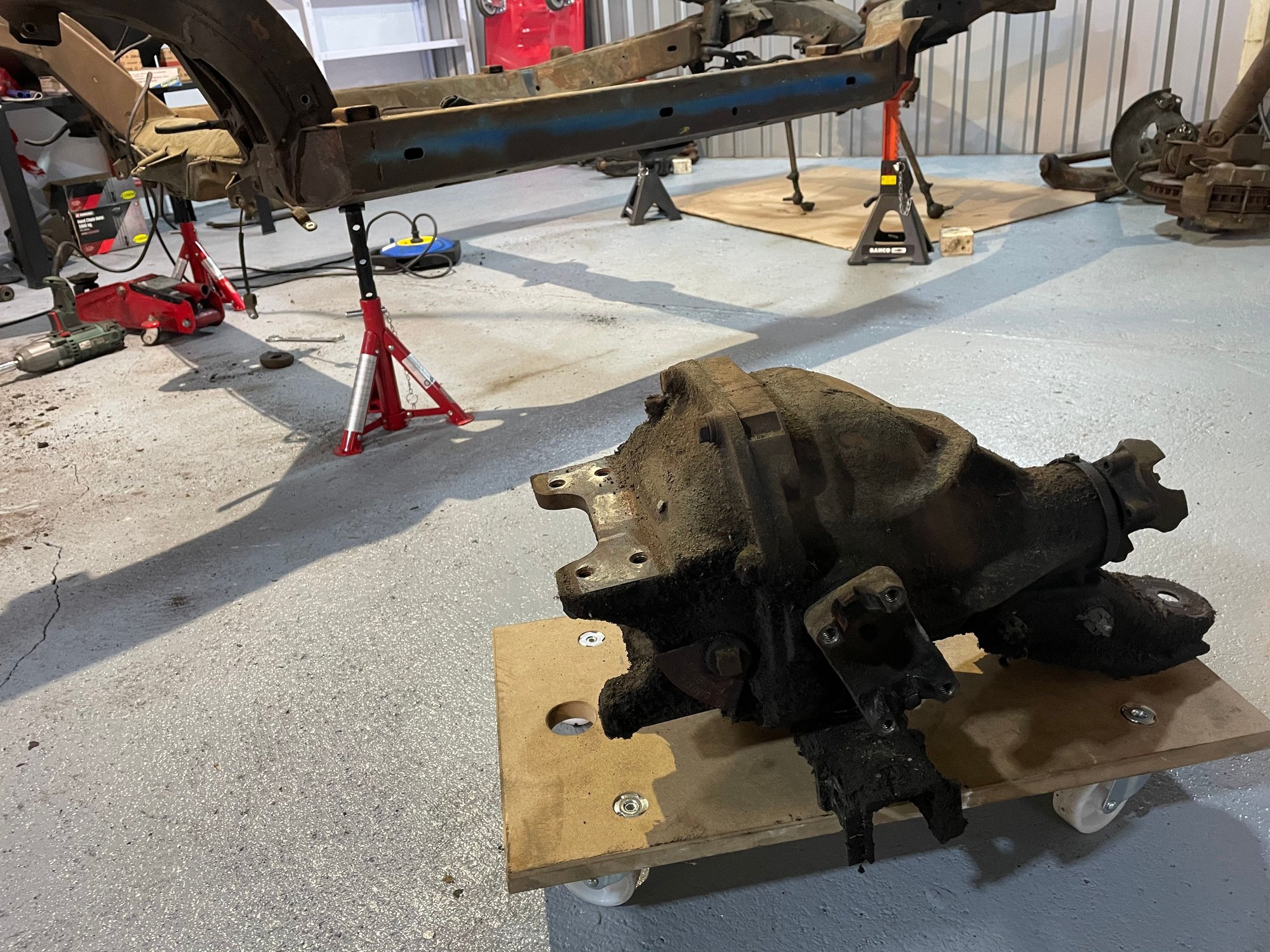

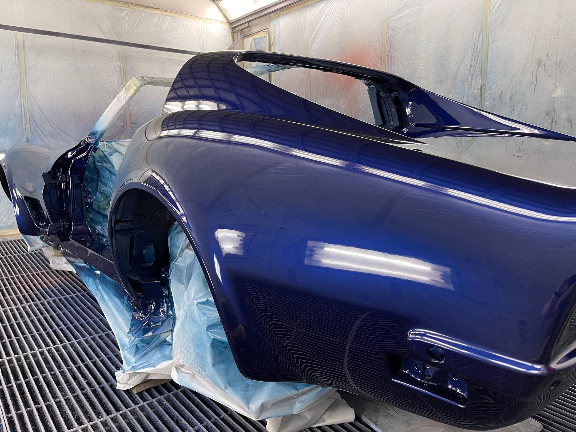

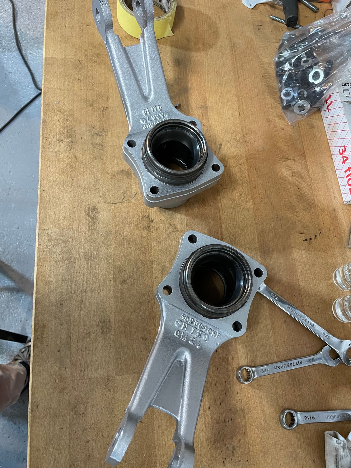

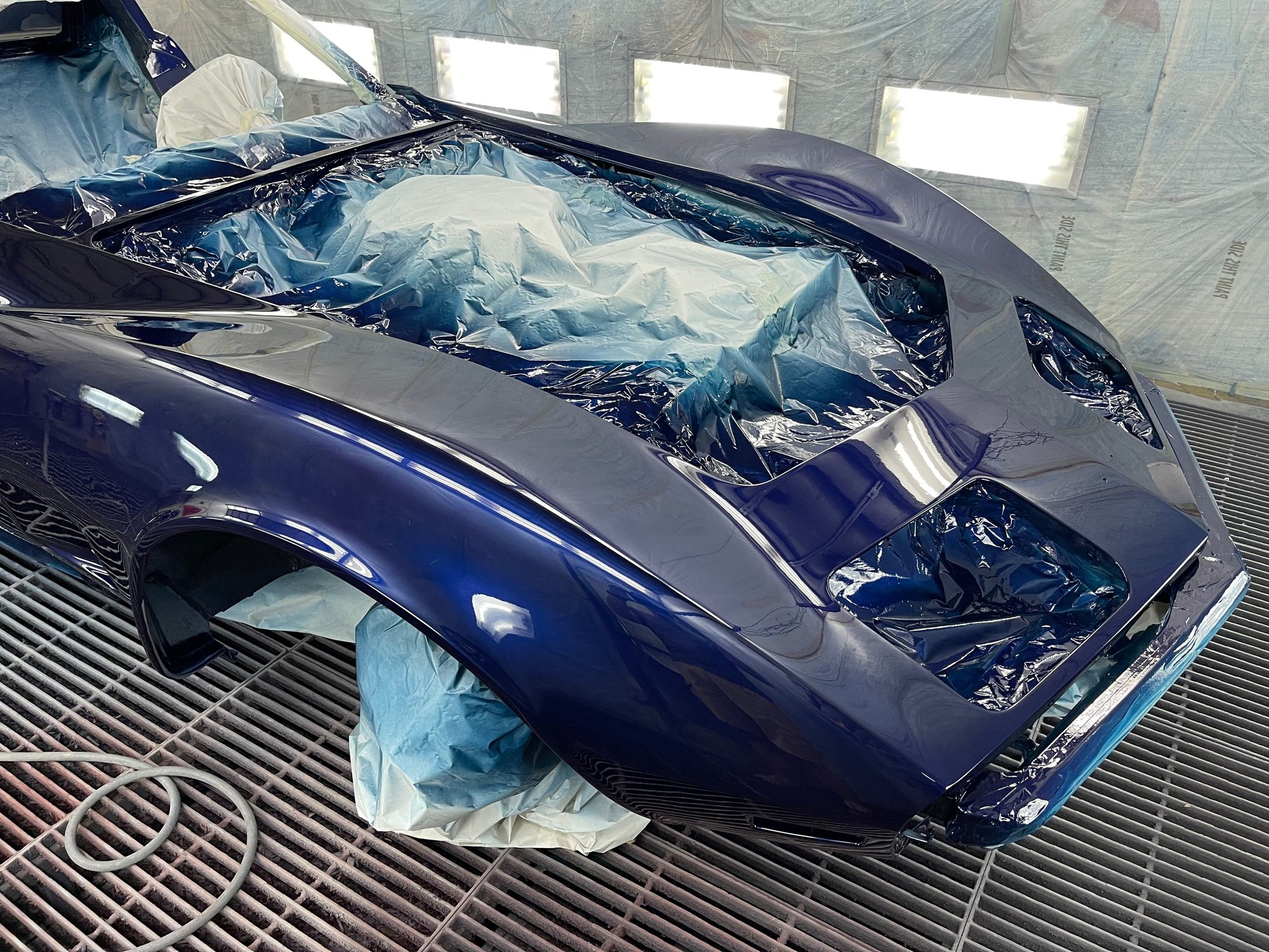

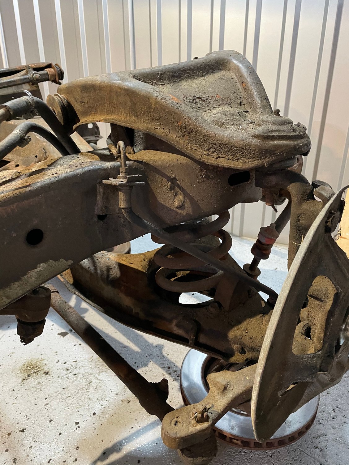

Few more update photos
Getting ready for sandblasting and paint
Getting those springs out was a real nightmare

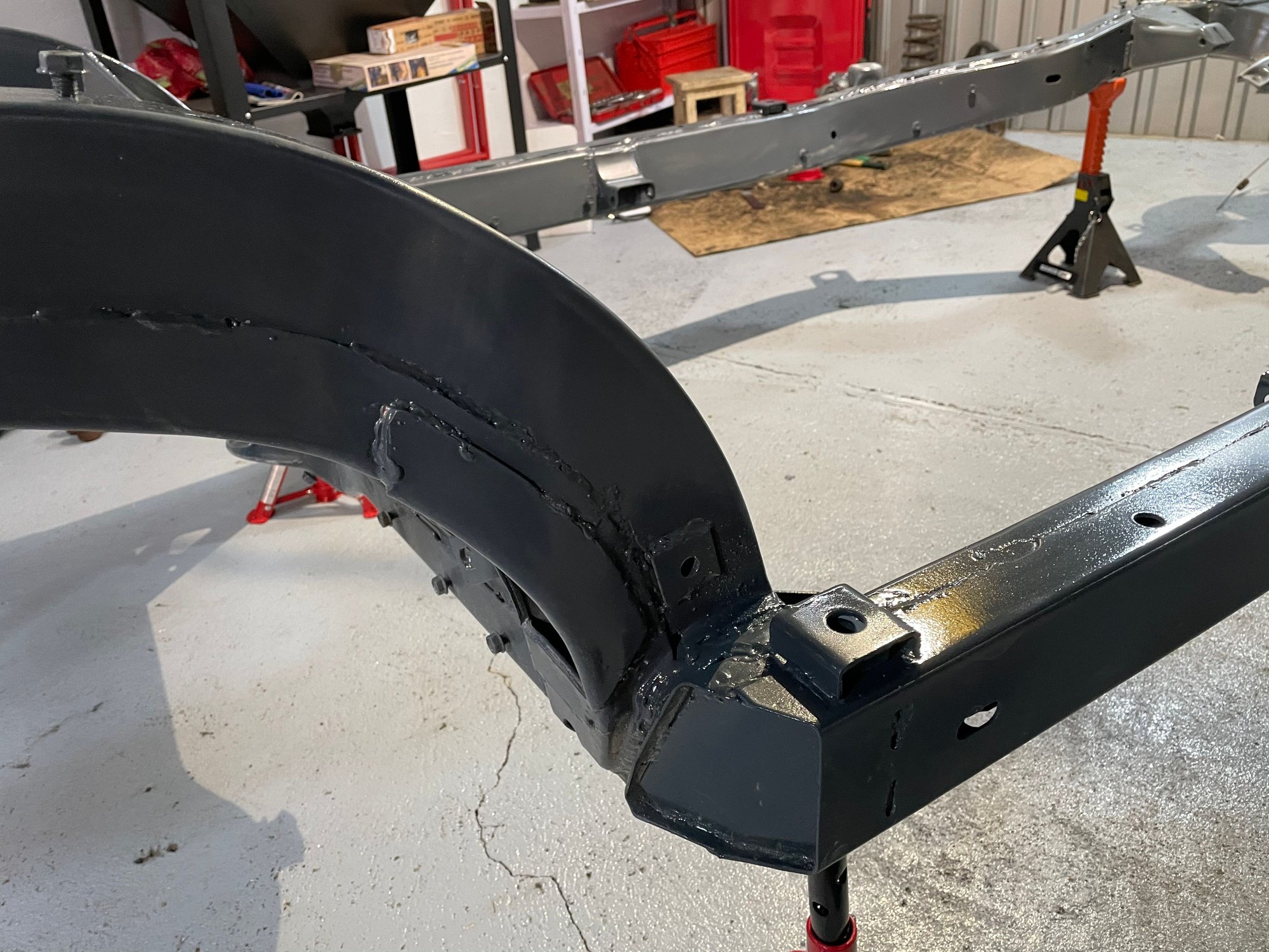

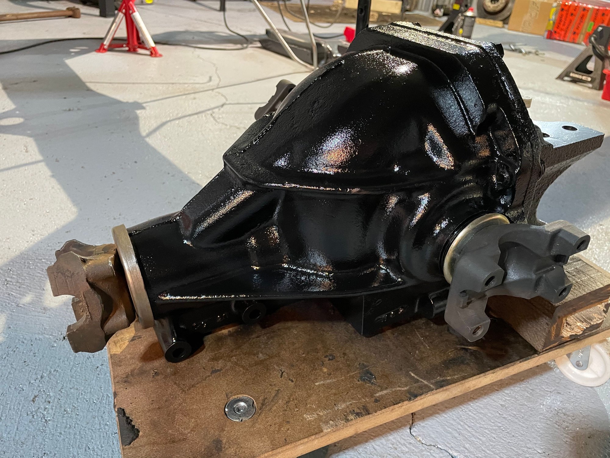

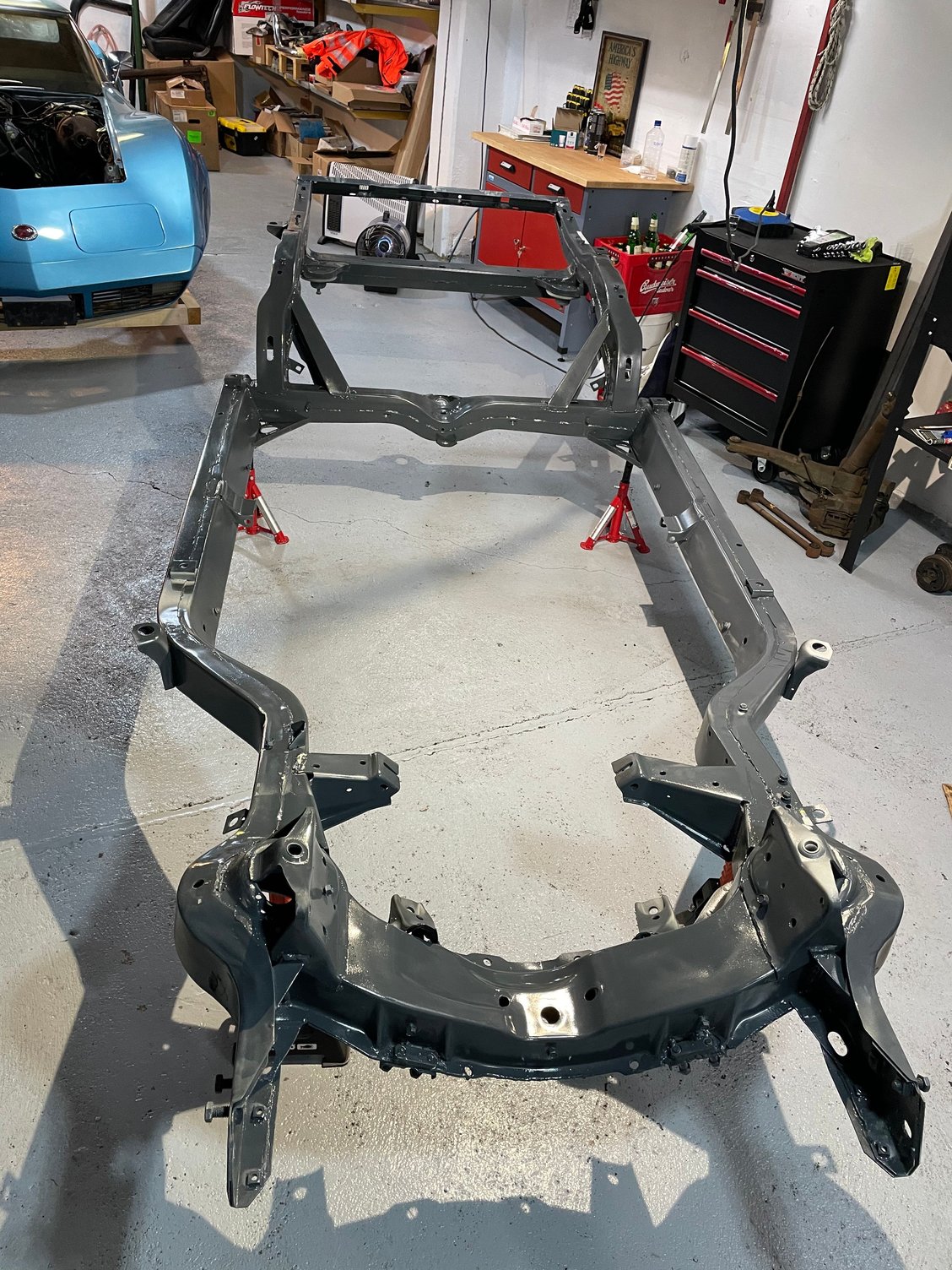

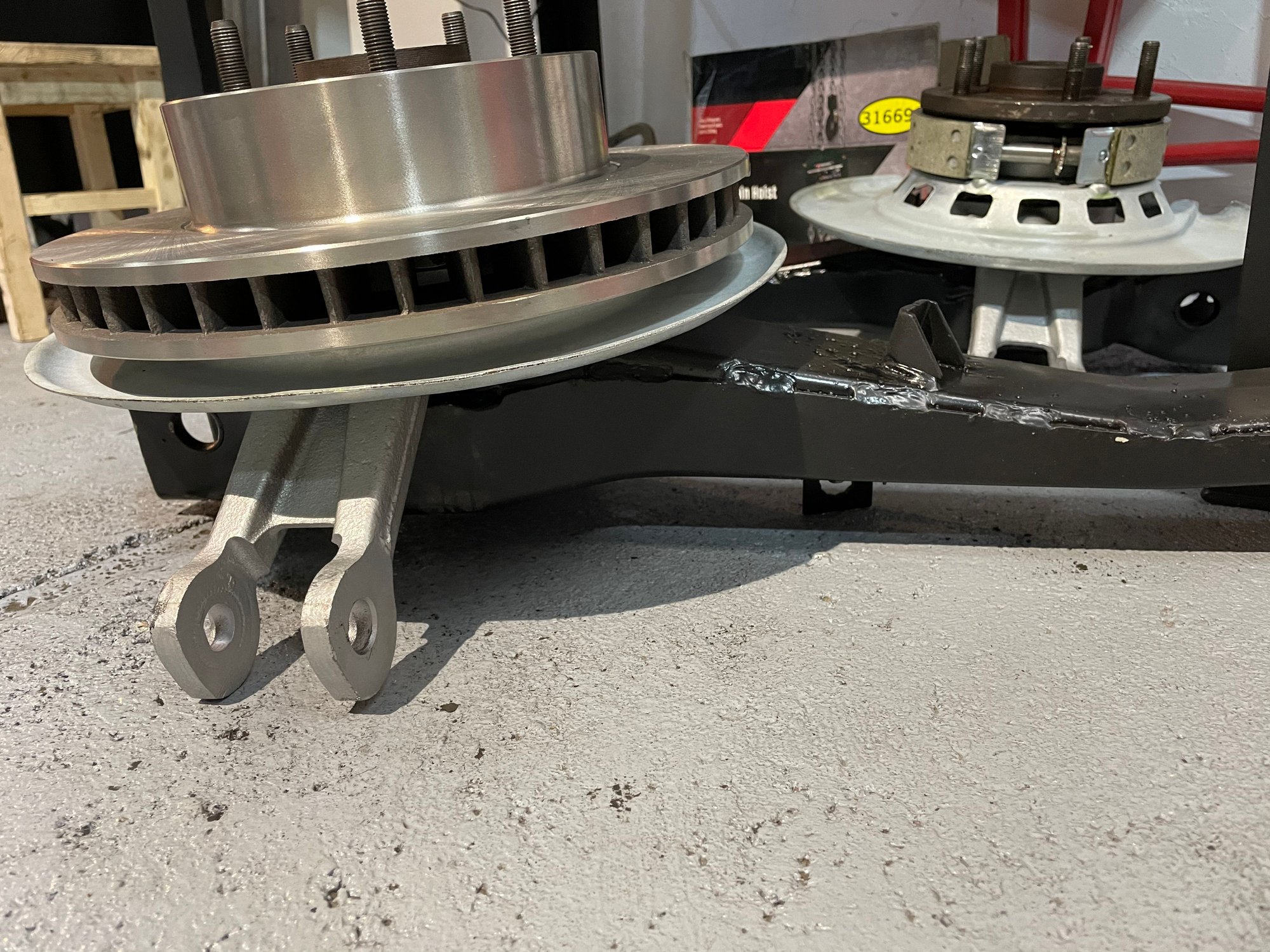

Guys few more progress fotos...

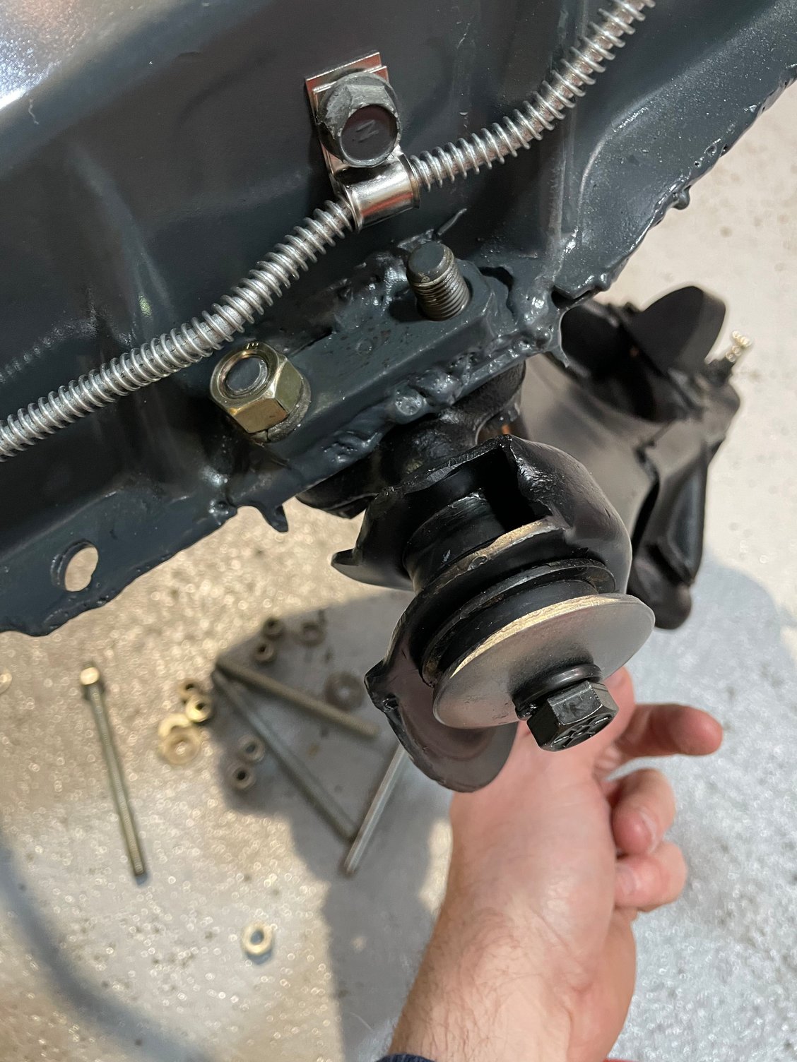

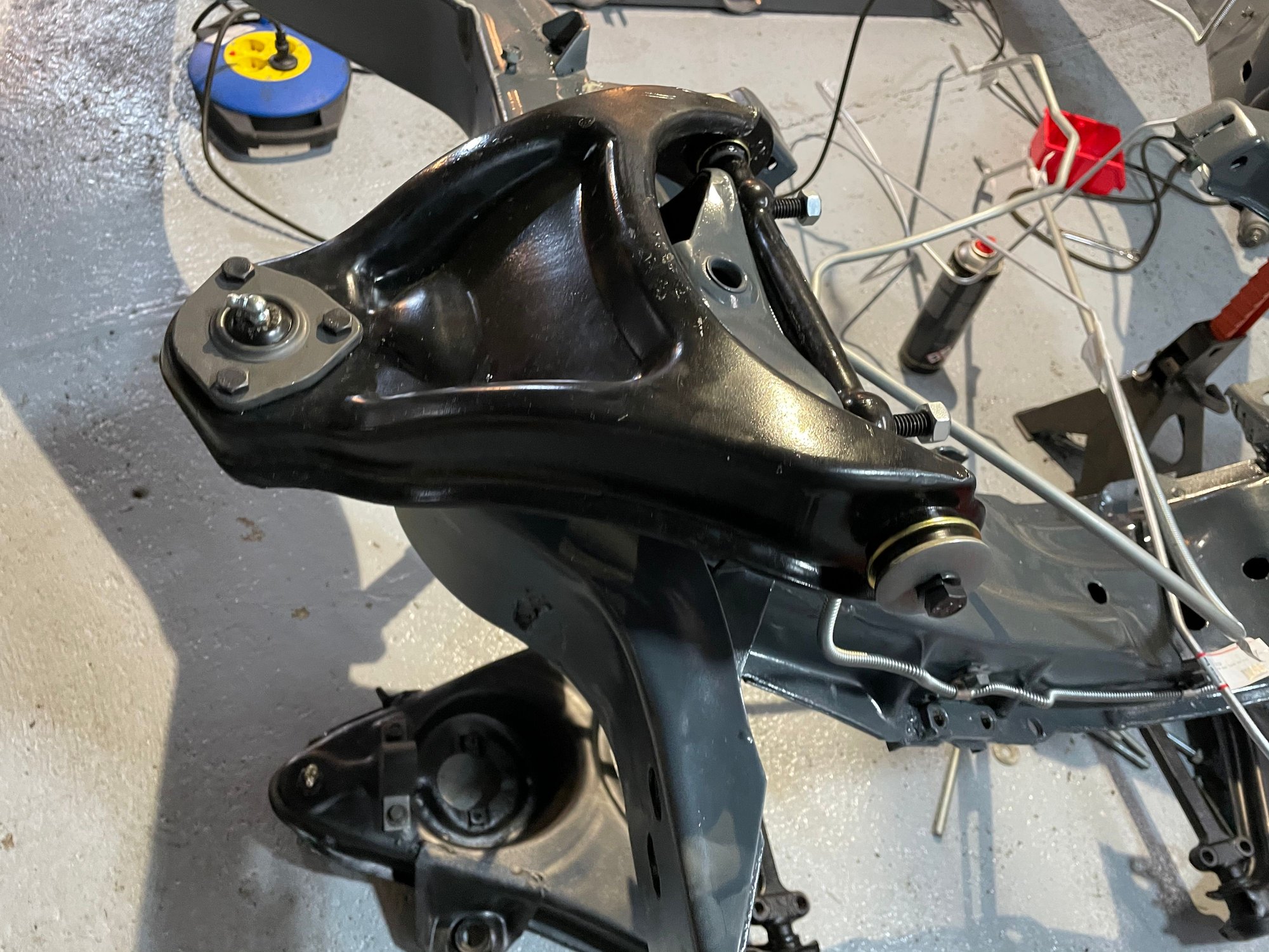

When I was installing lower control arms, the thread of LH nut plate gave in
I am reluctant to cutting it and welding a new one, so I thought to just attach it with a nut from above.
Should hold even better that before, what do you think?
Anyone had similar issues?
Also, when I try to tighten lower control arm bushing retainers, arms will not even move anymore.
I am worried if this is normal and how should suspension work then?
I have rubber bushings on lower and poly on upper control arms.
Thank you guys for any inputs!
Old Mar 3, 2021 | 08:23 PM
DonnieP73's Avatar
DonnieP73
Joined: Mar 2013
Posts: 1,018
Likes: 582
From: West Monroe Louisiana
You need to have the body back on and the engine in before you tighten the A-arm bushings. They need to be centered on the weight of the car
so they can flex up and down evenly.
Donnie
Old Mar 4, 2021 | 12:57 AM
pilotlovac's Avatar
pilotlovac
Joined: Dec 2018
Posts: 56
Likes: 69
From: Zagreb, Croatia
Oh, I see...thanks
