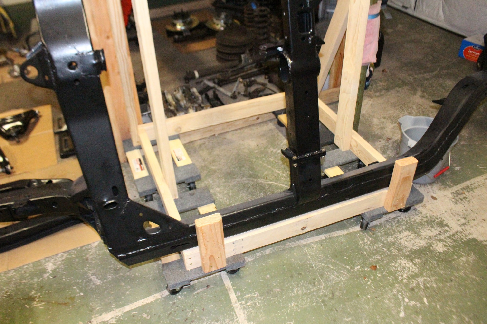

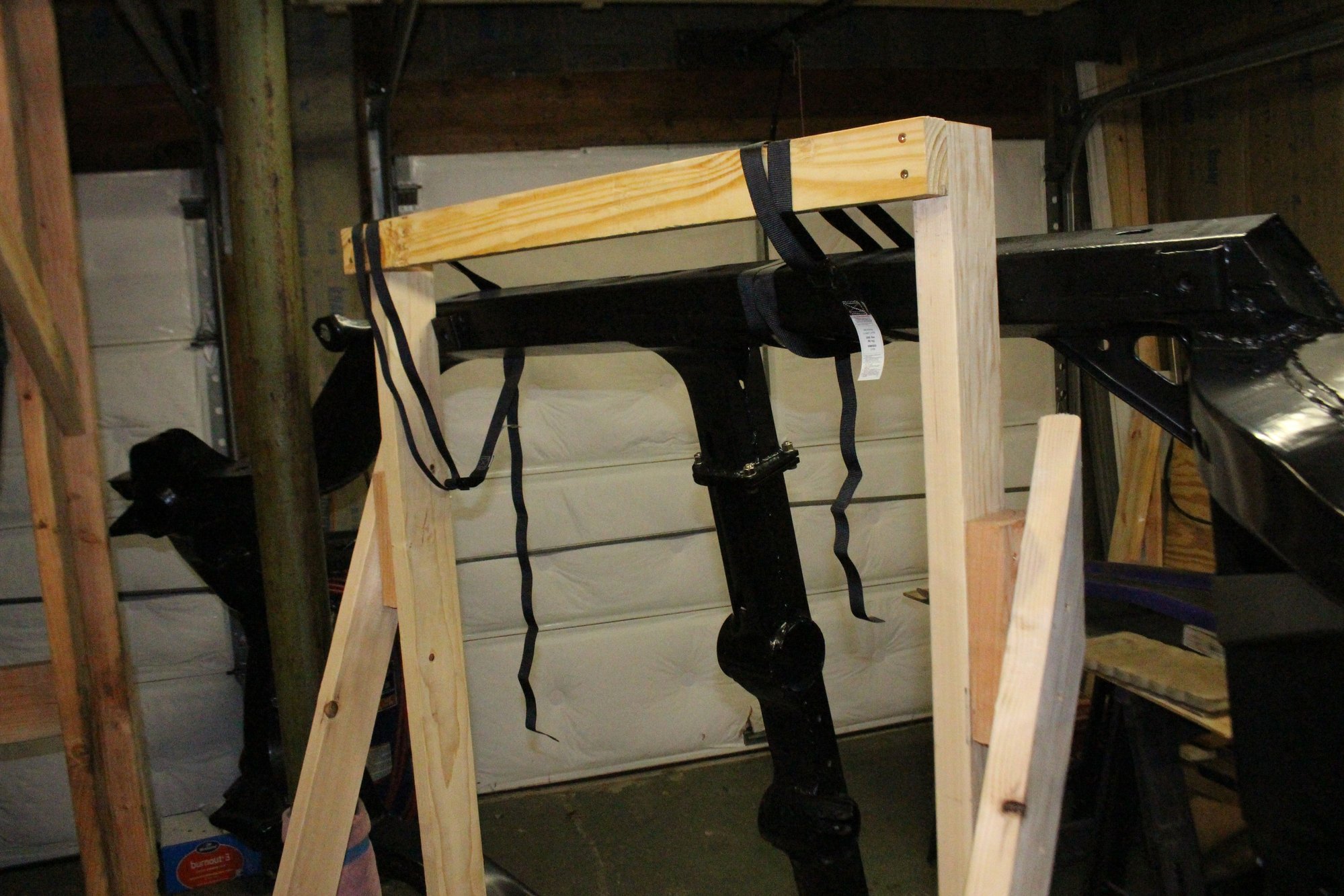

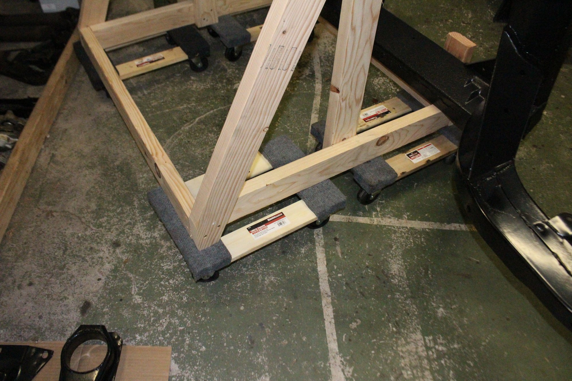

Another member asked me to take some close up pictures of this dolly I made.
So I thought I would share it here.
Honestly I got the idea from a third member, NWav8tor
It solved some space storage issues I had. Rolls around easily with one hand.
Screwed to Harbor freight furniture dollys
38X40X62
38x40x62
Just 2x4s and $10 dollys from Harbor Freight

Thanks Leigh......that will be my next project. Looks like the dolly is just sitting on the HF dollys......or did you screw the 2x4's to them? I suspect its just sitting on it, as the frame is pretty heavy!!
I believe Leigh said he screwed his rack to the HF dollies. I used the metal wheel dollies I had. I placed a wood platform with blocks mounted to it across the "dished" area that normally would hold the tire. Then I screwed the rack to those blocks...

I never would have thought of this if I had not seen your picture. Thanks!
And I did screw it to the dollys because I did not want them to kick out from underneath, I have a 1 inch lip at the edge of the garage by the driveway.
