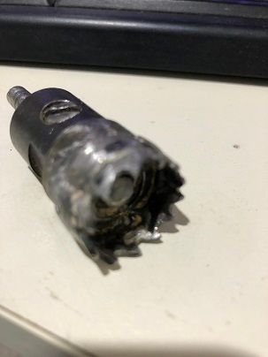

When I did my 68 I shortened this little hole saw cutter for the job and it worked great. Its a Starret, No.A-4. Cut the teeth off, removed enough material and had them welded back on. Ground down the pilot and pulled it back so it didnt come in contact with anything while cutting. The teeth are 7/8 wide and total length is 2 1/4. After marking the headers position so it can be put back exactly in the same spot the tool simply removed enough material to remove the rivets. Obviously have a gentle touch while cutting.
Lord-Fusor adhesive in a double tube gun was used to put the header back in. Rock solid. I went Harbor Freight clamp crazy to hold it back on.
Clamping thin wooden slats on the paint side of the car over all the bumps made them vanish. I couldnt believe it, they were gone.
That's fantastic, thanks for the info. One of these days I might have enough nerve and enough to drink, to give it a go. I think I have about 7 places, only on the right side oddly enough
