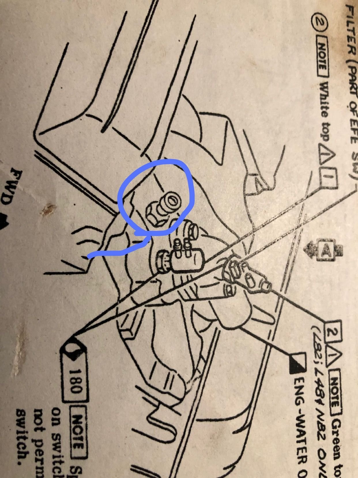

Hello I have a 76 corvette and I’m looking for a part and I’m not sure if the name but I have a picture of it from the manual and I’m wondering if anyone knows the name of it and where I could buy one?
It’s near the thermostat housing and a vacuum fitting if I’m not mistaken.

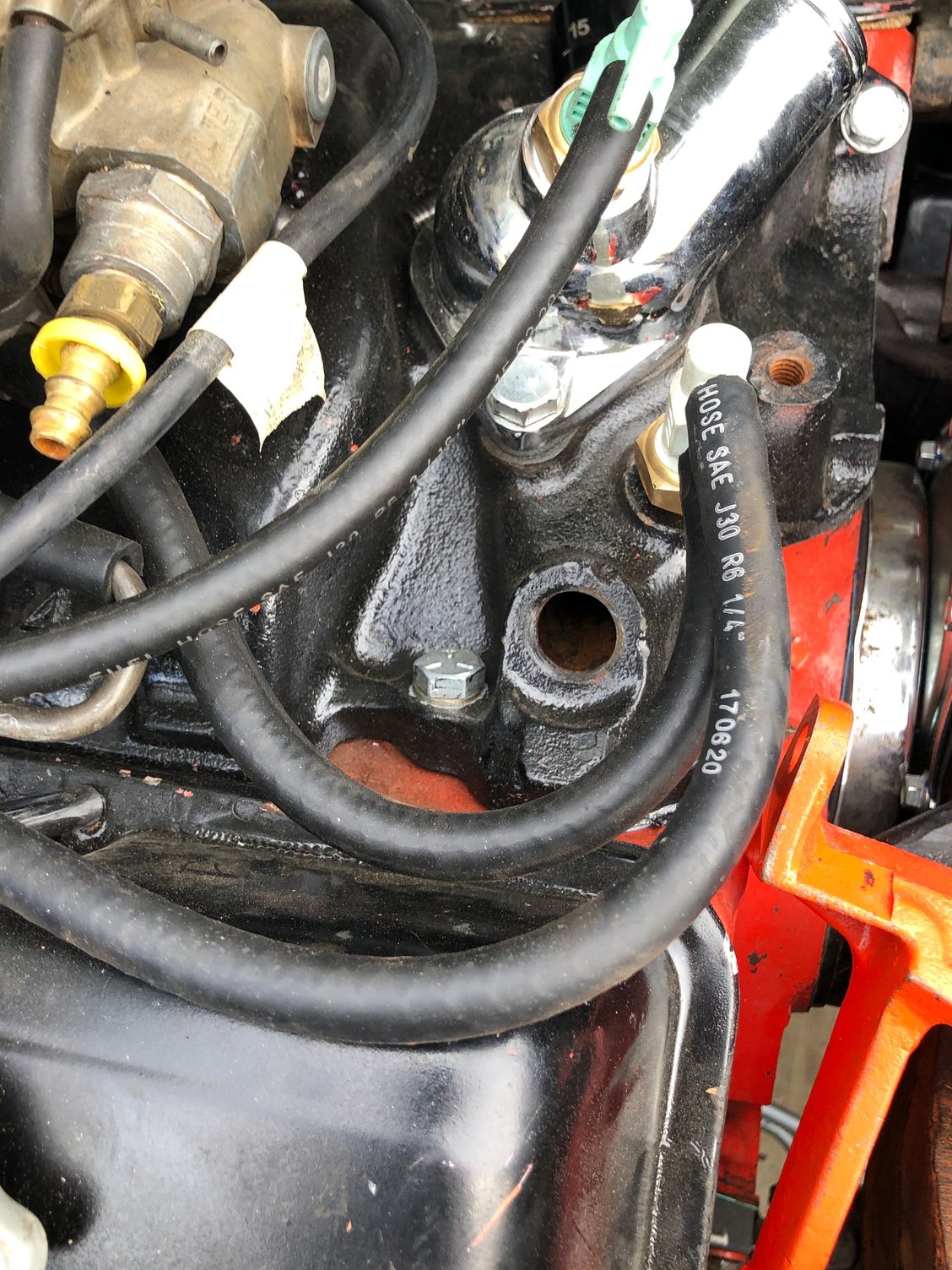

Here is a picture of it in person for a better reference if it’s of any use.

https://www.ecklerscorvette.com/corvette-heater-hoseintake-manifold-nipple-5-8-1959-1980.html

I found one at local NAPA that is 90* to the manifold. Forces the heater hose forward instead of over the valve cover.

oops i think youneed something like this 1/2" thread with 5/8 hose nipple. the first one is 3/4 hose

If you have a printer hooked up to your lap-top, click on and borrow NONN37 link photo. Take that to NAPA and tell them you want that 1/2" NPT with 5/8 hose, but want a ninety degree unit.
Summit Racing has a blue one but you have to pay shpg.
If you squint your eyes you can see it in my avatar to the left.

I see you have a smog pump bracket in the pic
if you have smog system i dont think youll be able to turn the hose 90 degree forward. youll have to make it come out straght, because its a tight squeeze over the valve cover and smog diverter valve.
