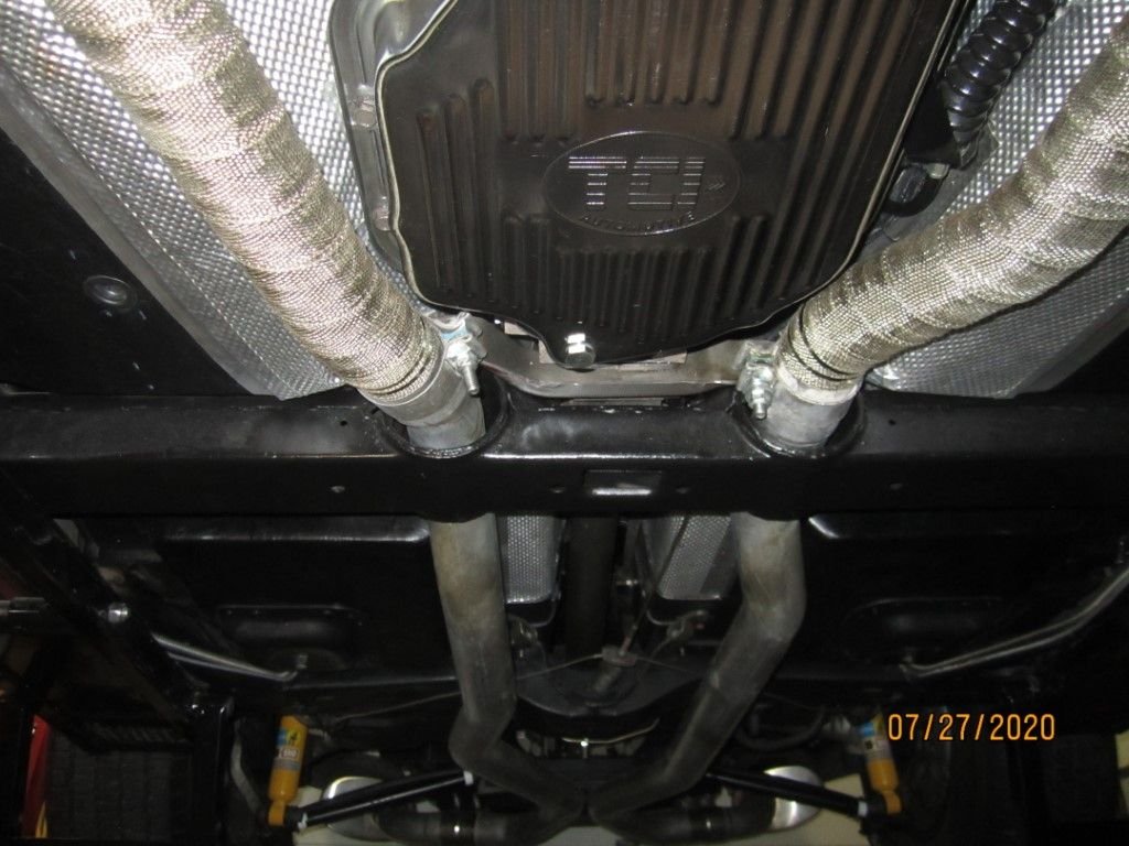

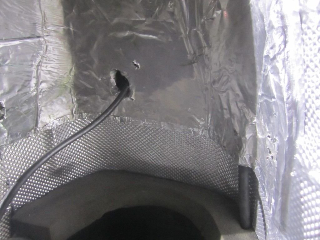

Looks a lot like DEI Floor & tunnel Shield which I used under the drivers and passenger floor area where the pipes run.
Seems to have helped a little but it's hard to tell at this point as over the years I've added insulation under the carpet and wrapped the forward pipes there but it certainly hasn't hurt.
I still believe the largest "bang for your heat buck" is the stock style tunnel insulation and the foam horse collar
M

I used the DEI tunnel shield on my 69 firewall, floors and tunnel. It works great. You won’t need anything under the carpet with this stuff. I have undercar 3 inch exhaust too! Excellent product!

Installed under the carpet any type of insulation becomes far more about sound reduction than heat. For that reason choose something especially good at reducing sound transmission (like "mass" backing).

I should have been more specific, floorboards all got B-Quiet / dynamat and factory felt, depending on where it was, tunnel got the Dynamat and shredded insulation and the firewall upper dash got the factory felt and shredded stuff. Then the DEI underneath with the factory blanket and horse collar
M

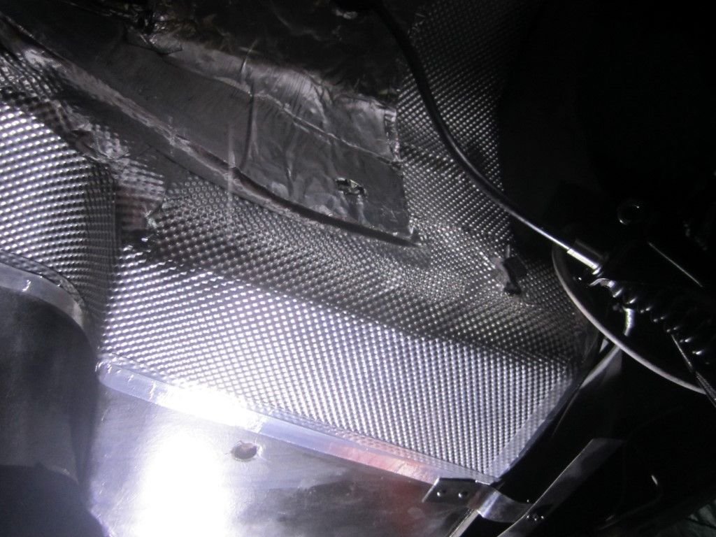

It's got an adhesive back, really sticky, make sure the floor is really really clean and dry (wipe down)
Cut and fit everything several times, it cuts fairly easy but it's an aluminum skin so it doesn't stretch or anything, you cut it and notch it to fit
Then they sell a tape to help seal cuts or edges
Mines been on for a few years now and has no signs of letting go anywhere
M

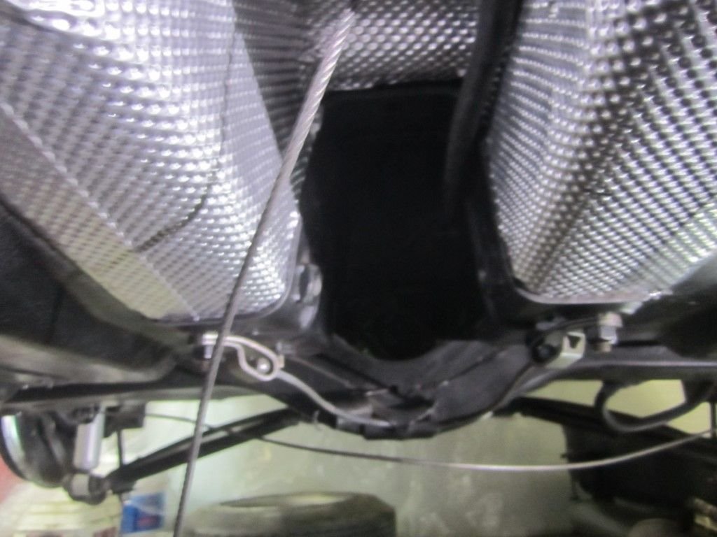

As Mooser said, it comes in a self-adhesive variety but you can also get it without adhesive. I got the non-adhesive version to build a transmission tunnel heat shield when my transmission was out. I was able to use a rubber mallet and some gentle tapping to form it very well to the underside of the transmission tunnel. Rather than adhesive, I used the same clips that hold the factory tunnel insulation but added a couple.

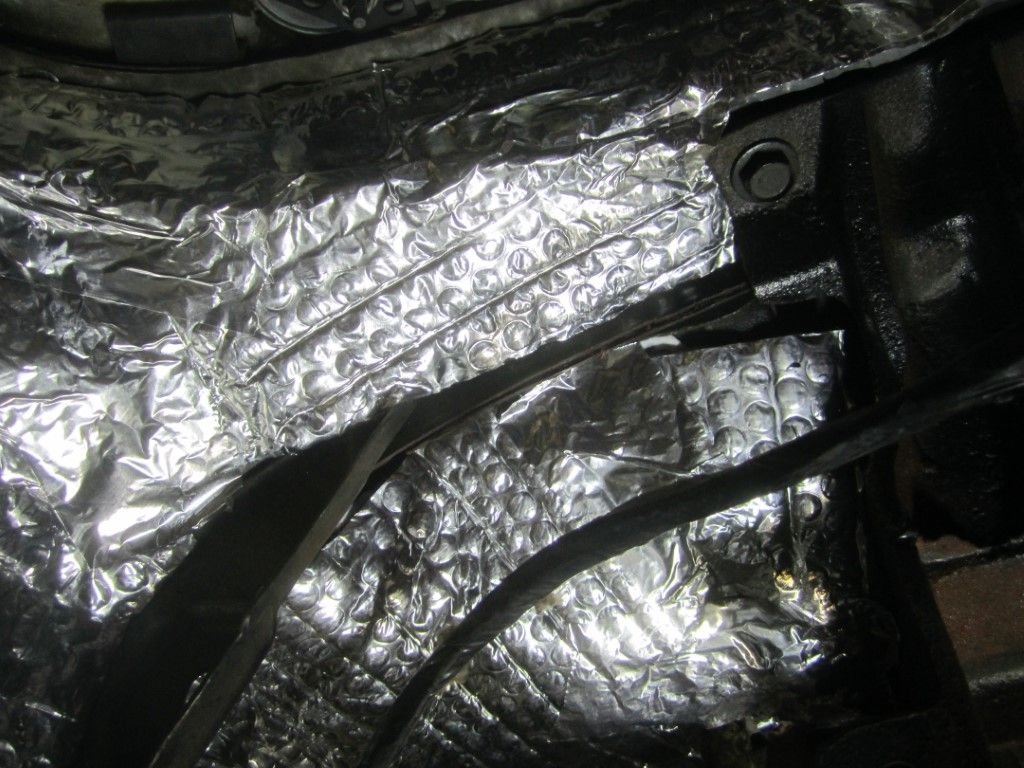

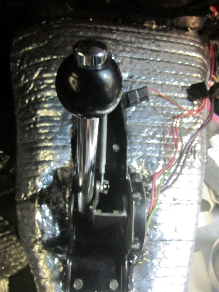

I used Lizardskin ceramic sprayed onto entire interior of car (did not use the sound insulation they sell) AND Lowes Reflectix, with factory carpet / jute on my 77.......absolutely ZERO heat inside the car. I also use the foam horsehoe collar on the bell housing. But, there is NO insulation on the outside of the firewall or floor. None. As stated above, GM stopped using tunnel insulation in 77. My right foot is six inches from the header pipe, and with the Lizardskin and Reflectix, I feel ZERO heat, even driving hours in summer in PA. This is on a NON AC car, T-tops off, windows down. I could drive the car all day in 90 degree summer weather, no heat inside. I will also add, I have no holes in the firewall, and all seals replaced. ONE caveat.......I did not have the heater system connected. I do know, but driving season is over, so next summer, I hope the heater core does not make it hot in the car. For now, I have factory vacuum operated shutoff valve (new NOS valve) installed.
