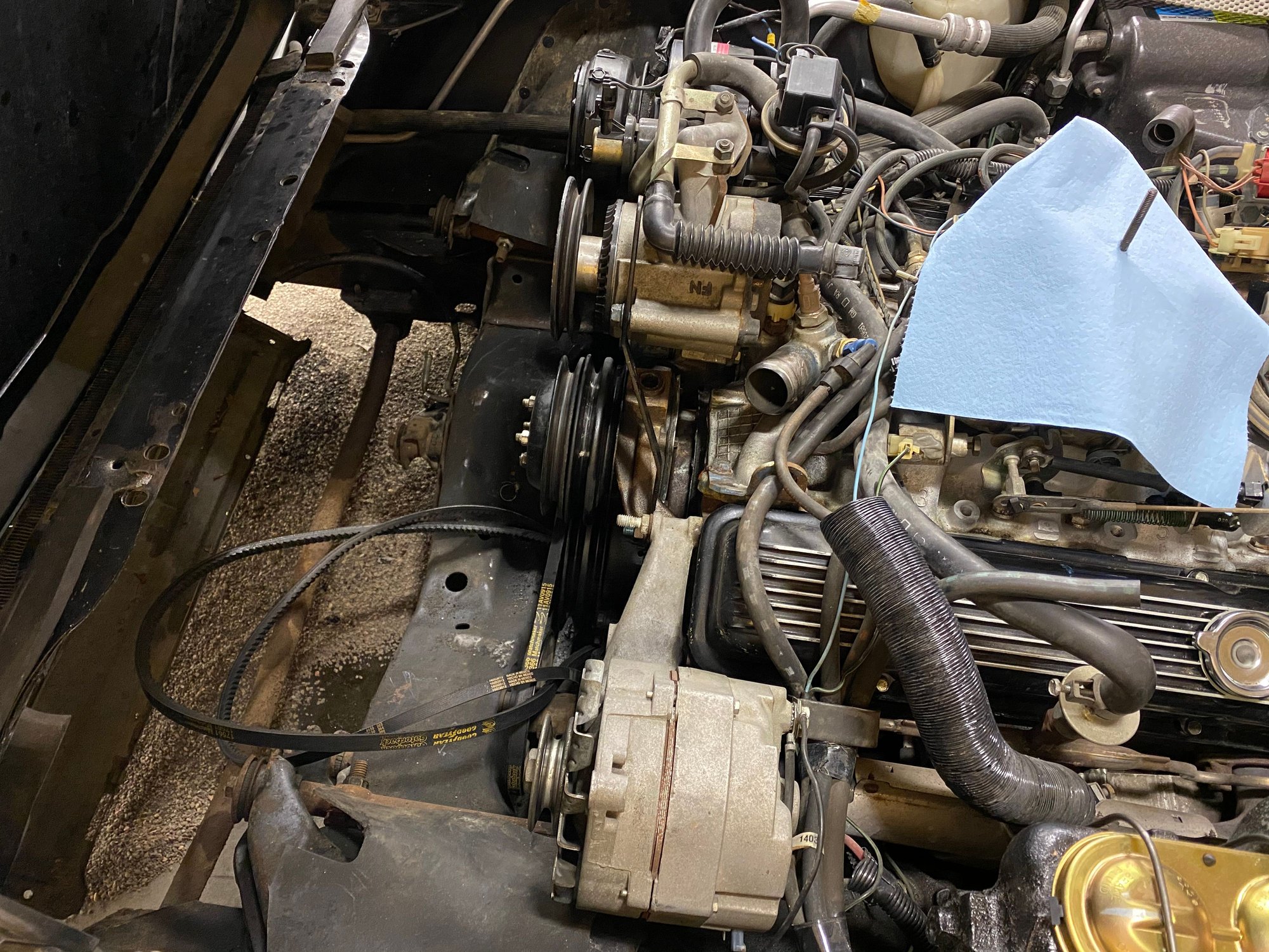

So after pulling radiator figured it would be good to replace water pump. Do you have to remove the AIR pump too? Assuming the thermostat should be replaced while at it, would stock be 195 and will going to say 180 mess with the computer? Thanks

After looking inside my original radiator I figured why not, everything is wide open now so time to deal with it....Its 40 years old! The AIR smog pump must have to be removed as well, tomorrow will tackle that

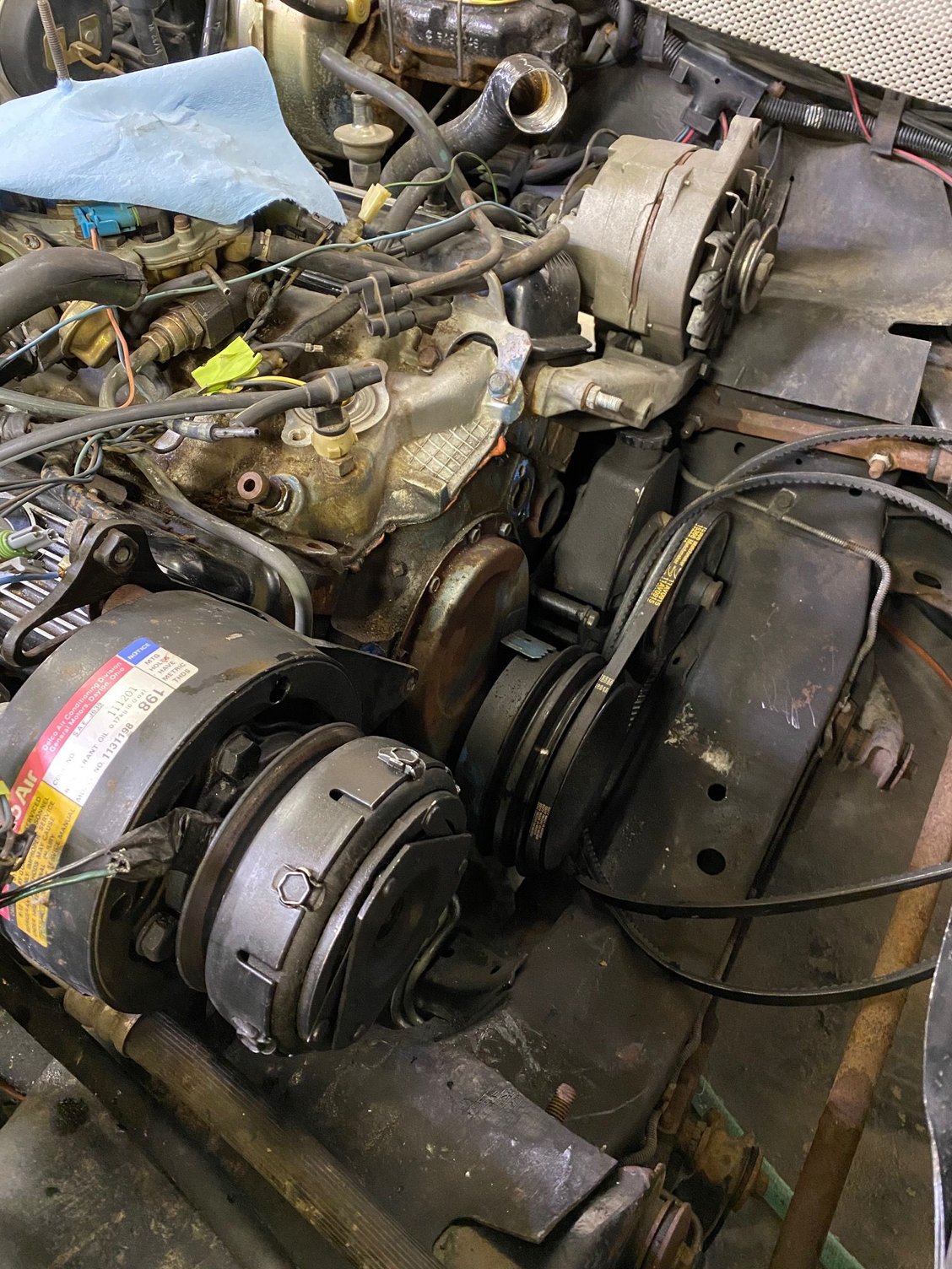

Water pump out, ...impeller didnt turn very smoothly on it. Took the smog pump off and bracket and thermostat housing, putting a 180 in it once all is cleaned up. Two plugs from smog do what again? If I don't put the pump back on can they just be wired up and hidden?

I just recently took of my smog pump on my 80. Got 2 cap plugs at Home Depot 3/4" for less than $5. Without the plugs it will be very noisy.
Jim
