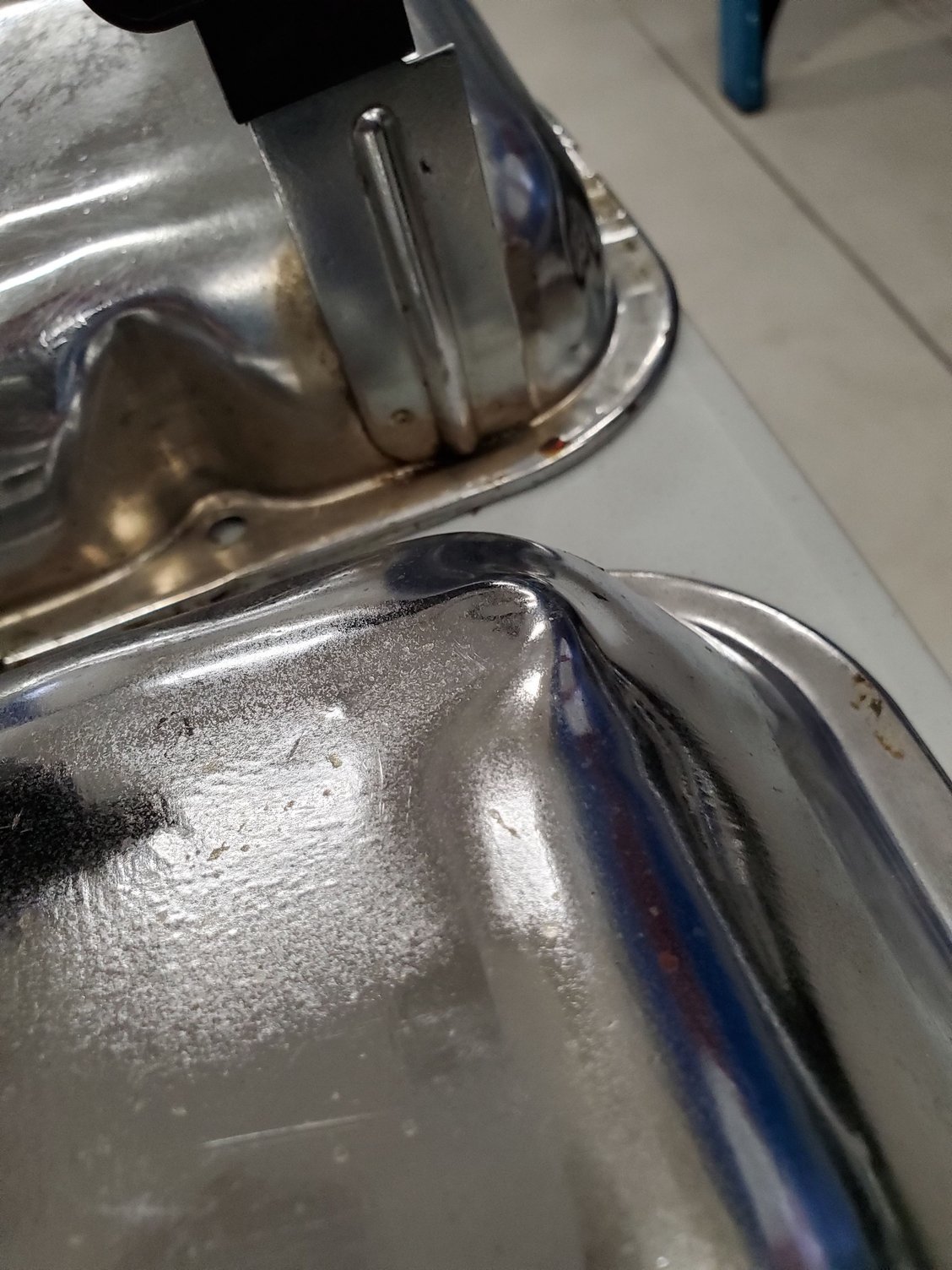

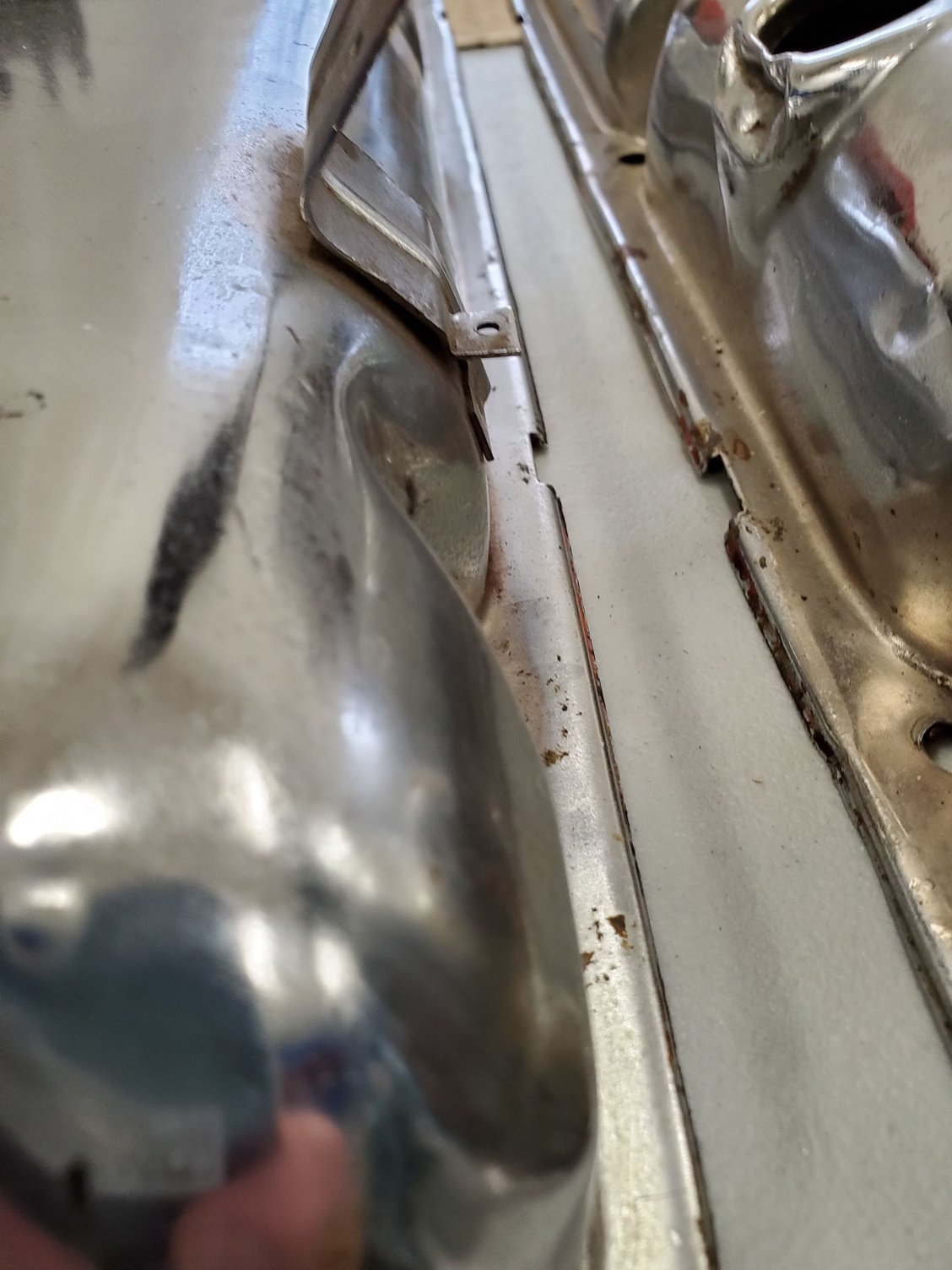

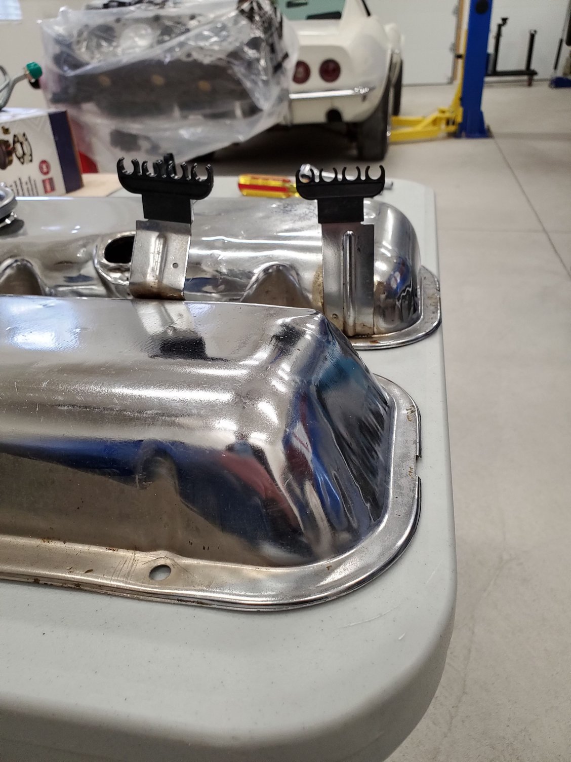

thanks for the input, looking at mine they are the correct OE ones for my car as you describe as the second design, and appears to have a throttle return spring tab on the dr side cover
