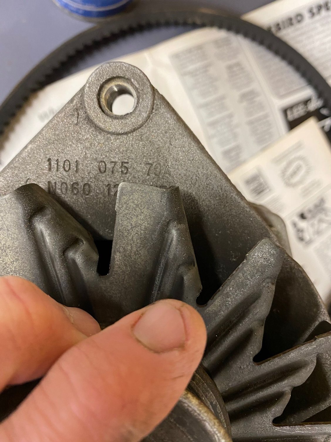

Anybody have the date codes to check my alternator? My 81 was built November 14, 1980, wondering if this is the original unit. The numbers are: 1101 075 70A N060 12V neg.

November 6th 1980

PJO, N060 is it? Cool, appreciate your input! Thanks

1101075 is the correct OEM 70 amp alternator for an 81 with air conditioning & rear defogger. Cars without rear defoggers got a 63A alternator numbered 1103103.
