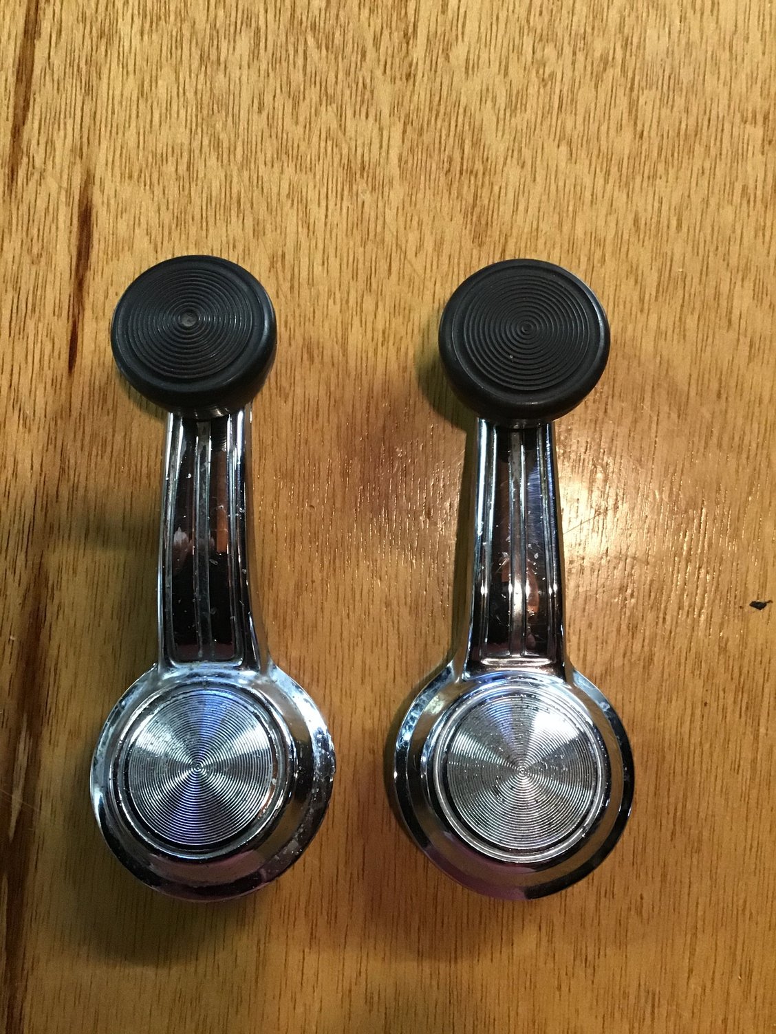

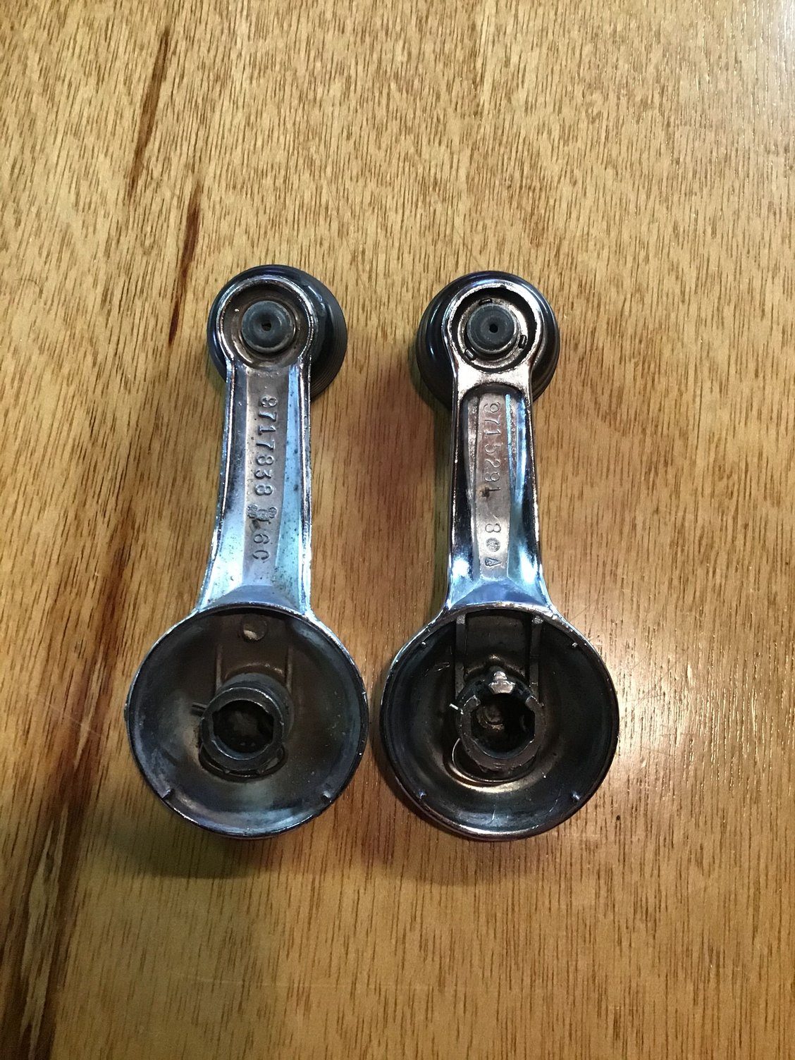

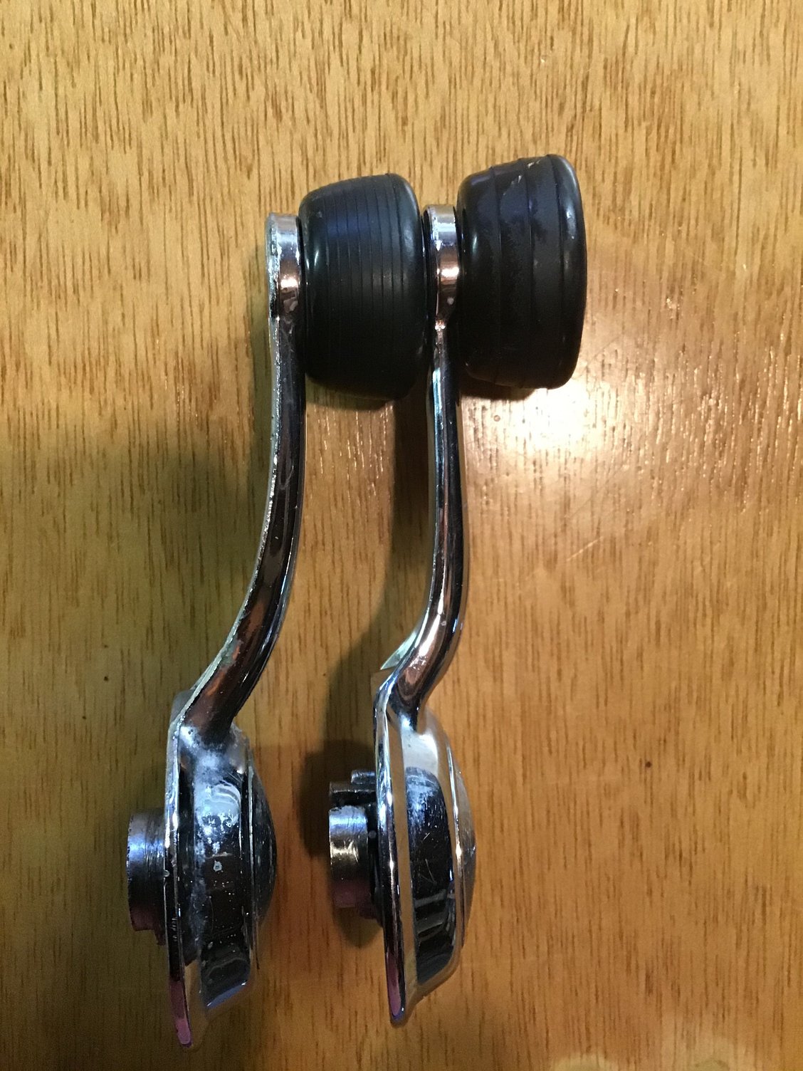

Pulled off the cranks to get at the locks to re-key them. Noticed they were different and wondered what is correct. Attached are 3 pictures to help better explain. Driver is on the left, has a black **** and part # 9717838. Passenger is on the right, brown **** and part # 9715291. Both are cross referenced as Corvette parts. Note the passenger one has been cut into and is pretty screwed up and will need to be replaced.
Per the AIM the part numbers should be 7752485.
Not sure what’s going on here and what’s stock. Did the stock ones come in brown to match the tobacco interior?
Side view shows slightly different profile
Back view shows ***** to be riveted on
Front view shows slight **** difference and color difference is hard to see

The first number, 9717838, shows as a generic Chevrolet/Pontiac handle, not Corvette specific used for about 6 years starting in 68 and it is a casting number not a part number.
Second number, 9715291, is also a casting number not a part number and comes with various color ***** and is used across a number of GM vehicles.
Maybe someone else will chime in with a 68 NCRS background to help.

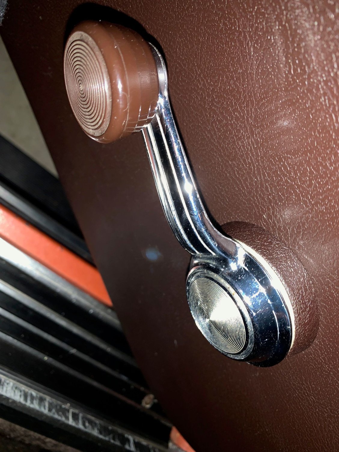

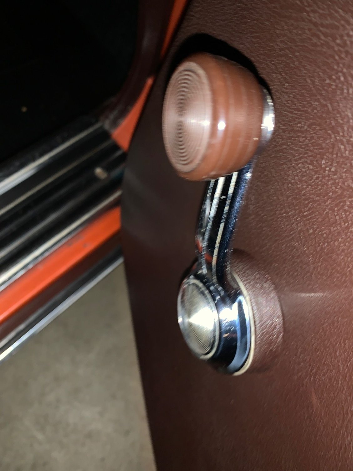

Sorry for the delay. Here are the original window cranks on my 68 with Tobacco interior. I had them off once but didn't record the part numbers. It's a mid April car and entire interior is original including carpets, seats, door panels, dashboard , seat belts and soft top. If I ever take them off again I'll be sure to document them better.

Nice pictures. The one I have that is brown appears a bit darker with the same stepped ****. Maybe it’s the lighting.
Betting the cast number is 9715291. You might be able to confirm using a mirror.

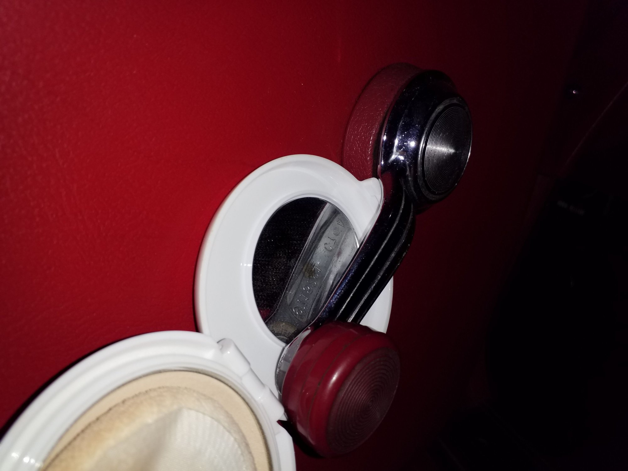

I'll try a dental mirror later today

I have collected window crank handles from 68's through the years. My observation is that the one on the right is correct for 68. Its actually a 68 only thing. I believe you will find it on the passenger cars as well. If you notice, it has slots formed into the area where the shaft inserts. That was a design flaw. I don't know why they did that. I would not be surprised if the one on the left came off the drivers door (was broken and replaced because of frequent use) and the one on the right (with slots) came from the passenger door, maybe less use and survived the years.
Anyways, they either cracked near the slots or they sort of spread apart and got real loose on the shaft. I mean they would get so loose they would fall off! Not good. If you look at 69 and later style, they get rid of the slots and solved the problem. I have a few of those 68 hanging around that are blue. 1967 is completely different and 69 solved the problem.
Finding 2 of the 68 style that are in usable condition is a challenge.
Good luck with the project.

Thanks so much for your info. This is exactly what I thought but couldn’t find anyone with a 68 to confirm. Would agree the drive side might have been changed based on higher usage.
Rarely see any of those 68 only cranks with those cuts in the shaft. At first I thought they might have been cut from a previous owner. Then found one on eBay with a green ****, but the seller couldn’t verify it was from a 68. What are your thoughts on its ability to be painted tobacco?
