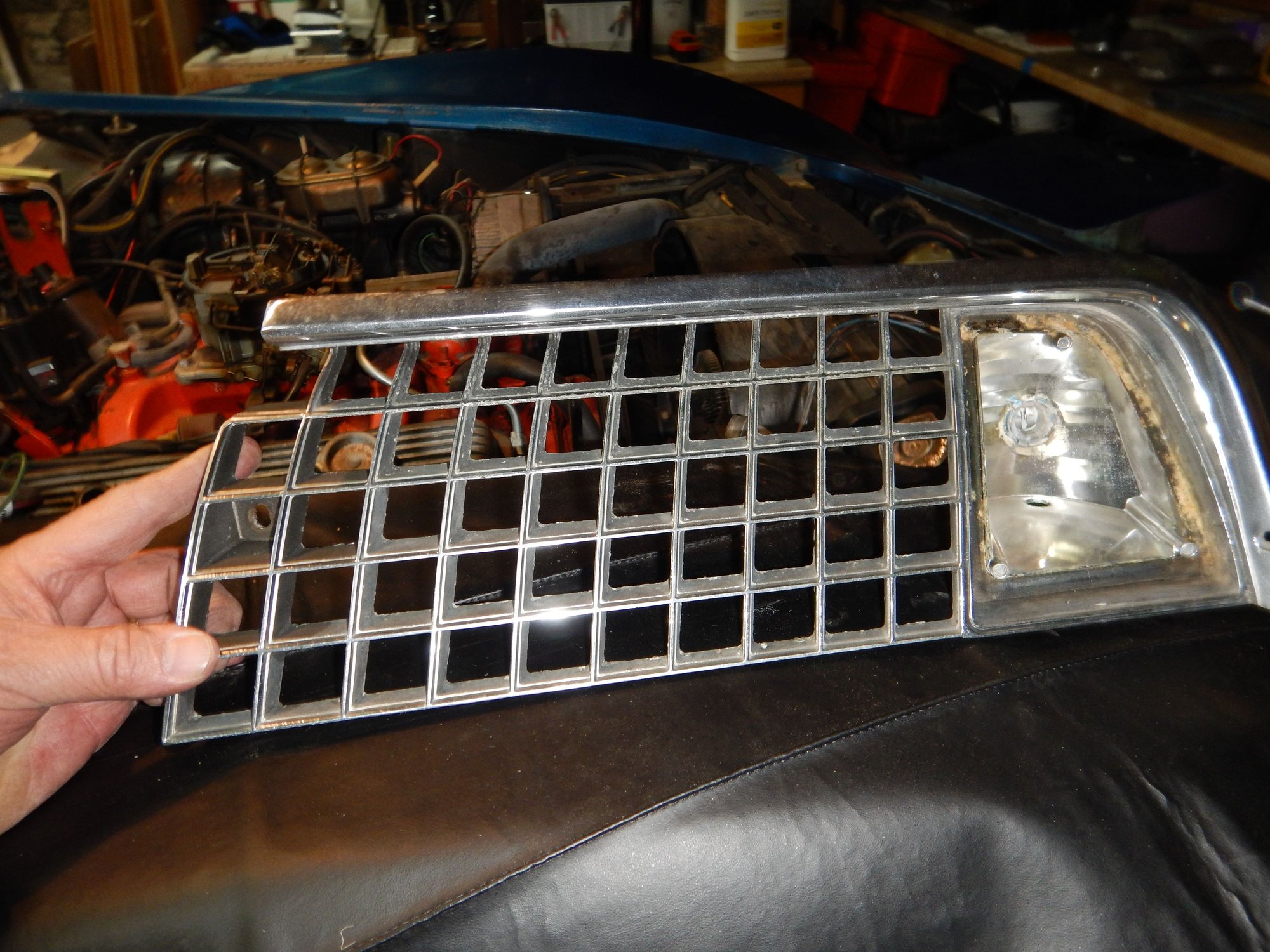

Now here is issue #1 with the 70 today. A simple thing that turns into a problem. I went to replace a RH Parking Light Bulb with a new 1157A. Should be pretty easy and straightforward. First I found one hole with a screw snapped off in the casting, one hole with a Wood Screw in another hole and one original screw all to hold the lens. So I cleaned everything well and cleaned out the reflector area. I removed the bulb socket,from behind whose gasket crumbled in my hand. Also I did not know the Parking light was moulded as part of the Grill Assembly! Surprise! So what is the best way to attach this repair? I tried drilling out the screw, but the Screw steel is so much harder than the surrounding metal, that doing this on the car is difficult. I got a hole started in the center but it now seems that even new drill bits are doing nothing. Should I remove the entire grill to work on this? Or is there some other suggestions?

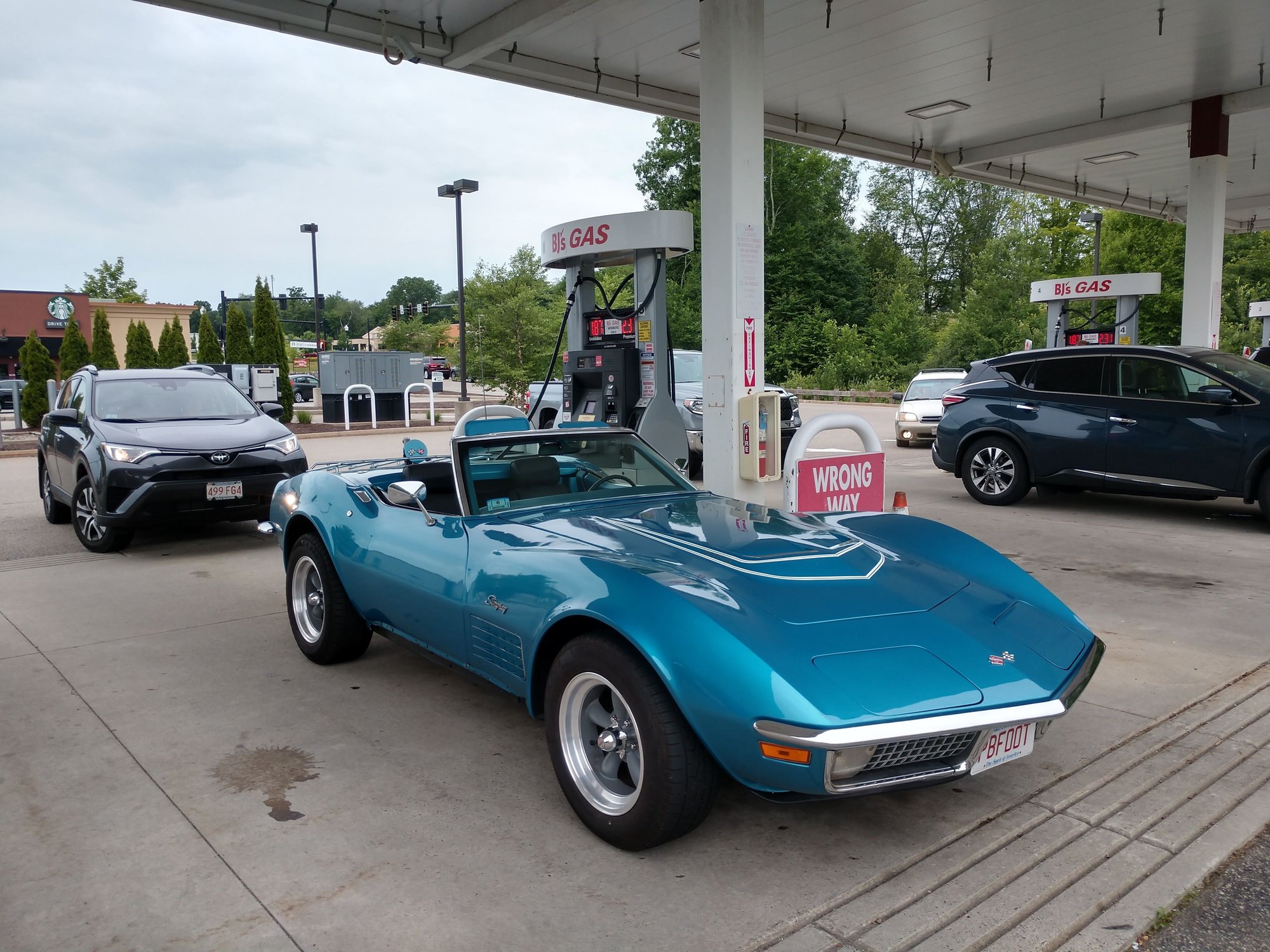

Beautiful car! Enjoy! My 1970 454 is just a little younger with a birth date of 7/28/70. And, I’m in Melville, so we’re practically neighbors.

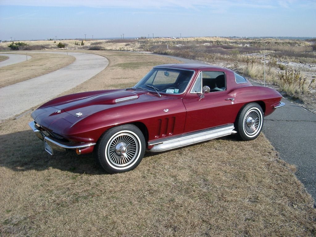

That's great, you are about 5 minutes away by Corvette! I am very new to the C3's. You have a beautiful car! You and I also use the exact same spots to photograph our cars. Your picture is looking west I guess, My picture below is looking east from around the same area except with my another member of the family. In fact the car below is with me for 46 years! I even had my first date with my now wife in this car! I still have both ! I always wanted a C3 and this seemed like the right one! I look forward to meeting you someday in the future.

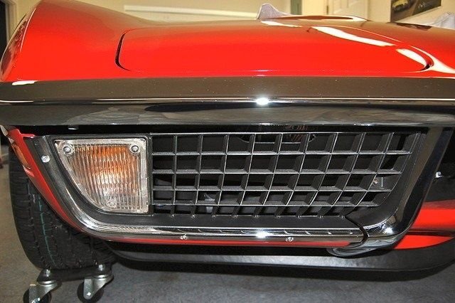

Scott post a new thread regarding this issue as it will overlooked here for other opinions. If you don't have a good quality Assembly guide, buy one before you do anything else. Take pictures of what your currently trying to fix so you know how it goes back together. Needless to say your car being 50 years old hard to know what has been done or not to it and it is fragile believe me. The screws you speak of you maybe be able to use a penetrant and let is soak overnight ( be careful of the spray use rags to protect surfaces) it may allow you to extract it but be very careful as the grills if original are priceless only copies now made. If you feel in doubt you can carefully remove the grill and maybe a machine shop extraction is best.
I'm rebuilding a 70' from the ground up........be careful and think all things through or it can get expensive in a hurry.
This is Alan71's front lens

Thank you, excellent advice. Disassembly is next. I'll review my plan with the grill off the car.
