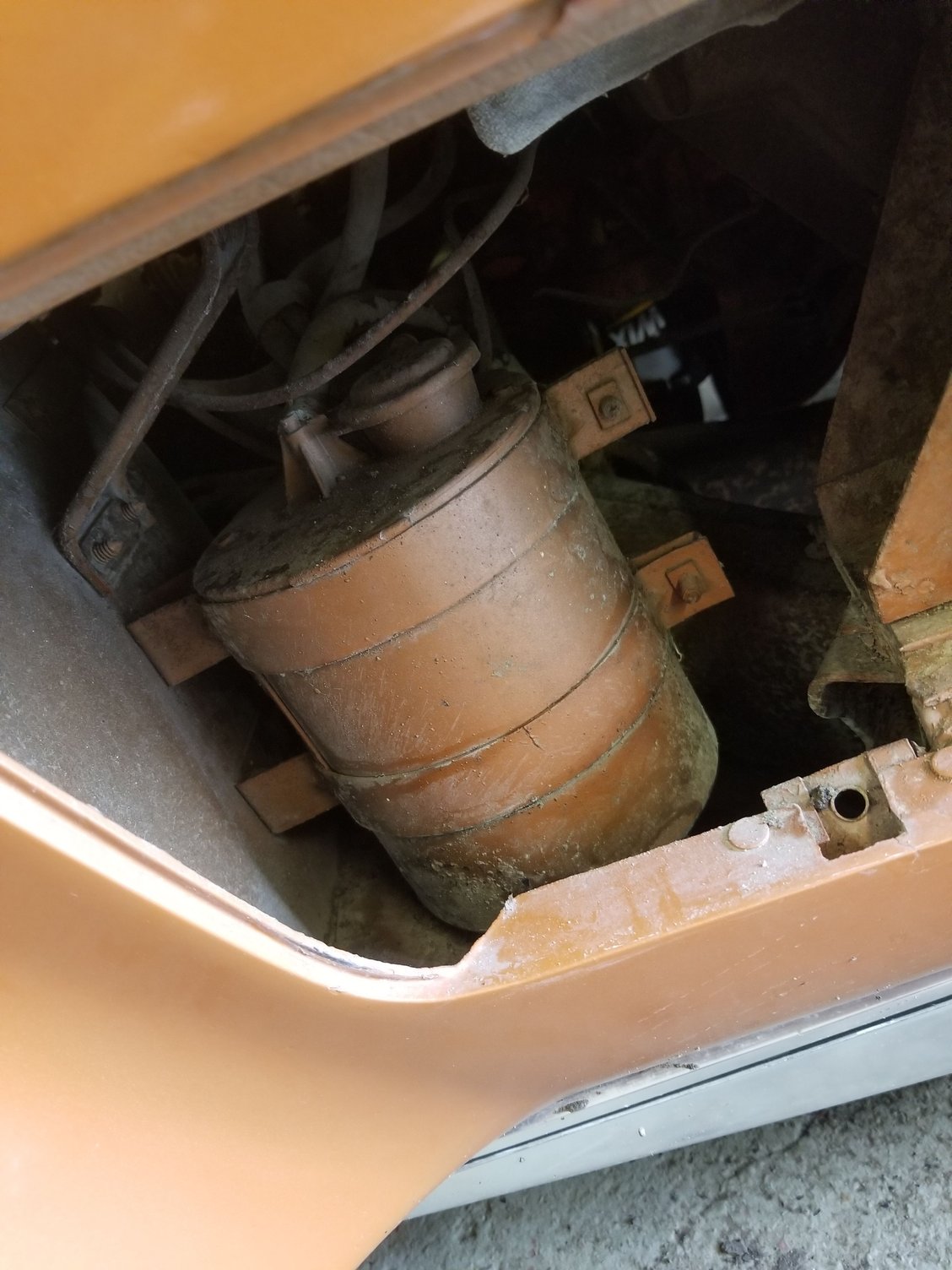

Anyone know what this tank is for on a 1972 LS5? I have 2 separate vacuum lines from my carb going into it. It's mounted right below the main vaccum tank.

Charcoal canister, absorbs gas fumes from the fuel system.

Yep, contains charcoal to absorb fuel vapors. You should have a steel fuel line running along the frame rail above the brake line. It is also connected to the canister with a rubber hose. The engine vacuum pulls any vapors from the canister into the engine to burn it off. It was an early way of capturing fuel VOCs and is necessary if you have the non-vented gas cap; it doesn't use any engine power to operate and is a good idea to keep functional.

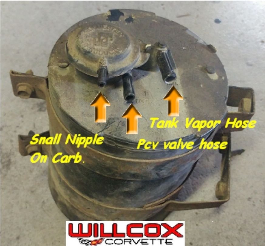

Here's a picture from Willcox showing the hose configuration:
1972 Corvette Fuel Vapor Canister Hose Connections
