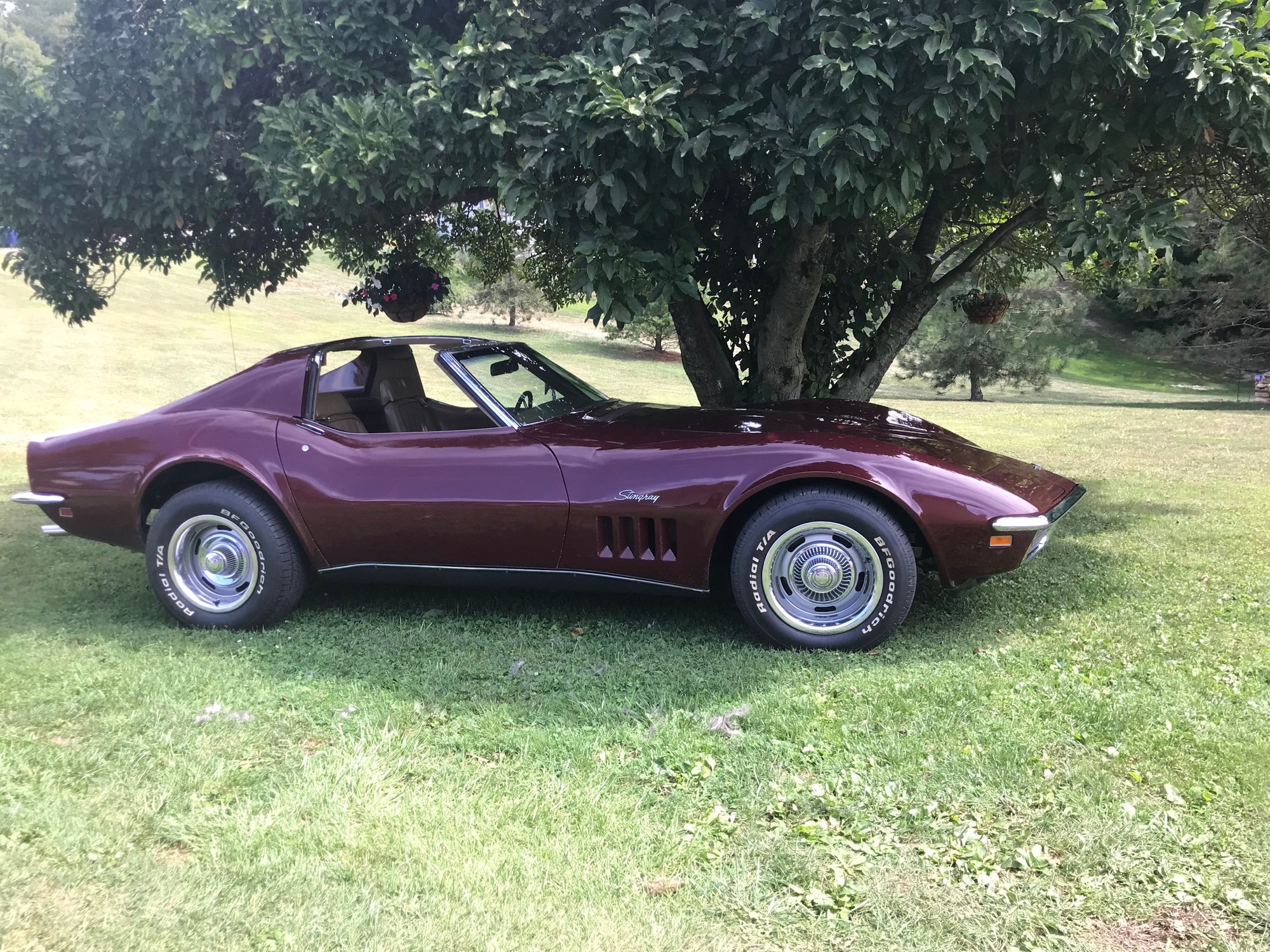

So my dad put a new 9 leaf rear spring on his 1969 corvette back in 1991. The spring sat so high that going down the road it would buck and try to spin, so to fix it, he put longer bolts on the the ends of the spring (10 inch). it lowered it and is driveable but even after 30 years it still sits 3 inches too high. Should I get another spring off zip corvette or have this one re-arched for better fitment. I would like to get the original bolts back on it due to the spring being only 1/4 inch or less away from tires.

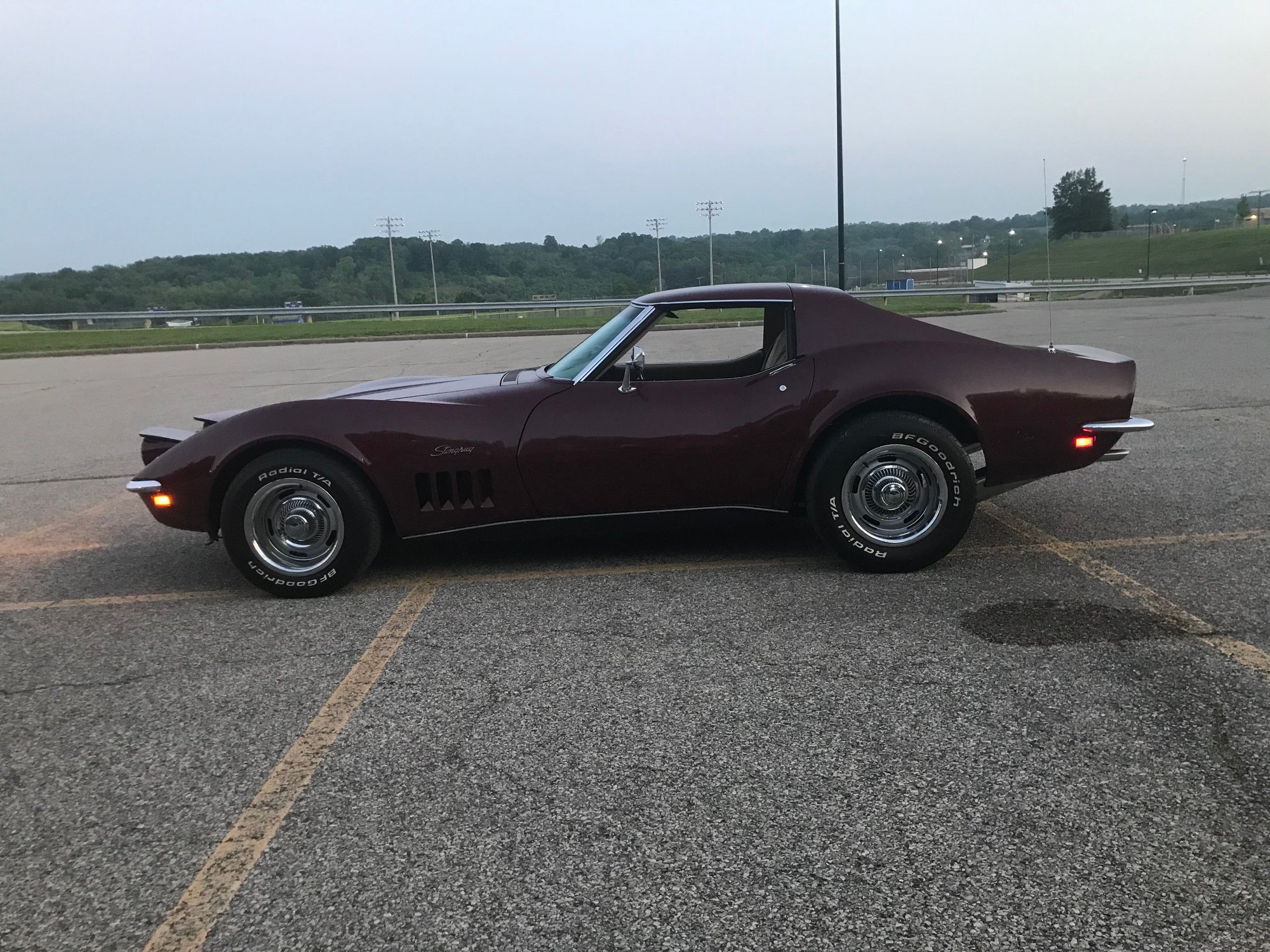

i have added some pictures of the car so you can see the height of the car.

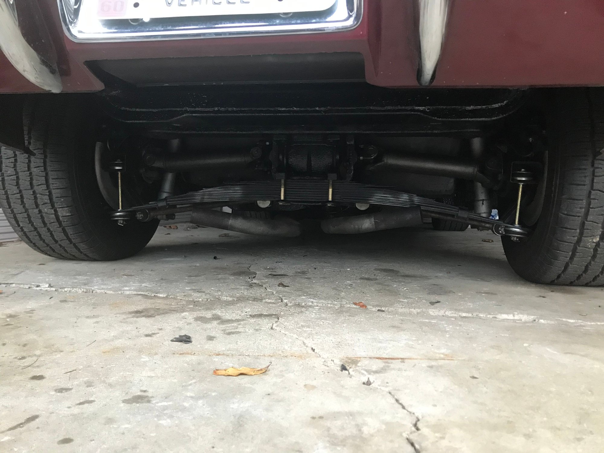

Can you post a few pics of the spring, its attachment at the differential and the outboard ends with the bolts and hardware? It sounds like the spring is inappropriate to the installation or something was added that is way out of whack compared to stock.

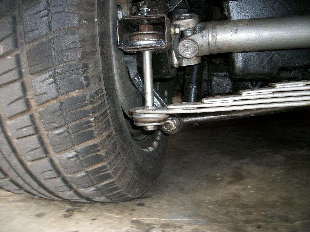

OR....You can invert the bolts so that the head is on the bottom and the extra length is inside the trailing arm, which looks much cleaner....
You can see the bottom leaf with the bolthole is beginning to fail/reverse-arch. Later I bought a spring leaf and modified it to fit the Vette springpack. The original main leaf that was failing was replaced with the modified main leaf.

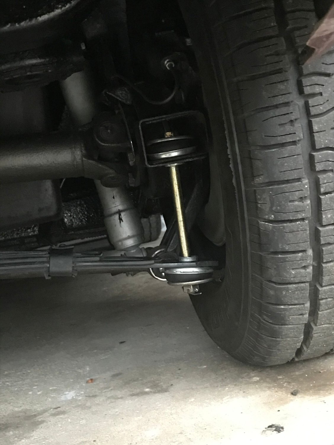

here are the pictures you asked for, dont mind the paint on the spring 😳. Its overspray from me marking my exhaust.
