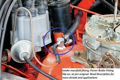

Hi Tommy, welcome to the forum and congrats on the car!
If you can hear a vacuum leak try checking the main vacuum port at the rear of the carb. I've seen these pop off before. This could cause your high idle situation.
Share some pics of your car.
Cheers, Greg
