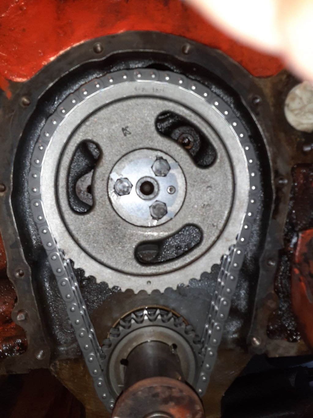

I was lucky, on 9/24/2020 my '71 LS5 was idling on the driveway when the original timing chain/cam gear failed. Yes, the engine will quit running! If you are driving, I would suspect that severe damage would/could occur to pistons, push rods, valves, etc.
If you think your '70 has the original timing gear set, replace it ASAP!
Original GM crappy timing gear
New Cloyes double roller timing gear set
