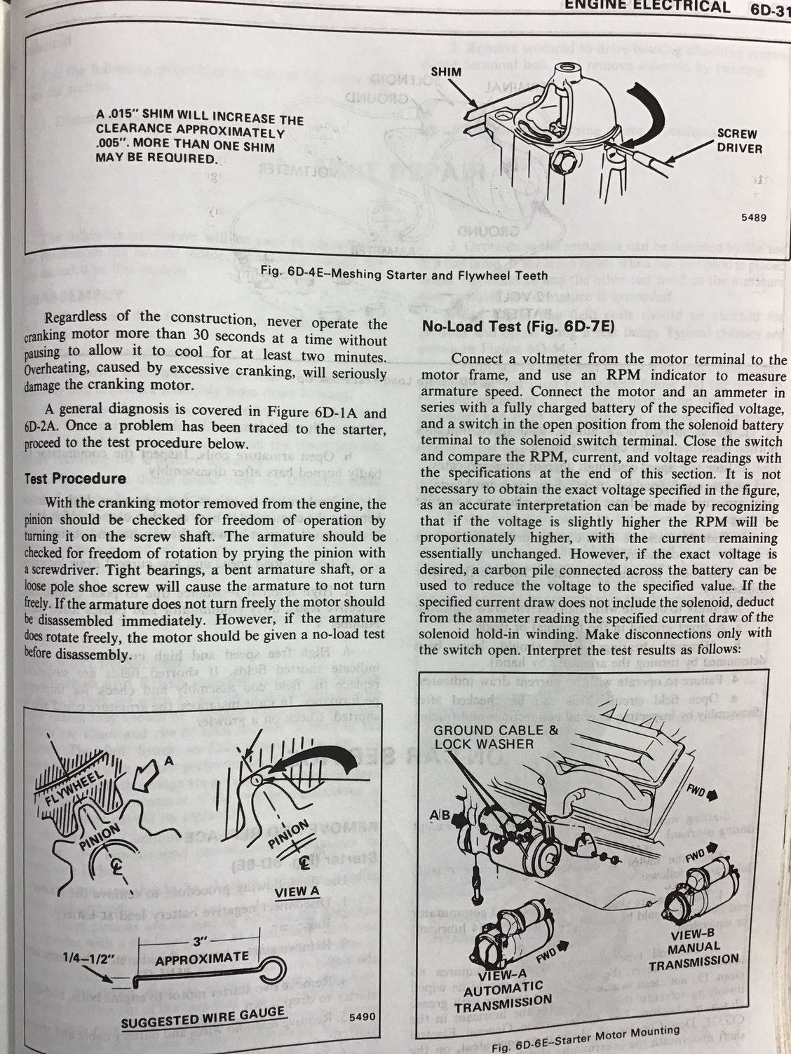

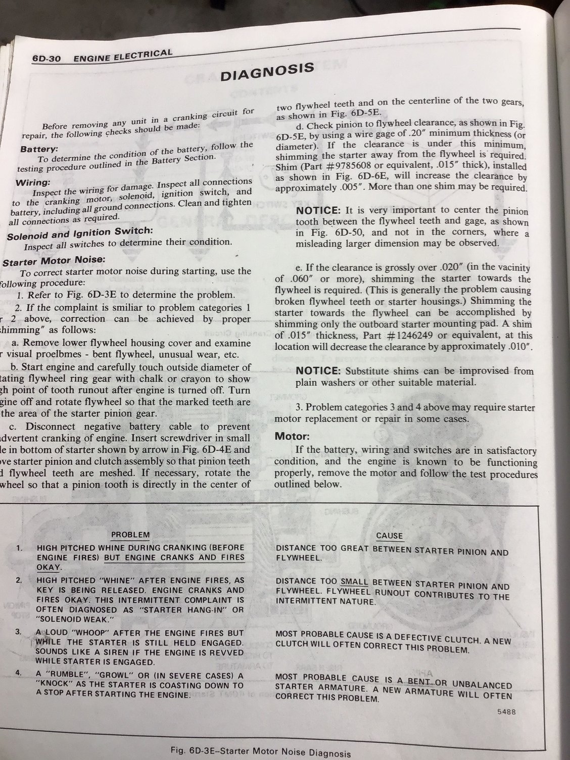

Mine was a bad bushing..listed as #4
https://www.corvetteforum.com/forums...-starting.html
manual quite accurate

I removed the starter and took it to O'rielly's to be tested. The starter tested OK. When I installed this starter, no shims were used because the OEM starter didn't have any shims. When I reinstall the starter I will check for need of shims. IIRC the battery voltage was low when the bendix did not fully retract. Don't know if it would cause the problem.

take it apart, check shaft for smoothness and straight..check bushings in nose..these are pretty simple
pic helpful too..some n here helped me with solenoid identification and preference..also check smoothness of solenoid

Finally got back on this. After having the starter tested I reinstalled without shims. Per install instructions I have the correct 1/8 inch clearance between the armature shaft and tip of teeth of ring gear.
The battery is charged at 12.5 volts. When starting(ignition is off) it acts like battery is low, 1 or 2 revolutions and then just a few clicks and silence. The bendix has not retracted. I can easily push back with a screwdriver. Doesn't seem to be binding. Any ideas?
