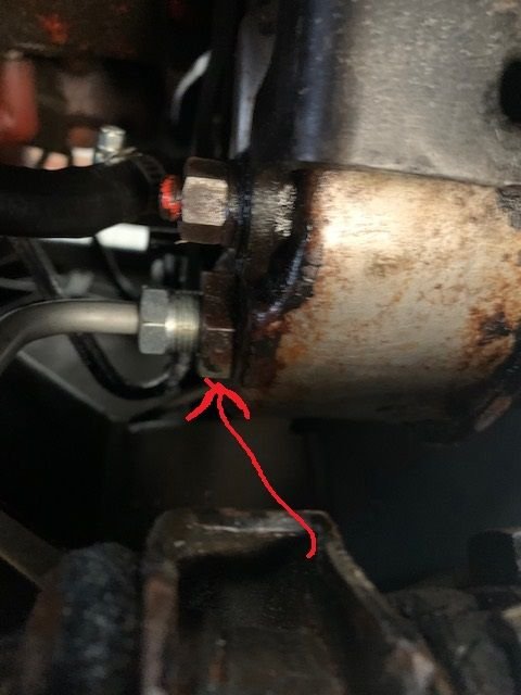

So a friend and I looked over the car and there appears to be a leak in the power steering. We think we pinpointed it to this nut on the power steering pump. My question is there an "o" ring on the inside of this nut between it and the pump?

On some years yes, they have a tube that has a ridge between the nut and the end of the tube. Others just have a flare on the end of the tube.

Use a flair line wrench to remove that line. See if you can dig out the "O" ring with a dental pick.
As I recall, the mounting studs also have "O" rings too. Because the stud goes directly into the reservoir, potential leak.

When I changed the hoses on my 73, the pump fitting was the only one that didn’t leak. I read from one member who suggested loosening the fitting a tad, then retighten it and wait to see if it leaks. This worked for me, until later on when the valve started leaking. I had the service shop replace the valve, as the new valve has to be centered and the process is to start the engine with the front wheels off the ground. Seemed like that would be asking for trouble without a lift.

Yes there are o'rings at that fitting. Here is a detailed instructions on how to rebuild the pump.
