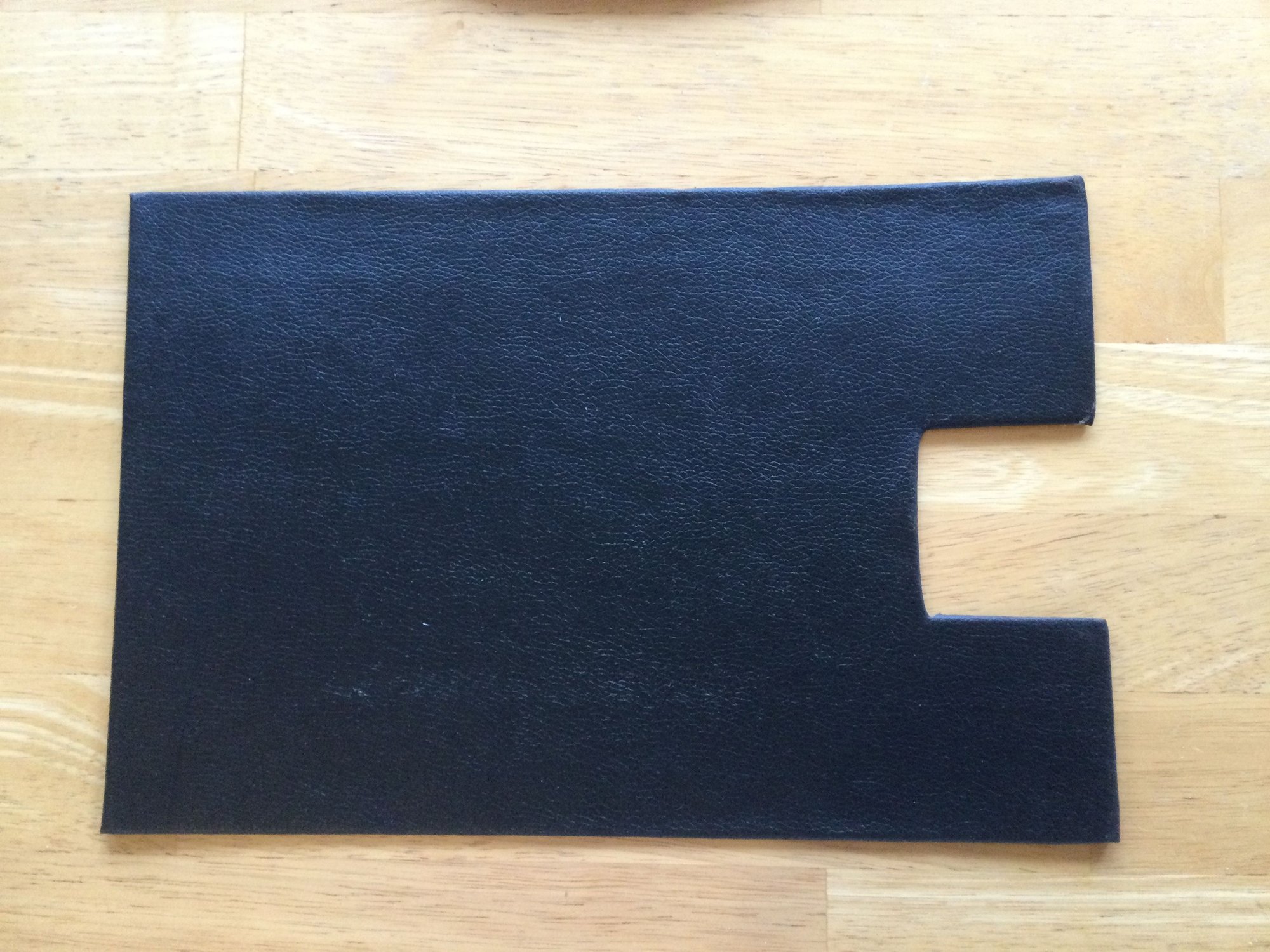

Here is a picture of the plate covered with a piece of vinyl that keeps the threaded shafts (on the hard top) from scratching the rear deck.
The cut out section goes around the chrome receiver on the rear deck lid. Inside against painted rear deck, remove plate after threaded shafts are in receivers.

That's a big help. I will try to duplicate. Thanks again for your help.

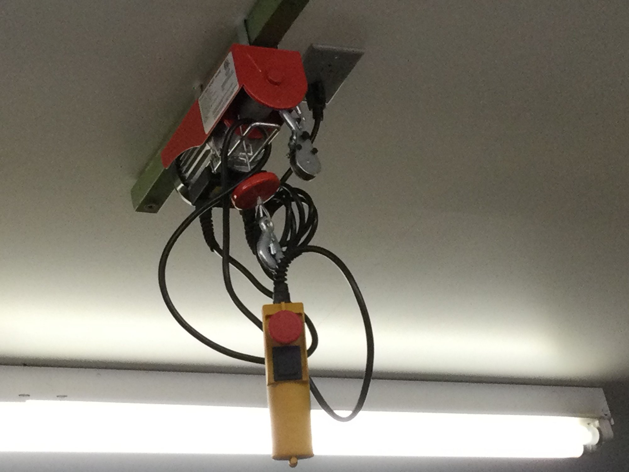

Here’s a picture of my lift,although I haven’t tried it out yet.
I also changed the rear studs out for the convertible pins.

I have that same hoist on my trolley system for my engines. Works great but it operates at a higher speed than I like, so I added in a couple of pulleys ( like a block and tackle) to slow the travel. It was easier than trying to find a new switch with speed control

I think of you double up the cable it will run slower.
