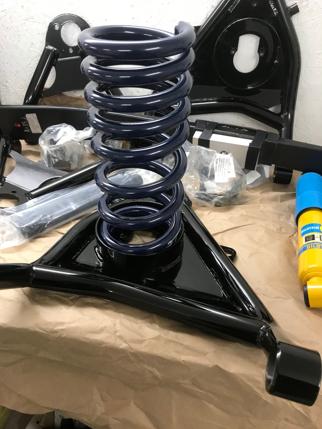

hello all . going to install my suspension next week end . my question is do i need to put some kind of pad on the lower control arm or are the coils direct to metal . i have the rubber isolators for the top of the coil

I do but mostly to avoid squeaks. I use a thin strip of old bicycle tire tube.

Hey kev, something like this? https://www.steelerubber.com/front-c...pad-70-2302-35

GM never used them. When installing the springs, make sure you index them correctly to the top of the frame pocket. The spring edge should be within 3/8" of the inspection hole in the frame. Nice job on the suspension finish. Jerry
