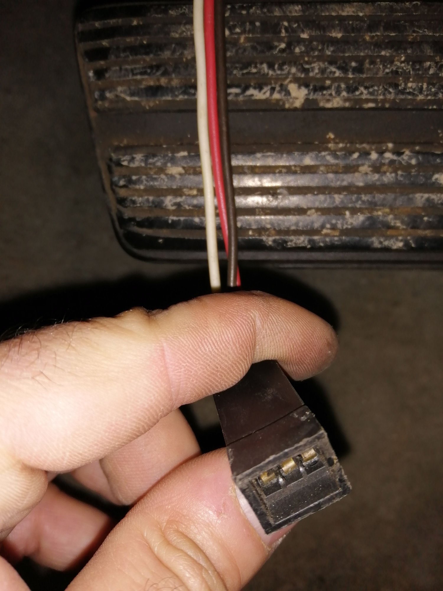

Ok, lets start over. I have got good news.
This red wire that is cut in half and supposed to go on alt is having good voltage.
I dont know why they did what they have done, but I will connect back the way it was and I think I am good. About electric choke I will connect it to wiper yellow wire.
I dont think anything was done to headlight switch because there is no voltage on lps connect.
I have to ask about this black wire, that is having also good voltage, but isnt connected with anything.
And about this two connector under the steering wheel
1.
2.

The 3 wire connector Page 26 C141 C = Connector Number
The 2 wire connector Page 18 C122

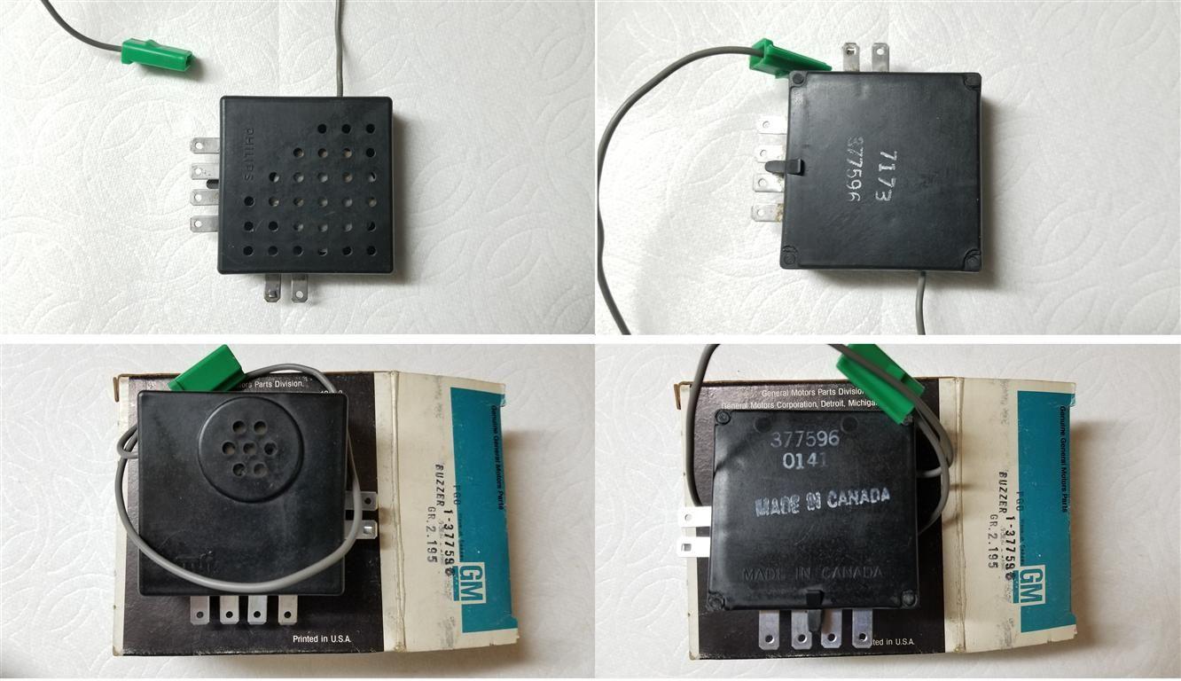

The same Warning Buzzer was used in both the 1977-1978 Models.
They can be hard to find in working condition.
The GM Part Number is 377596.
The New Old Stock (NOS) Buzzers sell for between $40-$75 USD.
The speaker housing may vary in shape depending on the manufacture.
Here are a couple different styles both are the 377596 Buzzer unit.
Good Luck!

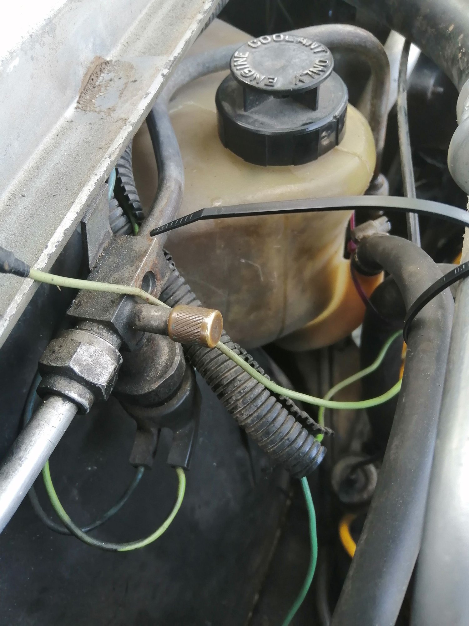

Hello,
I have one more question.
This green wire on picture in engine bay on passenger side.
Quite long, coming out of this tube with one more darker green which goes to ac compressor.
Where does brighter green wire plug in?
Thanks, be well
