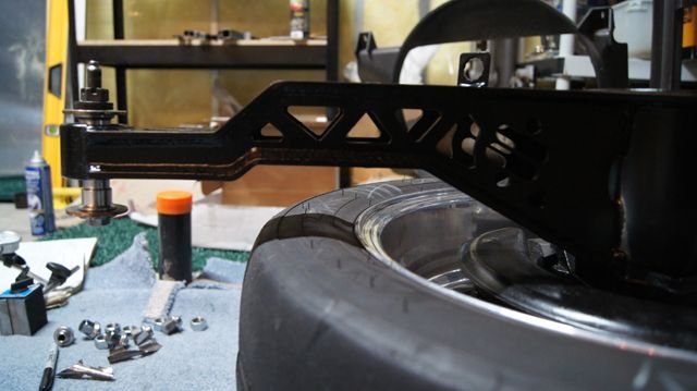

So 275 40R 18 tires will fit on most cars using 4.75" BS Wheels. Factory trailing arms with no mods to suspension.
Here is what a offset T-Arm adds. Allows you to increase the Backspace to widen the rim without changing the fender wheel position. This allows for ~ 10.5 - 11" wide wheel in the rear. which is good for 295-305 wheel.
