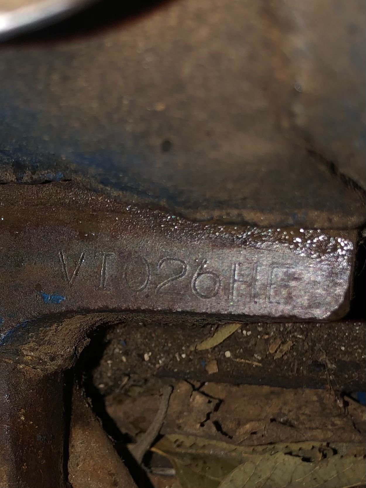

Just bought this 68 C3 and need some help identifying more information. I see on the block the number matches my vin but I don’t understand the code next to it. VI026HE. I attached a pictures.

V= Flint
I026+ October 26th (I used instead of 1)
HE= 327 Base 300hp Rochester Q-jet & Manual Transmission

V is Flint, MI. The I is sometimes substituted for a 1 so the date of assembly is 10/26/67 and the HE is for a 327/300 hp with a Rochester 4 bbl and 4 speed transmission.
