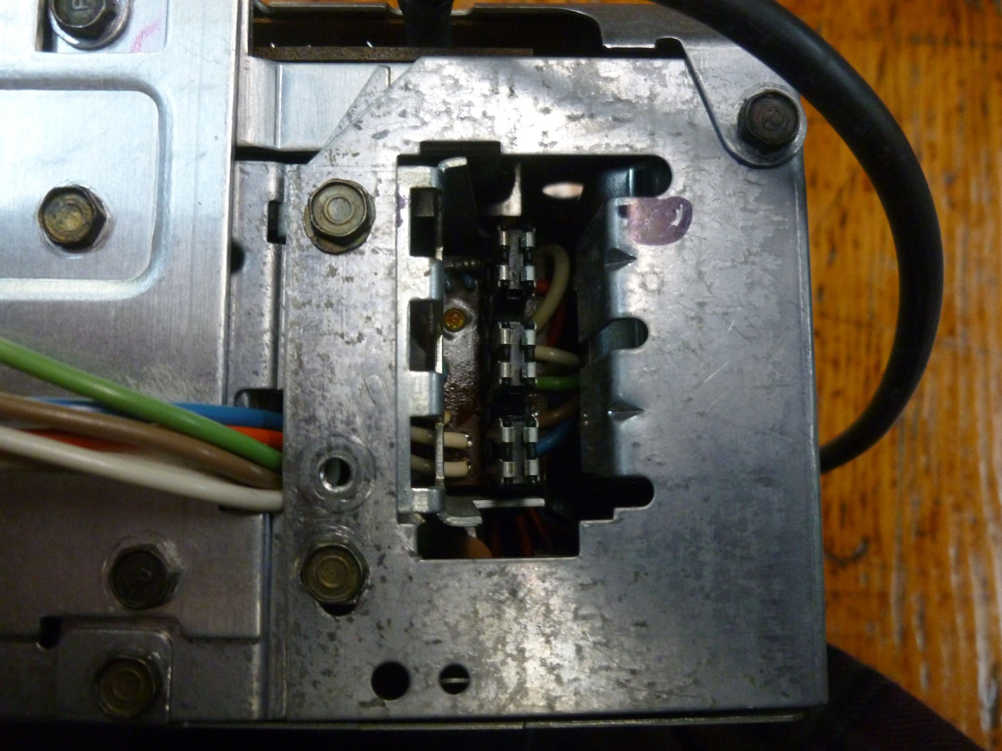

Are there any labels anywhere on the radio? Take a picture of the back where the connectors plug in, that will tell you right away if it has rear speakers.
Here's a 79 AM/FM/CB.

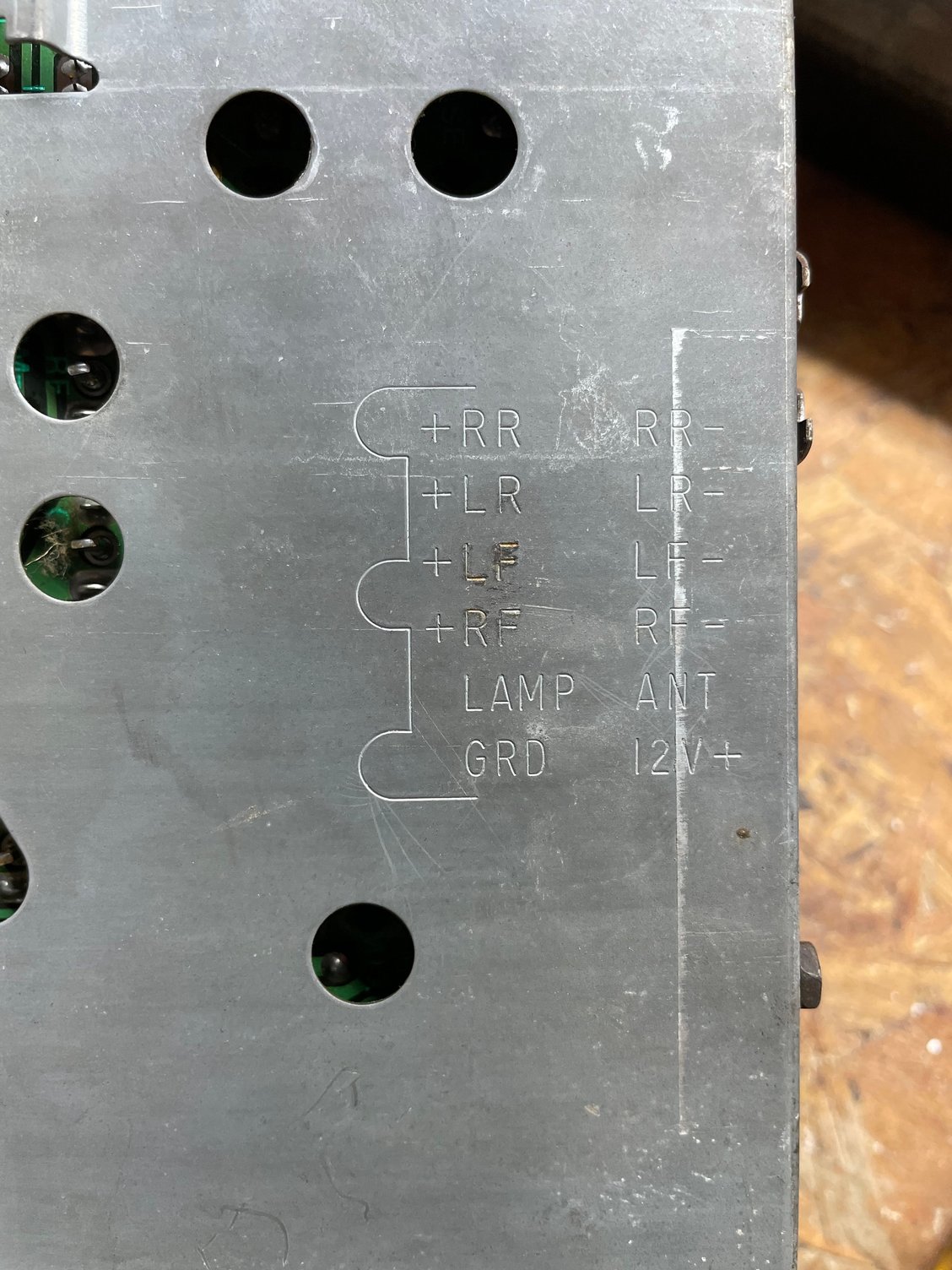

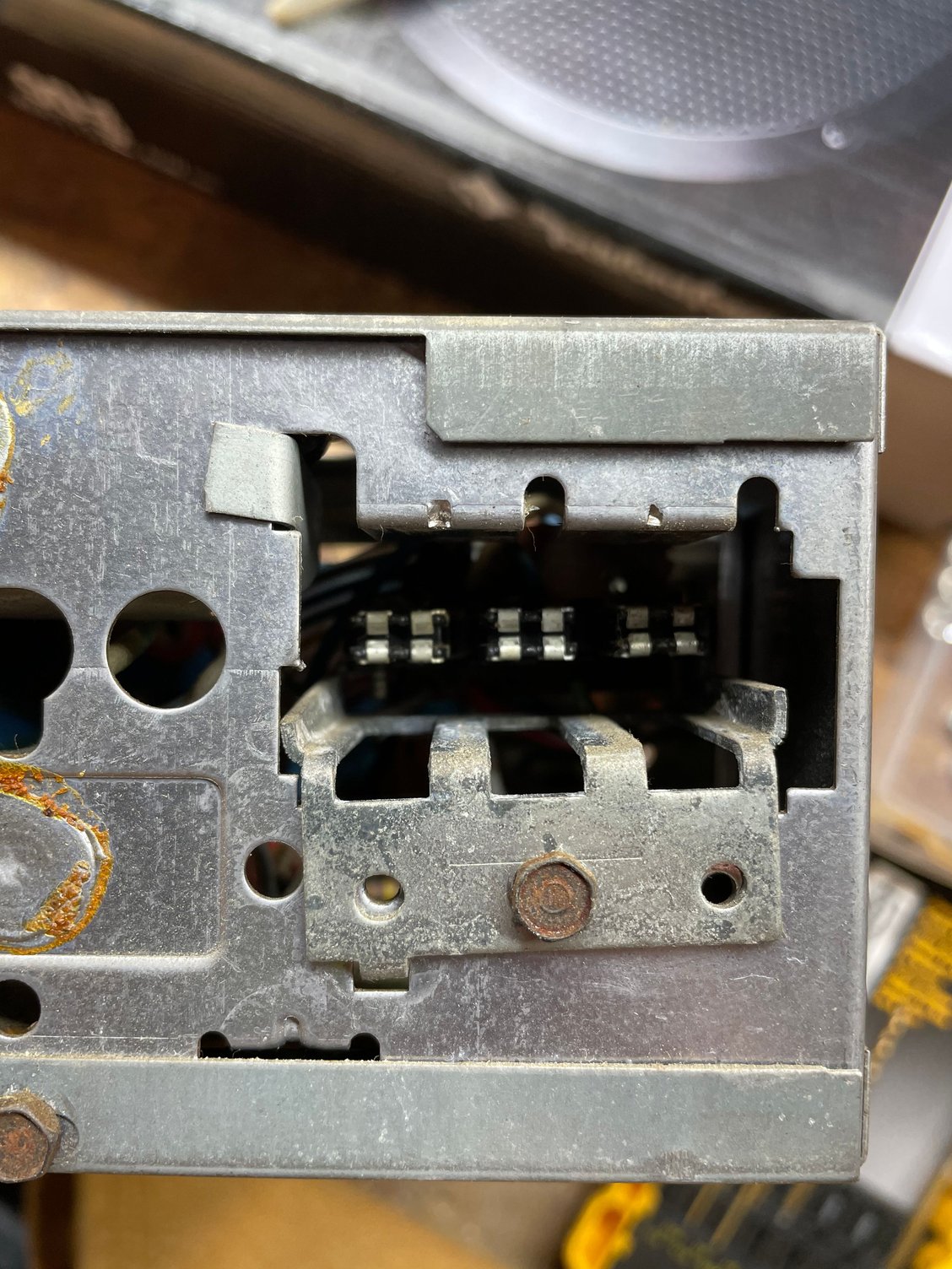

thanks for all the responses. Here are some more pics of the radio I pulled out of my 78. It doesn’t look like there is a fader control inside the housing behind the shaft at all. It does have chrome ***** though. Does this basically mean that this is not the original radio and could that be the reason my rear speakers do not work?

So here’s what I found out, I ran a jumper wire from the plug on the back of my radio for the front speakers over to the plug for the rear speakers and I got sound from the rear speakers which tells me there is either something busted inside the radio not sending power to the rear speakers or the radio is from an older model like I originally thought and it just isn’t compatible with the rear speakers. Either way I just ordered a whole new radio. Thanks for the input guys !
