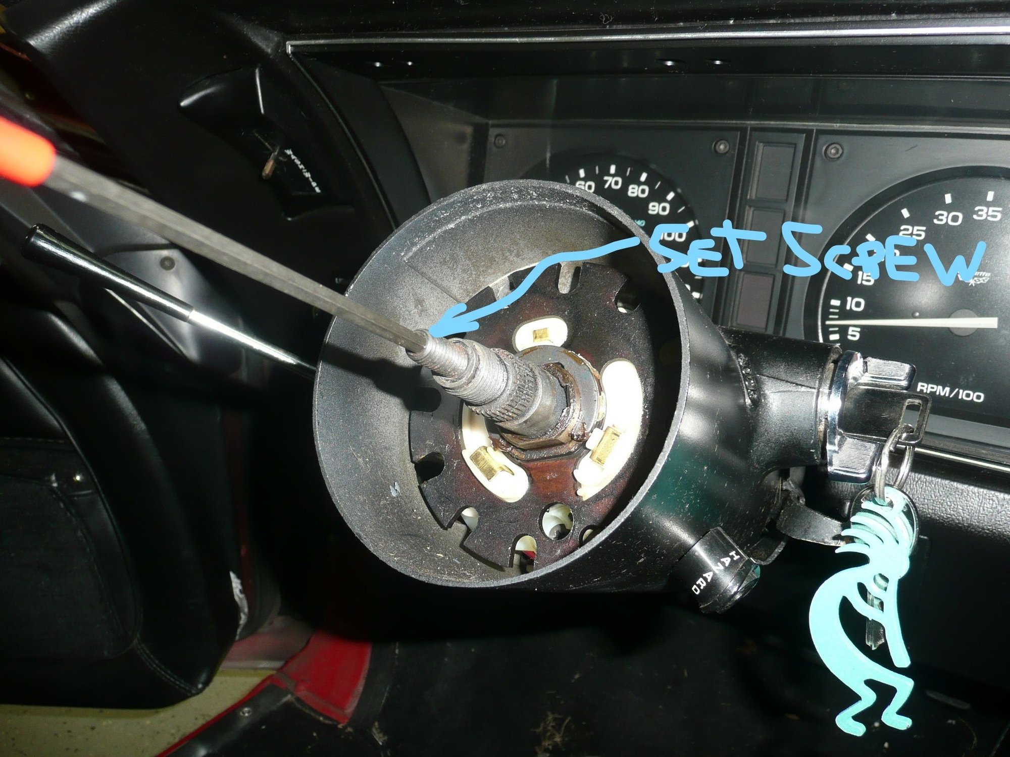

As I recall, you need to install a screw where the tele bolt usually goes otherwise it just pushes back. I used a set screw so it didn't get in the way of the spring compressor tool.
Found a picture.
