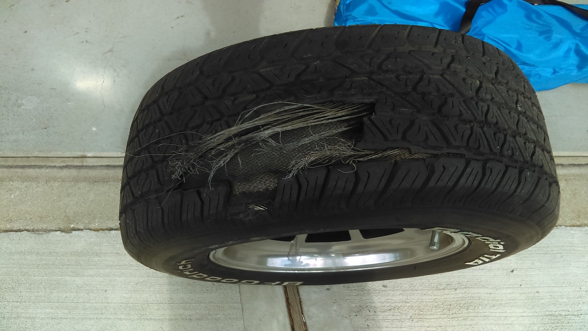

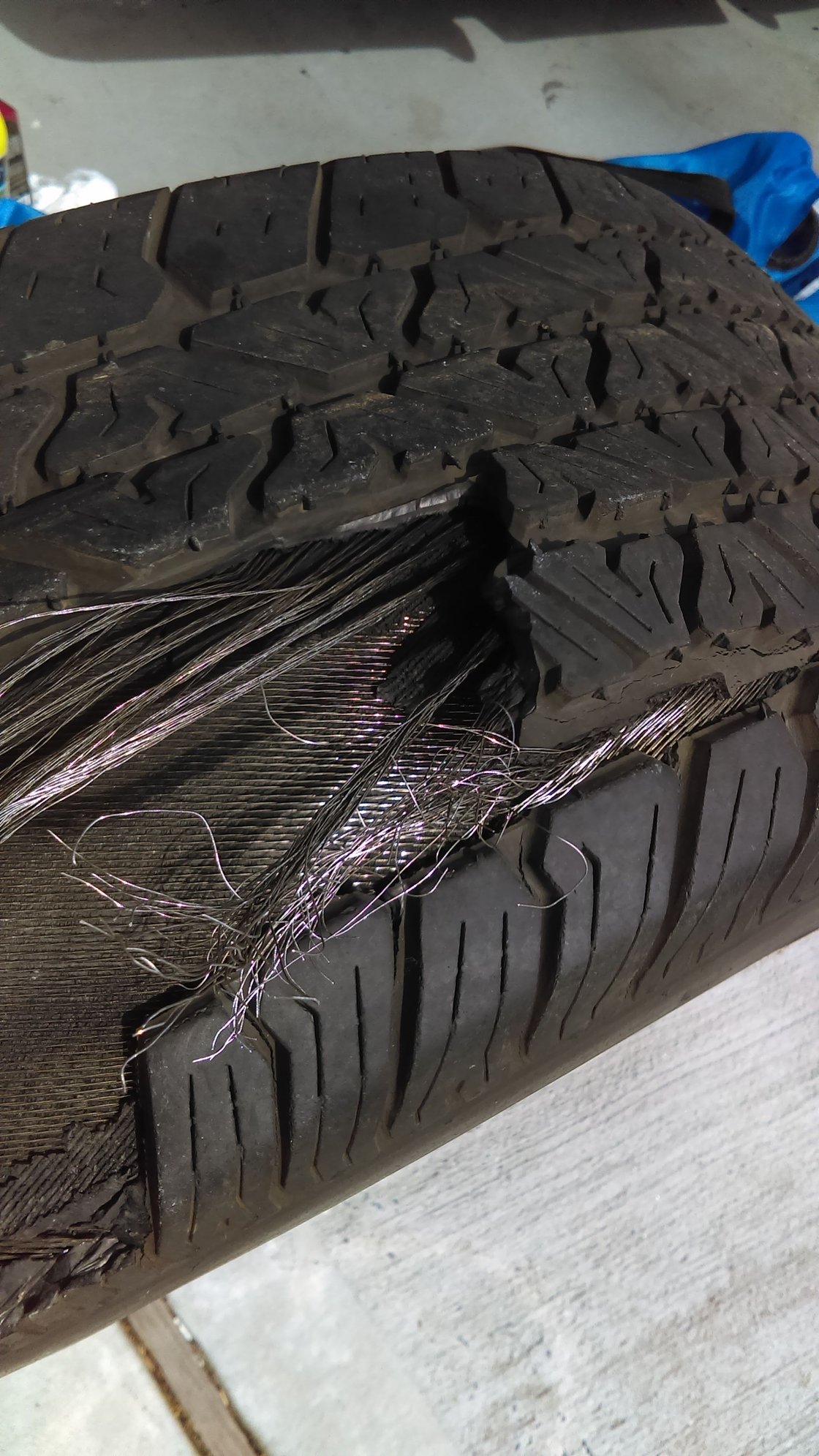

I was down in the shop today working on my replacement frame and wanted to get some measurements from the old frame/ control arms. I have the car on dollies and moved it maybe a foot for better positioning, got down and started popping the passenger side front center cap only to have a large boom / bang/ whatever go off... lets just say I moved real fast. Low and behold the tread on the read passenger side decided to blow off at that moment. After looking at it further, I'm guessing that one of the two plugs failed and air got in under the tread.
Backstory: Tires were new the summer of '93, I bought it Spring of '94, and drove it Summers only to '98... couple of thousand miles. Its been stored since and I'm finally getting around to rebuild her. No idea when the plugs were installed but assume '93. Its been on the dollies for a year now. I'm going to get some new tires to roll it around while I'm under it.

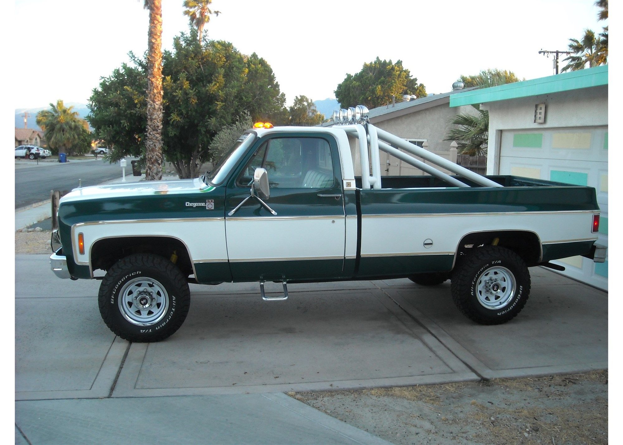

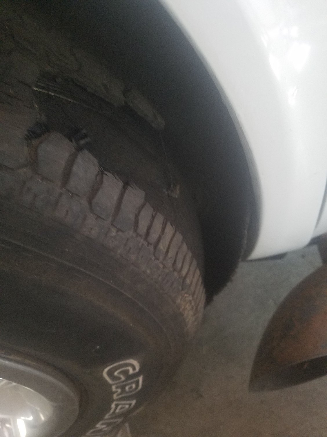

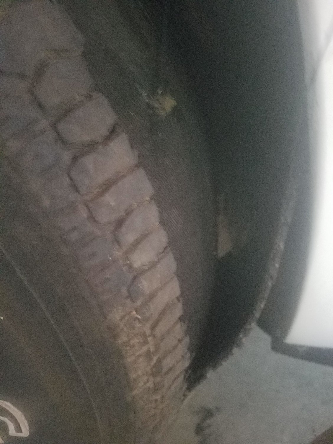

Brother they will do it without warning. My truck had sat in a garage in L.A. for two years before I bought it from the orig. owner. Super clean, not a dent or scratch on it to speak of and a nice era correct patina which I'd planned to keep. Played it safe and had it towed it home to Palm Springs. Ordered new tires and they came in a couple days later. Tire shop was less than two miles from my house so I decided to drive it over. A mile down the road at 35 MPH the left rear let go violently. All the damage you see on this panel was caused by that tire coming apart, tore off both of the lower body moldings, wheel opening trim, dented the fender fore and aft, bent the tail pipe even scrubbed big black marks in front of the gas cap. A real F'n mess at low speed.
My paint guy couldn't match the patina fade so I said screw it, changed the game entirely and had him paint the whole truck. All good now but them used rubbers gonna let you down every time!

Not that unusual for old tires. Be thankful you weren't driving at the time. I had much the same thing happen this summer to 35-40 year old tires that had been on a car that has been undriven since '94ish. They just lose their integrity through the rubber compound's degradation.

If you just need rollers throw a tube in it and keep rolling.

Same story here. My perfect 9 year old tires with NO WEAR came apart on my way home.
Looks are deceiving with tires more than 7 years old.
I never would have thought so.

93. 30 year old tires. all you have to do is roll across the driveway and they can come apart. story about a guy bought an old truck. rolled it on flatbed and off flatbed at his house. he heard 3 tires blow the first night.

Nice truck Greg!

I noticed just about every picture above is either of a lower quality mass market tire (BFG Radial TA/All Terrain, etc) or a no name tire I have never heard of.

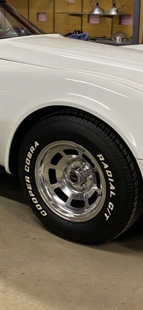

My tires were put on in 2014, they were made in 2013. According to the previous owner they only have just over 1,000 miles on them. They look great but now I am thinking 7-8 years old might be too much to gamble. I have looked at getting new Cooper tires or BF Goodrich, any difference in one better than another?

THink the cooper is better, guys just buy the bfg for the lettering. Had a set of tires go rock hard that had never seen the sun. Dry rot happens no matter how $ the tire is.
