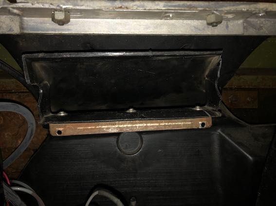

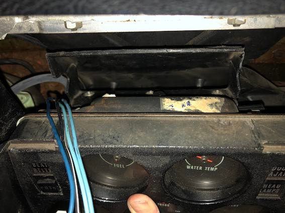

Im installing a new Center-console.
--I must ask this even that I know there's a lot of threads here on this matter.
I've read about the problems to aligning the interior parts. Especially the center.
I've read about the issue with the speedo/tach cable, that can cause the dash to not align.
And I have seen people use force to push things into place.
But I have not read about anyone having the issue that the air ventilation in the top center is in the way.
I can't force the gouges under, and up, the vent.
i'm pretty sure that the dash, or most of it, has been removed before.
Can i measure the distance from top of the window to the dash, and by that understand if the dash as a whole is to low? Do anyone know this measures?

The two nuts above the AC Vent are confusing me. Anyway, I eventually broke one of the top ears on my Pot Metal Gauge Housing trying to get a decent fit. After I purchased a new gauge housing the problem continued. In my case, the black plastic defrost vent is not close enough to the firewall and pushes the AC Vent outward. I was afraid to dig into the HVAC System, so I used a Dremel to cut away some of the plastic vent. I removed a little at a time and kept testing till the wiper bezel fit decently. Just call me Bubba, but 45 year old plastic that has been through Hell, is not very cooperative.
