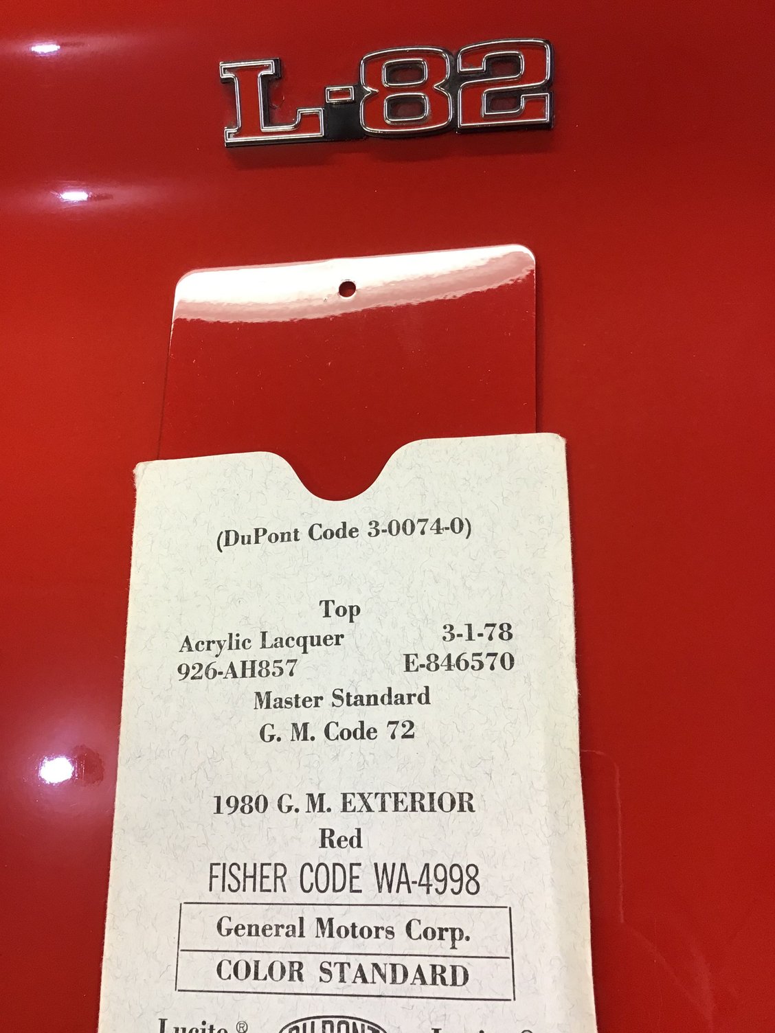

for example my 79 has laquer paint..no clearcoat..my research and speaking with original owner is left front fender was patched and i think they gave the whole car a light coat of laquer to blend...you can do that without sanding with laquer, just with compounding prior.
Last weekend i decided to color sand 2000 grit (wet) and hit with 3m finess it compound and a slowspeed 9 inch foam pad also 3m.

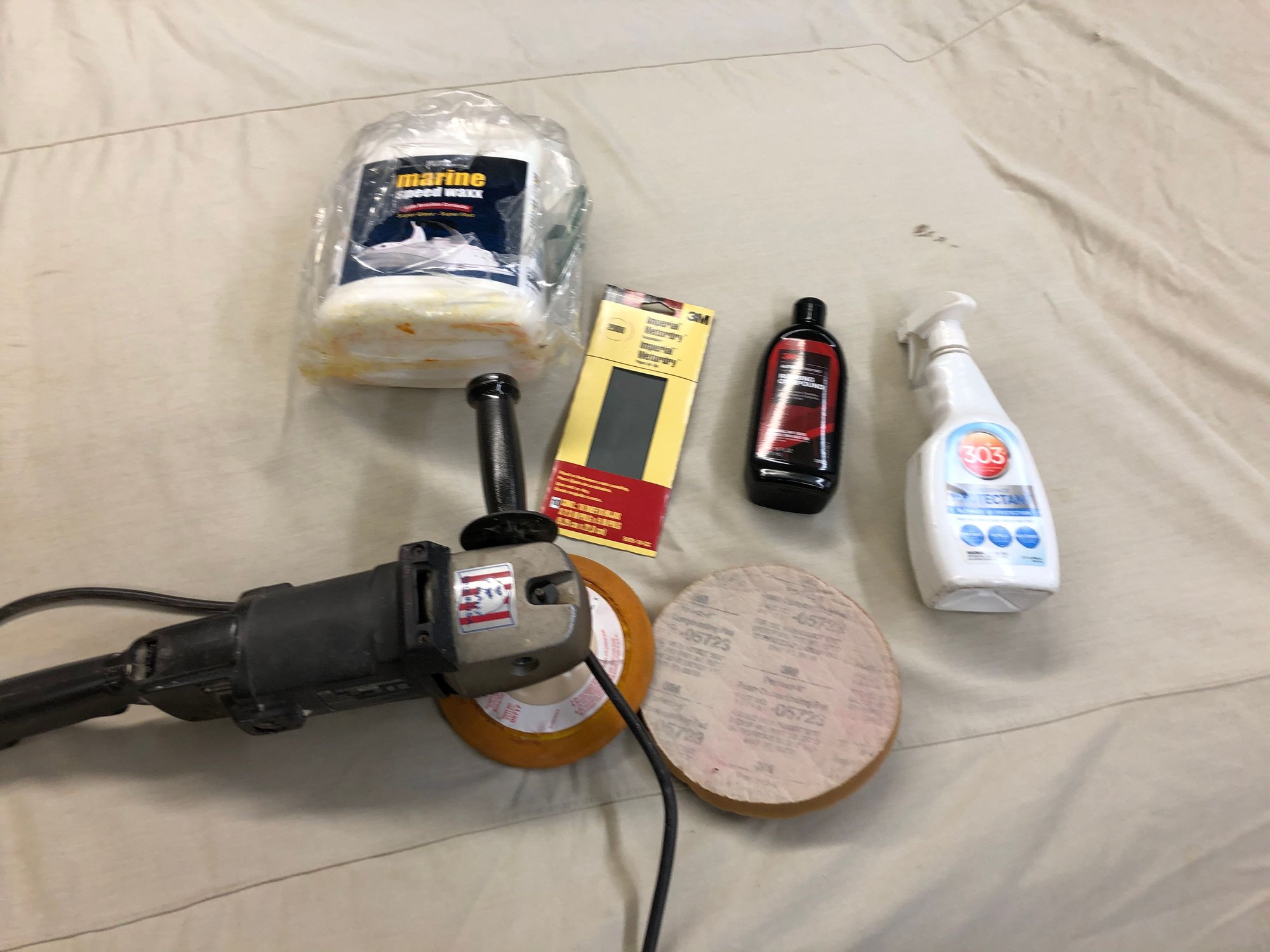

get an old ebay usa made polisher with slow variable speed. You can do it with a dual action but will take time. Those 2 steps are all you need to bring back the distinctness of image by flattening the coating and polishing out the scratches. I finish with flitz spray on waxx...done..you are simply trying to increase the refection and or repair the exposed scratched or oxidized layer...anyone can do it..but your back will feel it
this is my car but the principle is the same on all coatings..
of course you must always be concerned with cut through, rotation of pad near edges..i tape off jambs and edges.. and what you are dealing with and use common sense..
what do you have and what do you want to do?

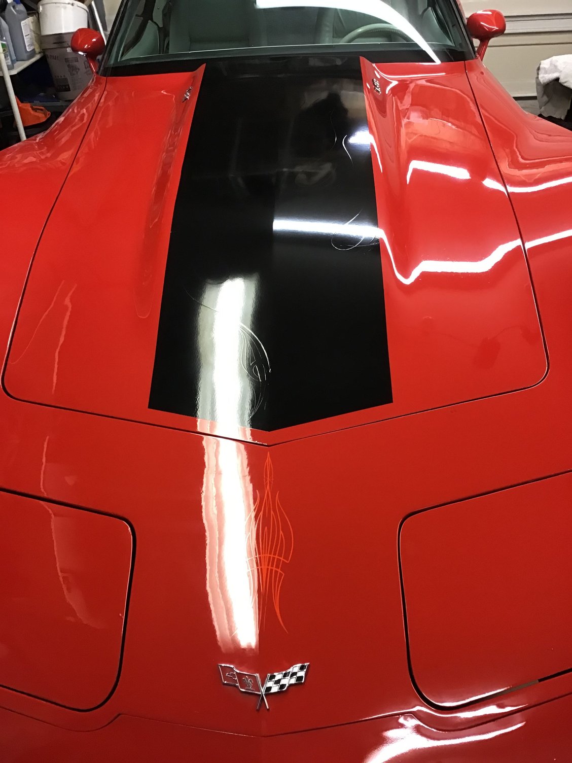

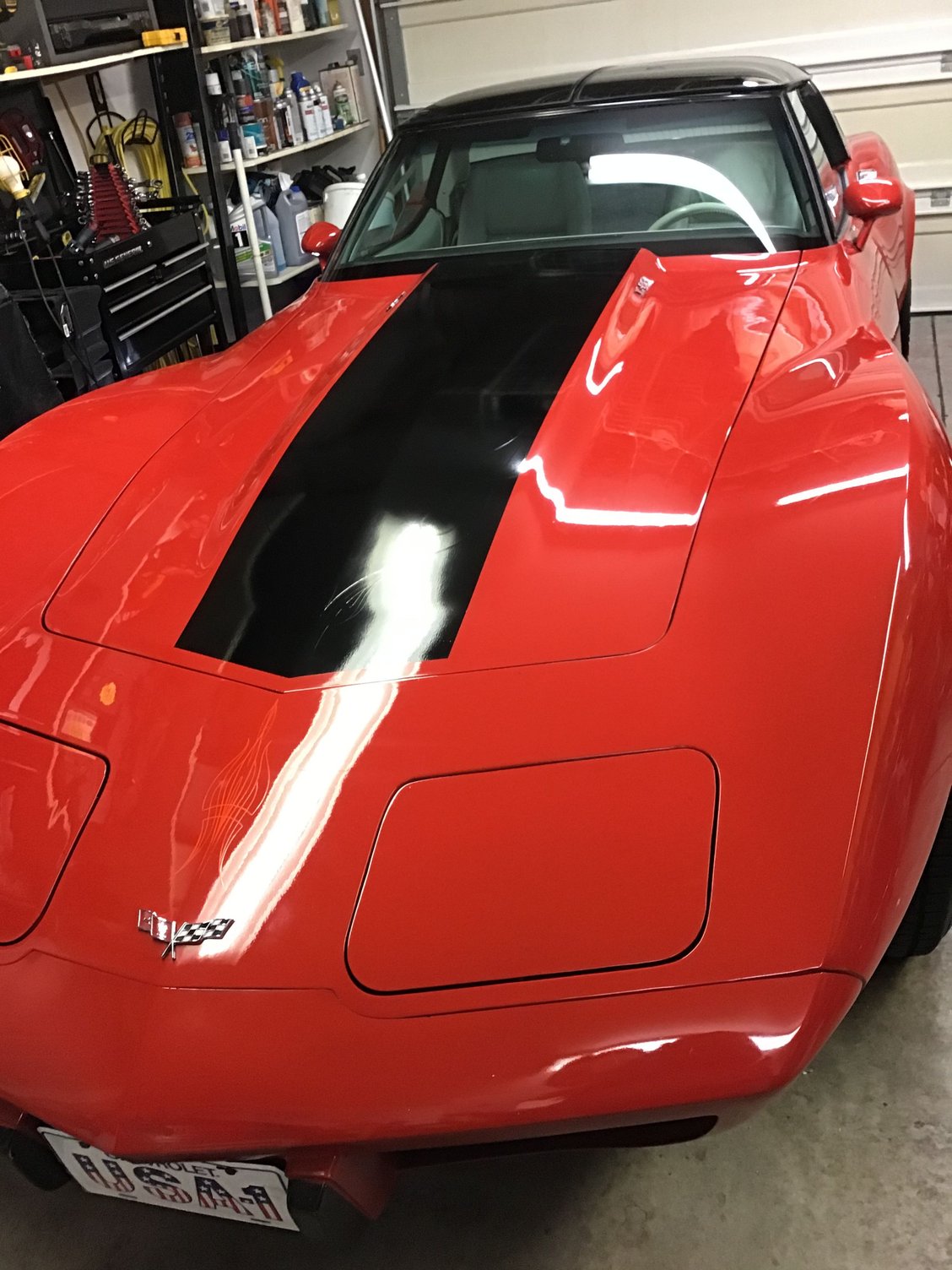

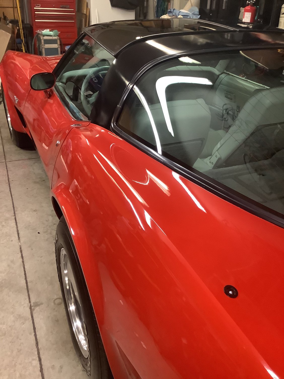

a few pics this week..just did top and top sides..it takes a twenty footer to a 5 footer...you can kinda get an idea of before orange peel under the black vinyl covering some 1980 flames on hood..bumpers original paint...
you can do everything with materials in the one picture..all you need, any car, any correction needed.period. Pic with original color standard is before color sanding, you can kinda see in the bulb reflection scratches and peel.
use the spray on waxx while drying after washing or periodically..when washing just dont scratch it..keep grit off washing mitt or rag...use just water if you like but almost all sudsing safe for clearcoat label will help float and lubricate the surface..but so will lots of water..degreasers like dish soaps tend to remove some petroleum products in some protectants,,
Tried to find a before pic..this is a few weeks after i got it 2019 the headlight doors were especially bad
