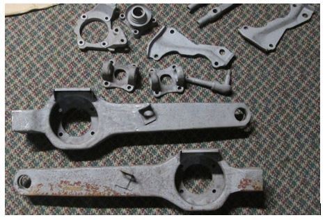

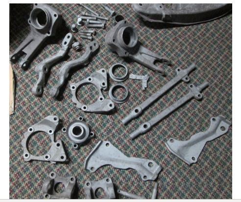

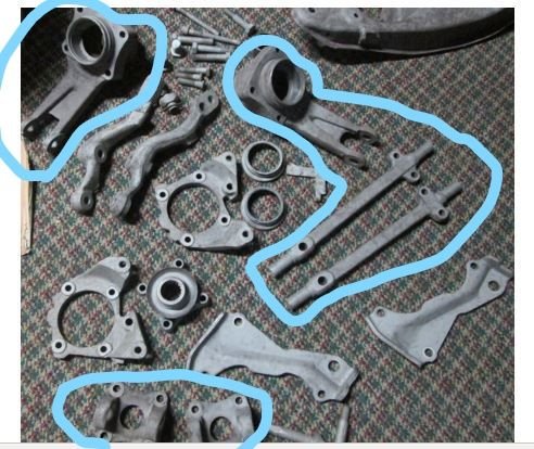

I took apart a rolling chassis some time ago and had these parts media blasted so I could then have them either powder coated or painted. Well they are sitting in my garage and it is time to get them organized and get them finished. I'd like to finish them in the correct color but after so many years I just don't remember what correct color they should be, so I am asking you folks.
The trailing arms are going to be powder coated black, that one is a given. Same is true with the lower control arms (pair) and the single control arm. So those will be gathered up with any other parts I will have powder coated and taken to my local coater in the near future. Honestly not sure about the other parts but if you could give me a clue I can take it from there.
Thank you.

Front caliper brackets should be gold (chromium) iridite plated.
I thought the rear spindle bearing support with natural cast?
I don't have my book with me right now.....
Joe

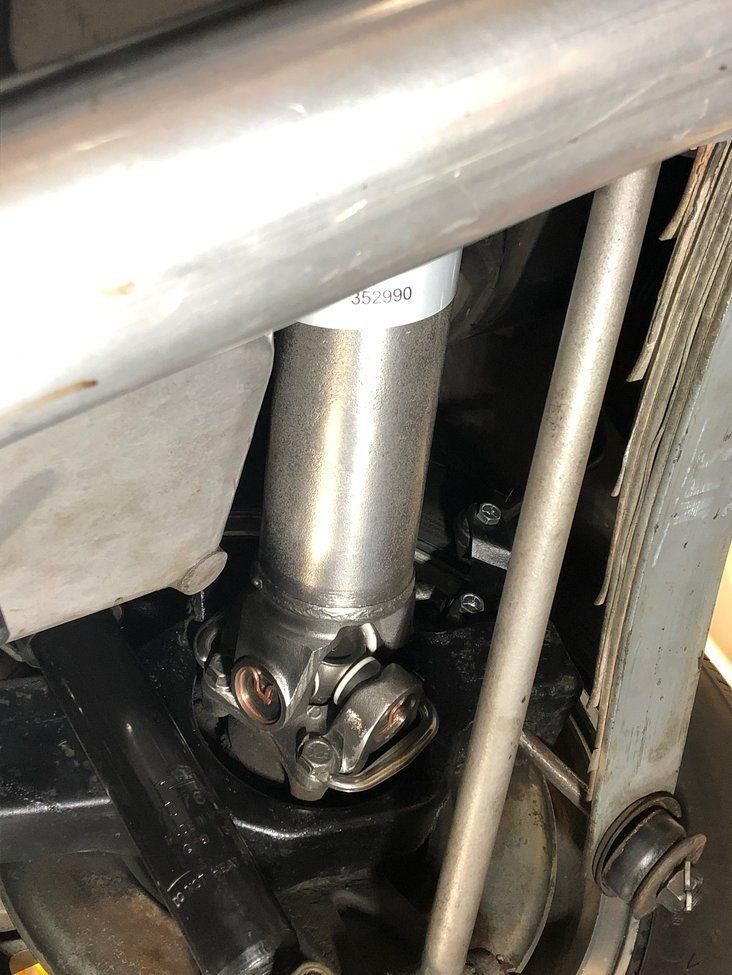

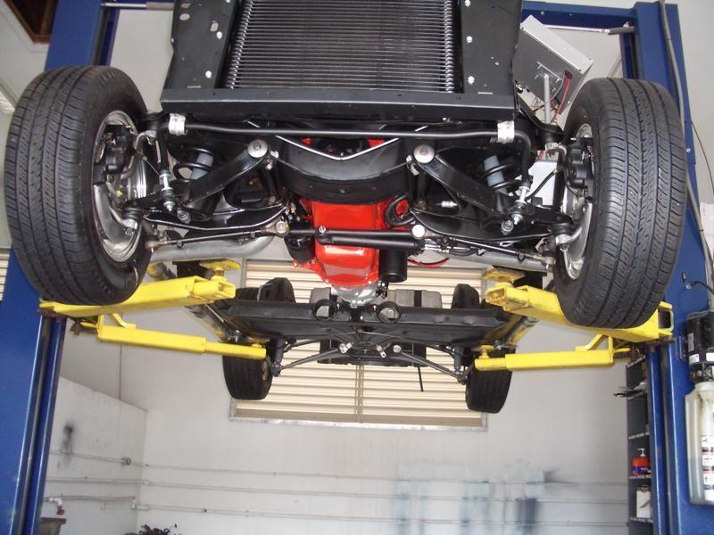

i made mistake of some black on a arm rod.. what i have circled is was not painted on a 79.. i use blast wire wheel then matte semi gloss clear rattle can to maintain look...
i used full gloss clear on drive shaft as it came original smooth shiny bare
79
79
79 not mine

Since you're not worried about NCRS correct than cast blast for cast items that are not getting power coated and silver or stainless steel (Lowes rattle can) for the hard steel items.

OUTSTANDING! I LOVE CHASSIS ****! BEAUTIFUL!

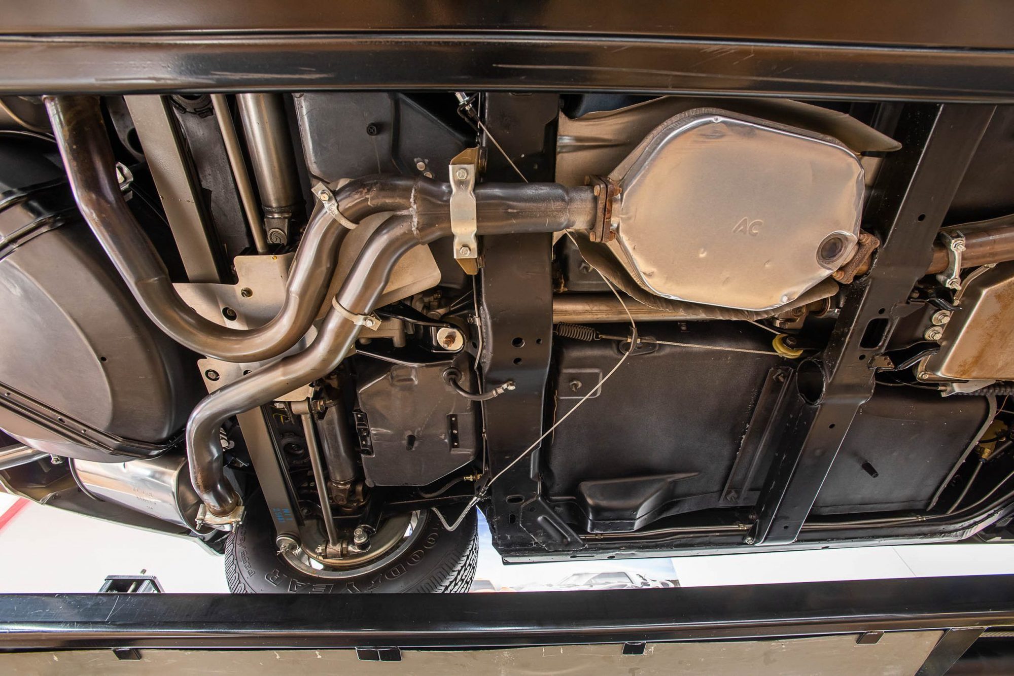

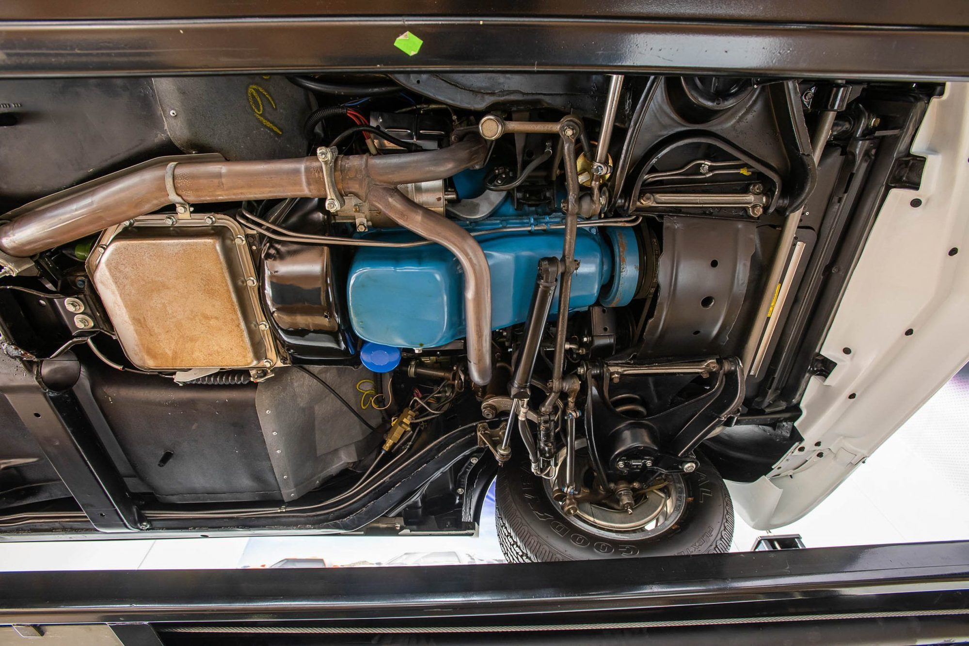

You can also take a look at this original 600 mile Pace car listed for sale right now here on the forum. Has some very good/clear suspension pics posted.
https://www.corvetteforum.com/forums...626-miles.html
