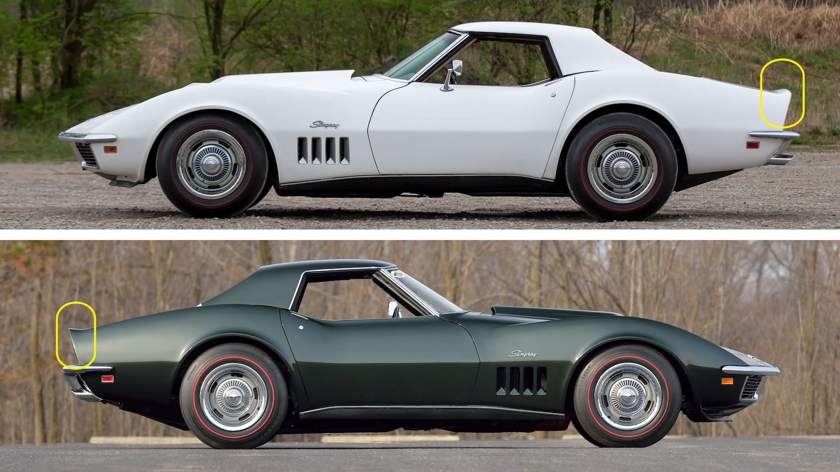

The previous owner for some reason decided to shave the rear lip where it raises up at the trunk. It is pretty much flat now.
Attached photos to show the area of concern.
Any ideas on how to get the original look back? Custom fiberglass work? Aftermarket spoiler?

I would make a mold from an undisturbed car, then layup a replacement section in the mold, then splice it into the rear. Not much more work than replacing a quarter panel. Another option would be to find a true “donor” rear section and cut it out and splice in.

It could just be that of the 2 photos the camera is located higher on the white car. Giving the illusion that the up flare is taller then the other.
