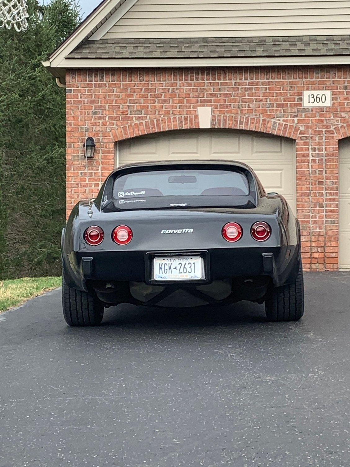

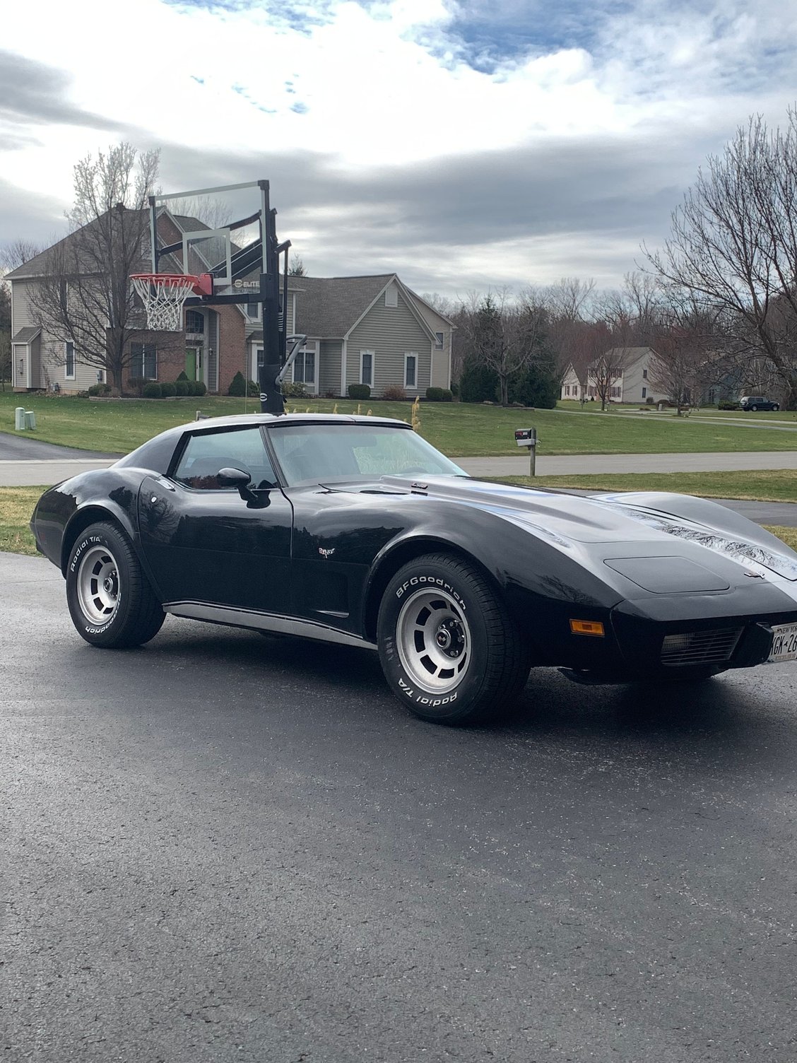

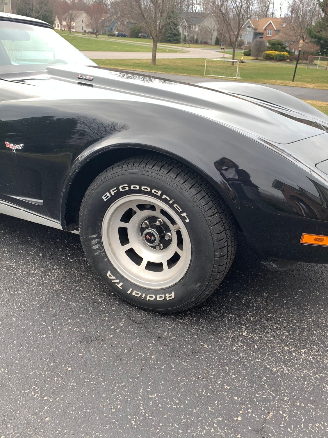

Bought the 255s from Bf goodrich and couldnt be happier, they look way better and give it a more sports car look from behind. No rubbing or anything either.

Nice looking 77 you've got there, and I do like the 255's on it.

I have 255 60 BFGs all around on my 77, look great, no rubbing
