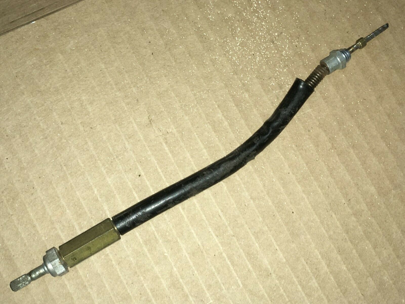

Found one of the cables on Ebay but I think it is for the trip reset cable (you don't need?). Looks close but I have no idea.
69 Camaro had a speed minder option and the repro cable is available for about $30. Classic Industries has a picture I can't copy and post. . Might be worth a look there.
Ebay item below

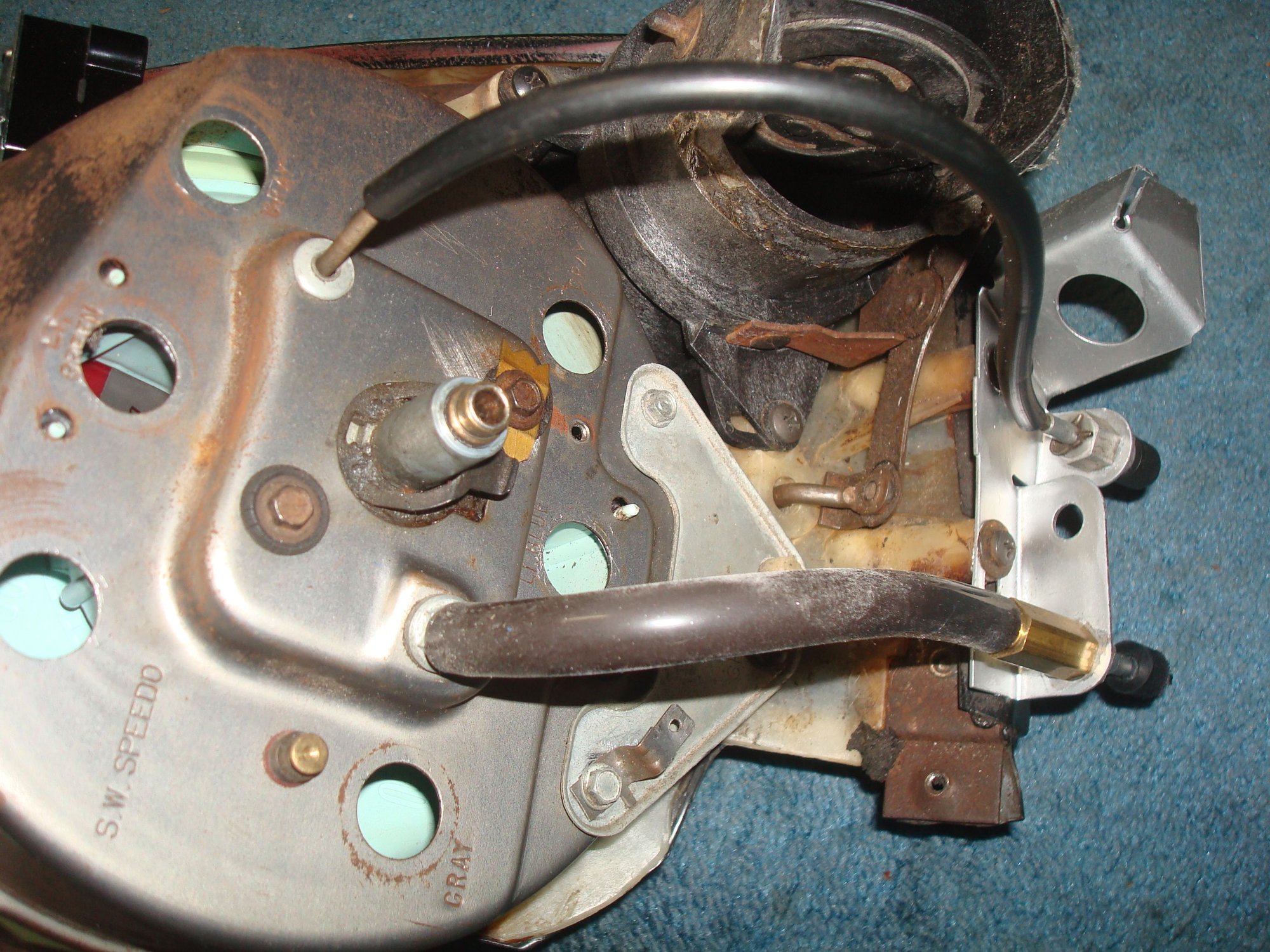

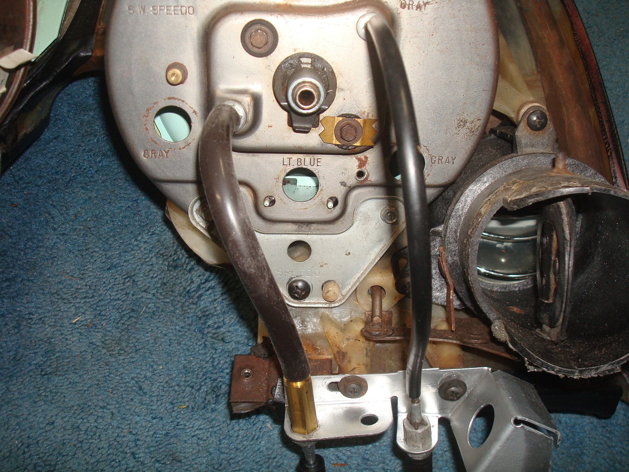

I also have a 69 with speed warning . Here are some pics of what the cable looks like when installed . Cable on the right is for speed warning . Maybe this will help you to come up with an idea on how to make one up , if you cant find one .
Steven
The black sleeve , on cable , slides up and down and not attached at either end .
