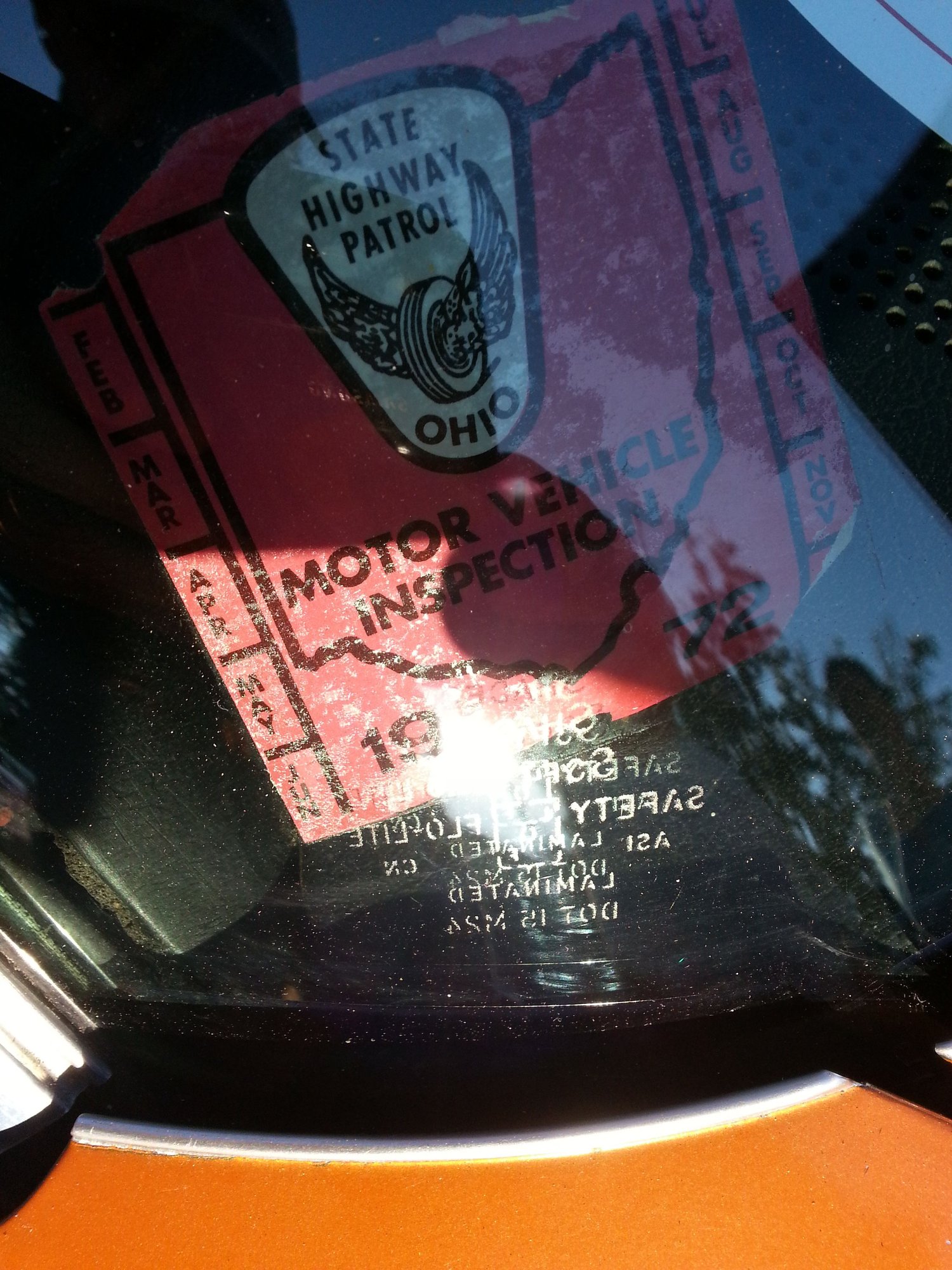

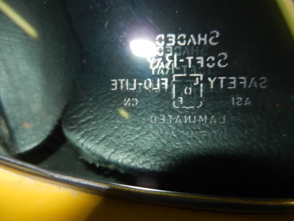

I believe the WS label and date codes are readable from inside the car. Door glass labels and dates are read from the outside of the car. Here are a couple of pics of front windshields. On both of these windshields you can see a reflection of the label, ignore that. They are read from the inside. The orange car is a bowtie car I believe.

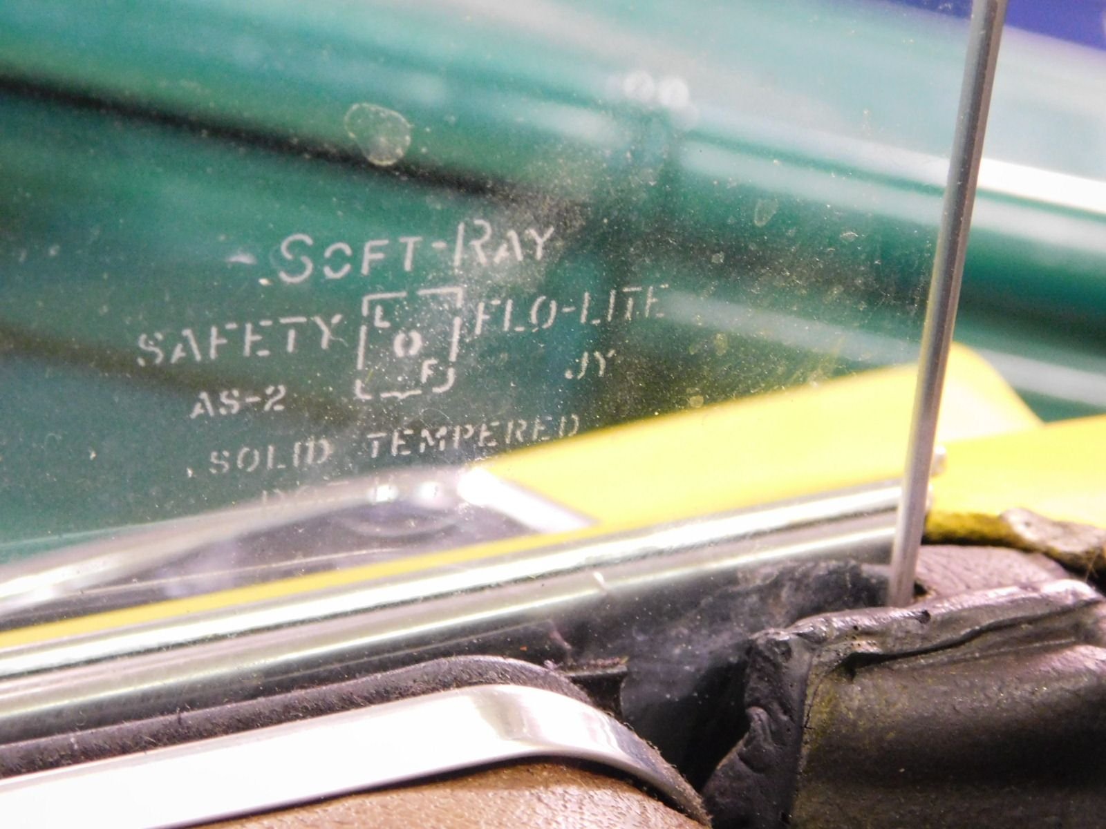

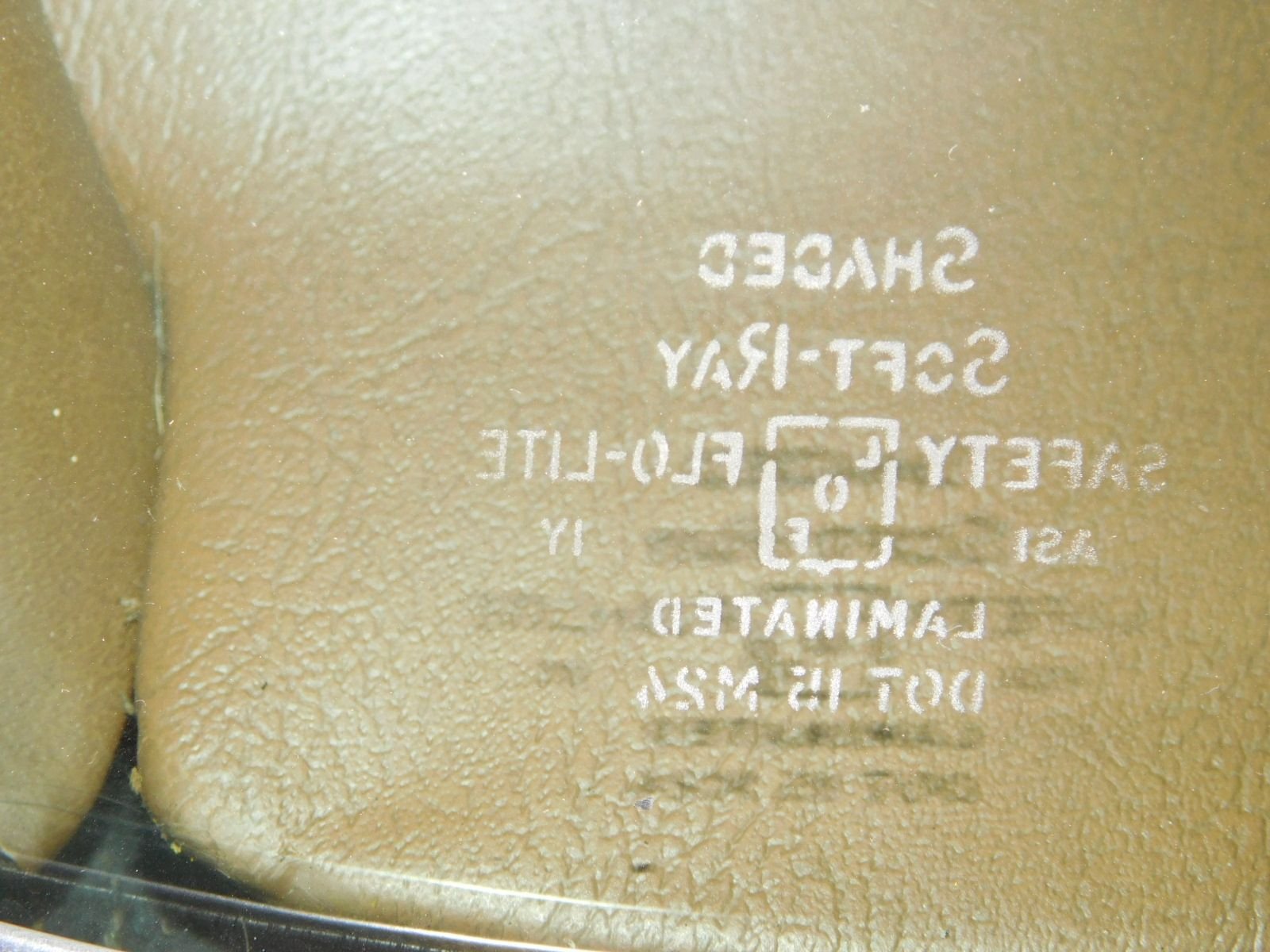

jhudec is correct. The pictures he shows from the outside are "mirror images". If you are interested the convertible top date is read from the outside.
Here pictures of my original '72 with IY = June, 72 windshield, JY = May, 72 side glass and 725 = May 72 top window.
