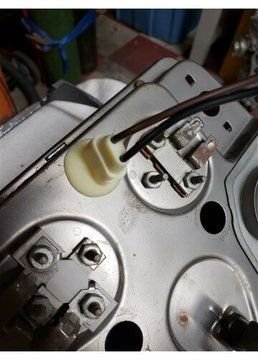

One thing I would look at when taking apart your dash...if its the first time...it probably won't be the last- just sayin.
I'd look at what fellow member "Greg" did - works on pre 77 years.. A great idea as the ground connection isn't left to a spring loaded connector where the surface can corrode.
Easy Dash Bulb Socket Upgrade
https://www.corvetteforum.com/forums...t-upgrade.html
