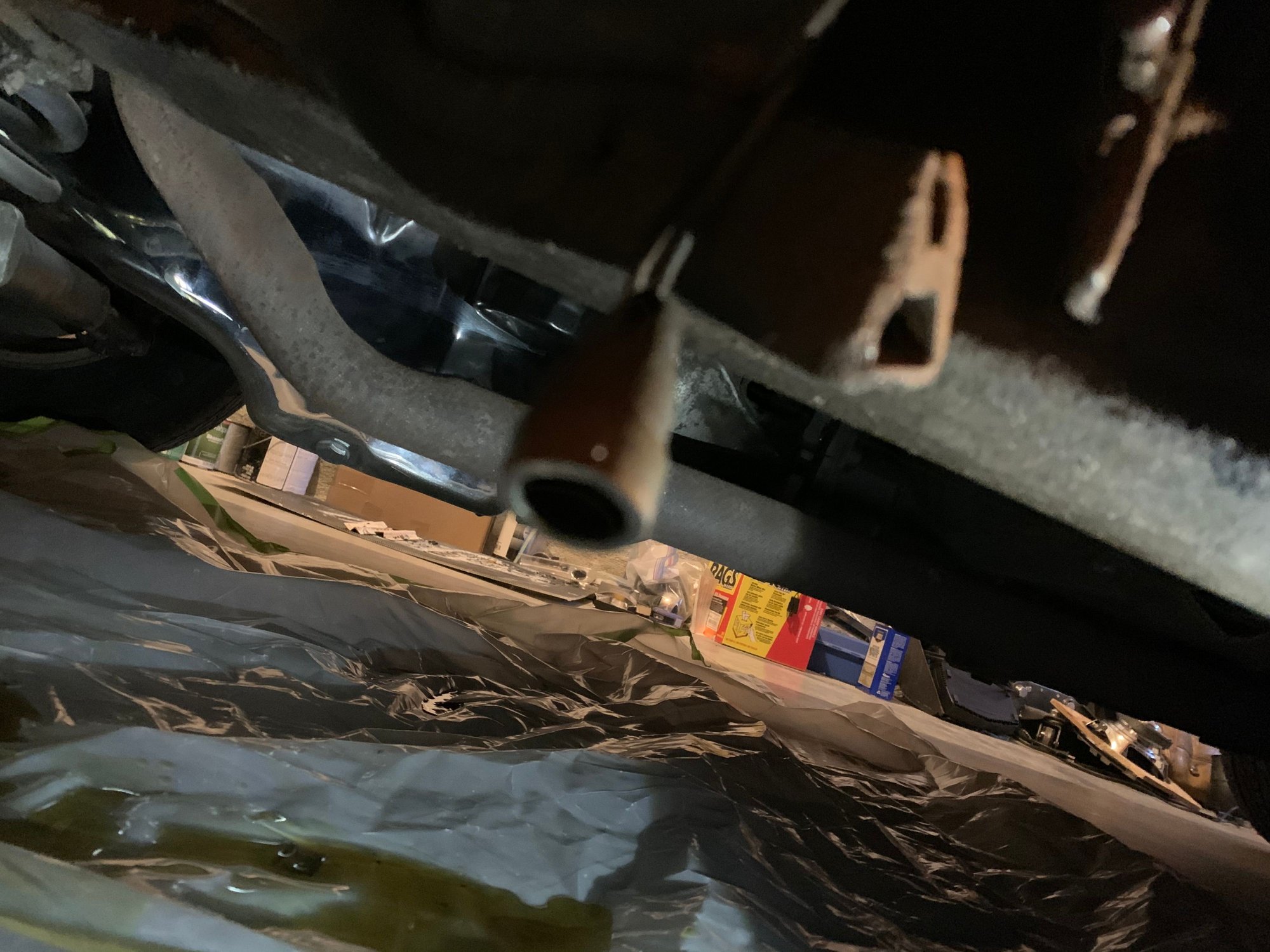

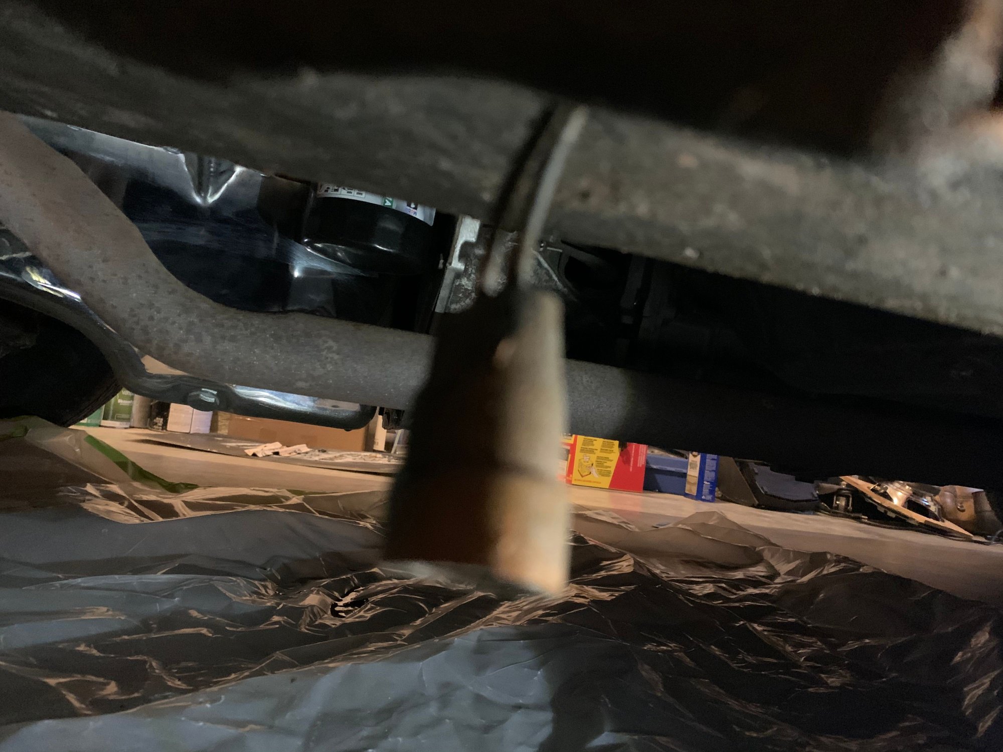

Hello,
I a somewhat new to site and I have learned a lot from people on forum. I am tackling the wiring and I must say its like a bowl of spaghetti. I am not to good with wiring diagrahms, but i have made some progress with some of the issues. I noticed this plug hanging under the drivers side door. Does anyone know what it is ? I am also trying to figure seat belt system. I would like for it to be working correctly. Where does the seat connector lines come from? Front or back? I have all original seats and belts and both have connectors. where does the harness for the saet belt system come from?

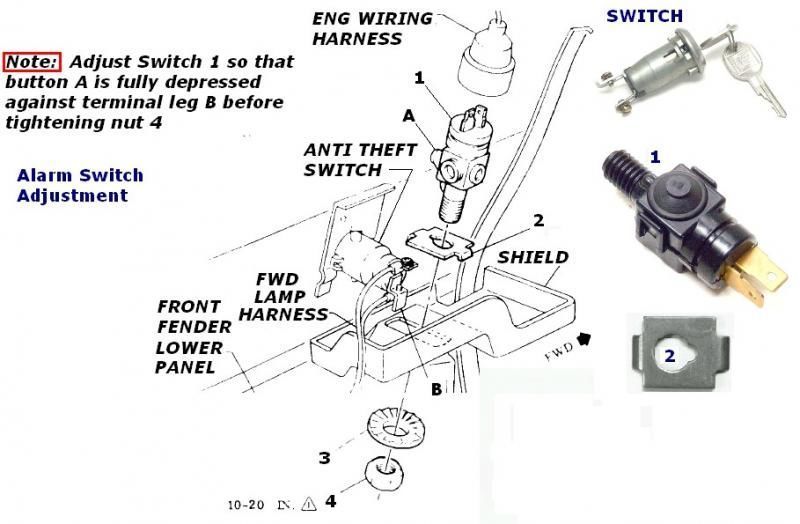

It connects to the alarm switch,
