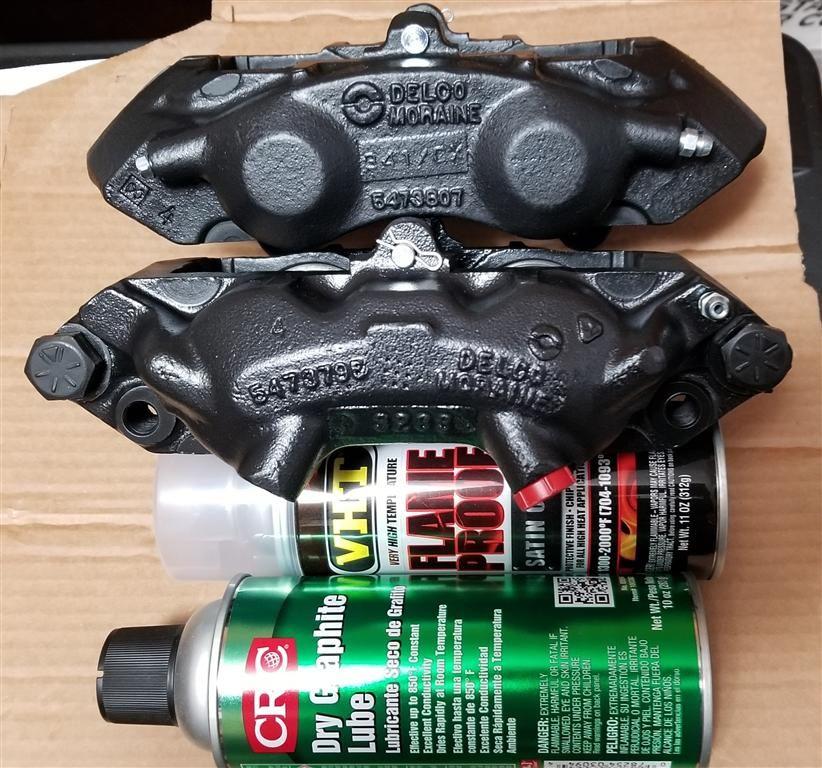

After a tear down and solvent washing then a 24hr soak in Evapo-Rust (thanks Interpon!) and rewash and dry I used the Dry Graphite Lube and a light mist of VHT Satin Clear.
The Graphite is dark gun metal grey in color and the satin clear just darkens it a little with a slight sheen. The CRC flashes off real fast so no drying time other then a few seconds.
The mist of clear I let sit 24 hours
The CRC brand is good for 850* all day long.
A spare set I did ready for rebuild, Not flashy but I like the look..
You are limited to only 1 color choice,
Example of color RF & RR
Grade 8 bolts not clear coated so you can see the color change after the satin clear was applied.

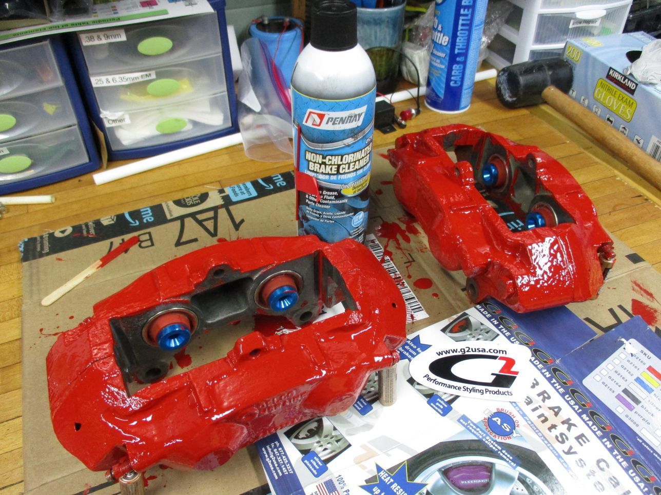

Black? It's your car! Red is a no brainer for my white on red 80.
I used the G2 epoxy when I rebuilt mine. Looks fine so far, but can still be damaged by brake fluid.

G2 has black epoxy. It's hard to see in the photos I posted, but the orange peel during application went away, leaving a deep, smooth red when installed. I used a large wire wheel to take all of the rust off of the calipers first.
I don't have an opinion on the others, except that I would never paint anything with POR-15 that I thought I might have to touch again.
