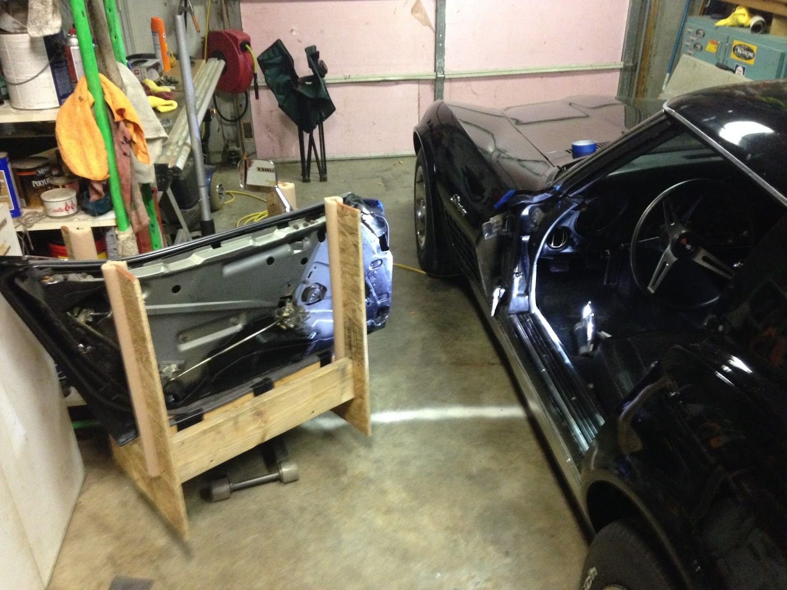

Is there enough movement up to make the doors align...If so I would start with new pins and bushings. That job isn't that hard just tedious and it really takes 2 people....That said I built a door bracket and did mine by myself. See photo below I took during that process.

I'm with WEE, most likely hinge pins/bushings. This is a relatively easy DIY fix, toughest part is controlling the weight of the doors. I made a door holding fixture very similar to his to use on the floor jack. I got the pin/bushing set at Advance Auto, although the pins were a mile longer than the originals. I could have cut the new pins down but, after measuring the diameters of the old ones I found they were within .001" through the whole length so I just cleaned them up and reused them. So, really, I just changed the bushings.
Working slowly and carefully, cleaning and lubing everything as I went, took me about 4 hours for each side and the doors fit great afterwards. I should point out that I left the hinges on the car, used some light colored spray paint inside the doors to mark where the hinge bolts started out so I could put them back in the same place. I slid the doors off the hinge and popped out the pins on the car. That prevents having to get at the body side of the hinge, which is difficult to access. It might sound a little intimidating but it's not particularly technical. Best of luck
