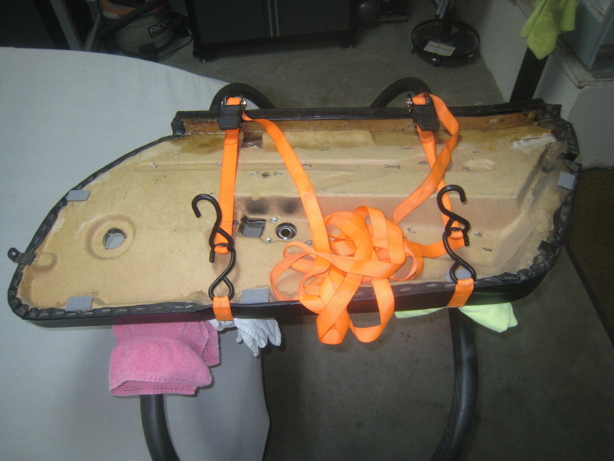

Also, if left off the car for a long time they can warp (potato chip) and become a REAL PITA to work with. The ones on my '69 were removed in 1983 and were damn near impossible to install in 2019 (36 years later) without some form of "persuasion" to "unwarp" them. Even a couple of ratchet straps with some light application of water for a few days didn't help that much.
