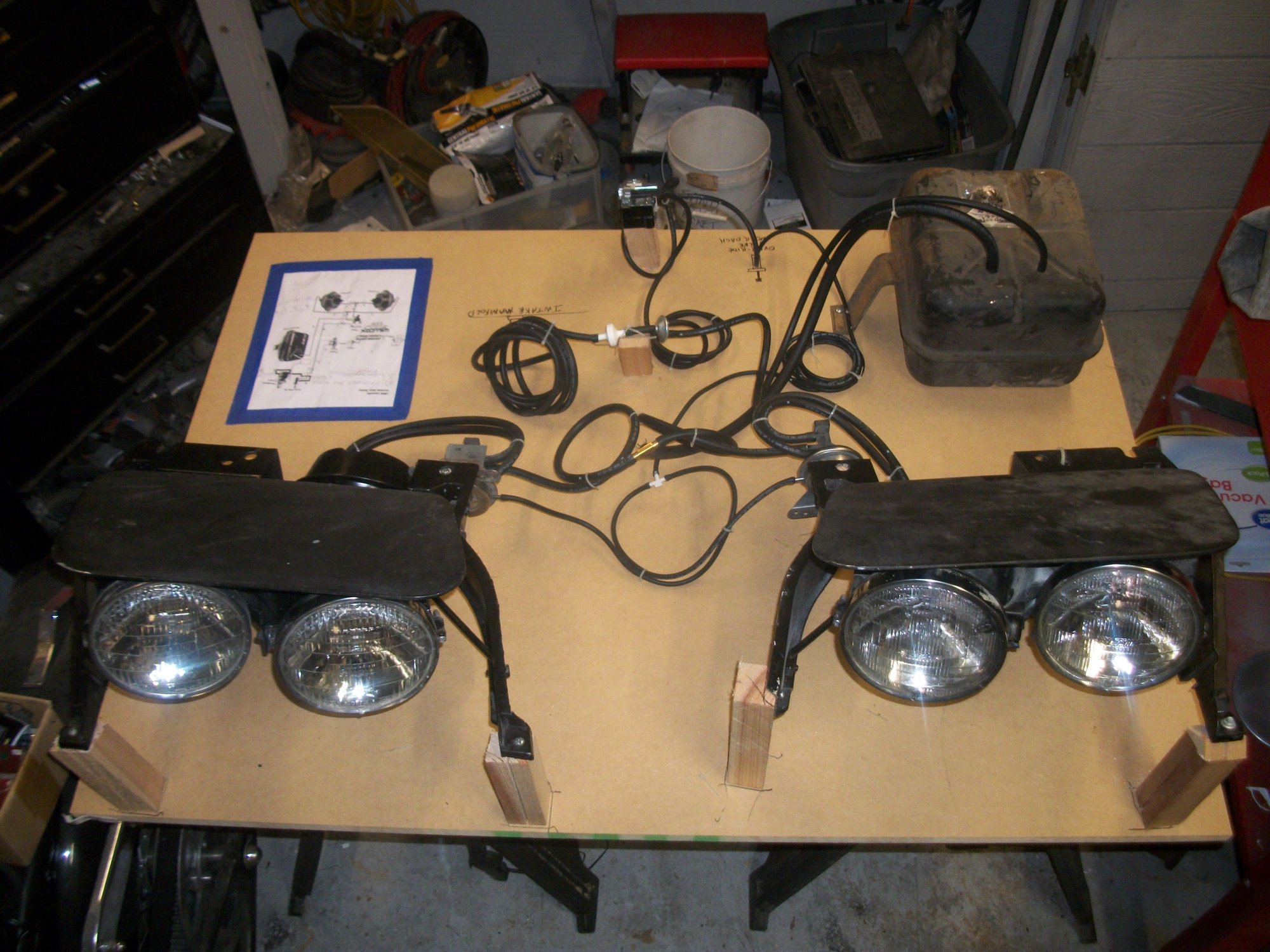

Do you mean these................................... ........
I made a test stand to work out the bugs before I paint and reinstall the system.

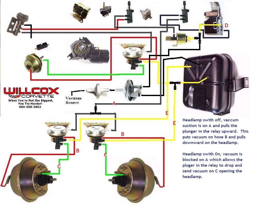

This might be helpful. It is cheaper and more satisfying to fix the oem system in my opinion.

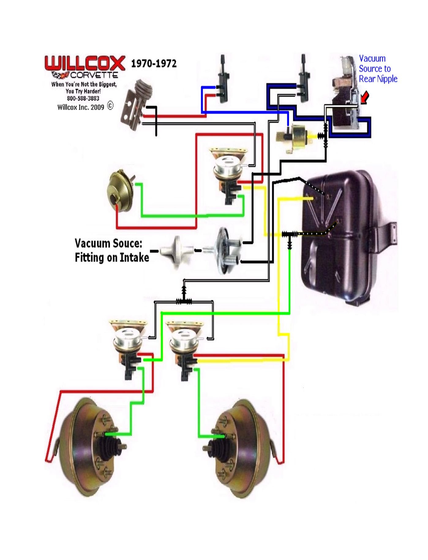

This chart has a bit of a description on it. Then try one of these links
